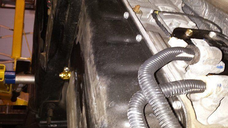

I am curious do you have a pic of what the pan looked like? I will be using the "AMZ/OIL" Universal ATF and do a complete fluid exchange this summer. I should have around 27K on it by then.
Are you inquiring as to the pan design....or just the overall cleanliness of the pan after removal?
Looks like this, You have to raise the transmission to remove the pan.

I was hoping that PML or someone would design a pan with a 30 degree pitch on the output side , Plenty of room so You would NOT have to raise the trans to remove the pan. The Bolts are next to impossible to remove without raising the Trans.
I've lowered my crossmember twice now. It's not that big of an issue (to me) to lower the crossmember for pan removal.
I'll post up a pic of my pan later, Cummins12V98.
I here Ya Greg. If you look closely at the picture you will see the truck is on a vehicle lift, I have swivel lift for the trans takes me maybe 5 minutes additional, but many will not have the skill or equipment that we a blessed to have, and many shops will charge additionally for it, I have No problem with $25-35 more but dealers are charging $100s more for Aisin trans service. You should drop the pan on the 1st service to remove the fuzz dust and filter. after that regular change intervals should do the trick for most anyone asking.
