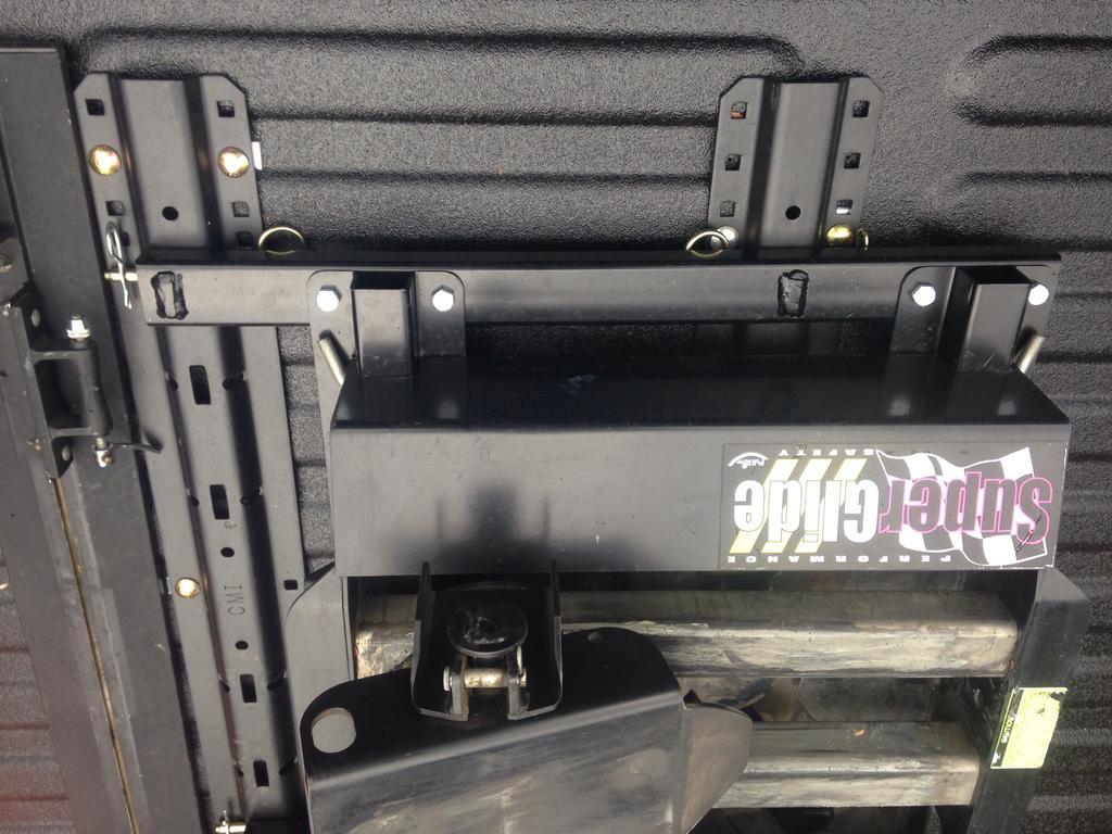

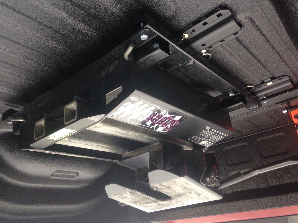

Hey T Mac,
Here's what I did: it's a Curt rail kit with a pullrite adapter. It looks a little complex, but it works great. Apparently the extra height added by the adapter is required due to the depth of the new truck beds compared to the old.
Sorry for upside down. iPhone!
Greg
