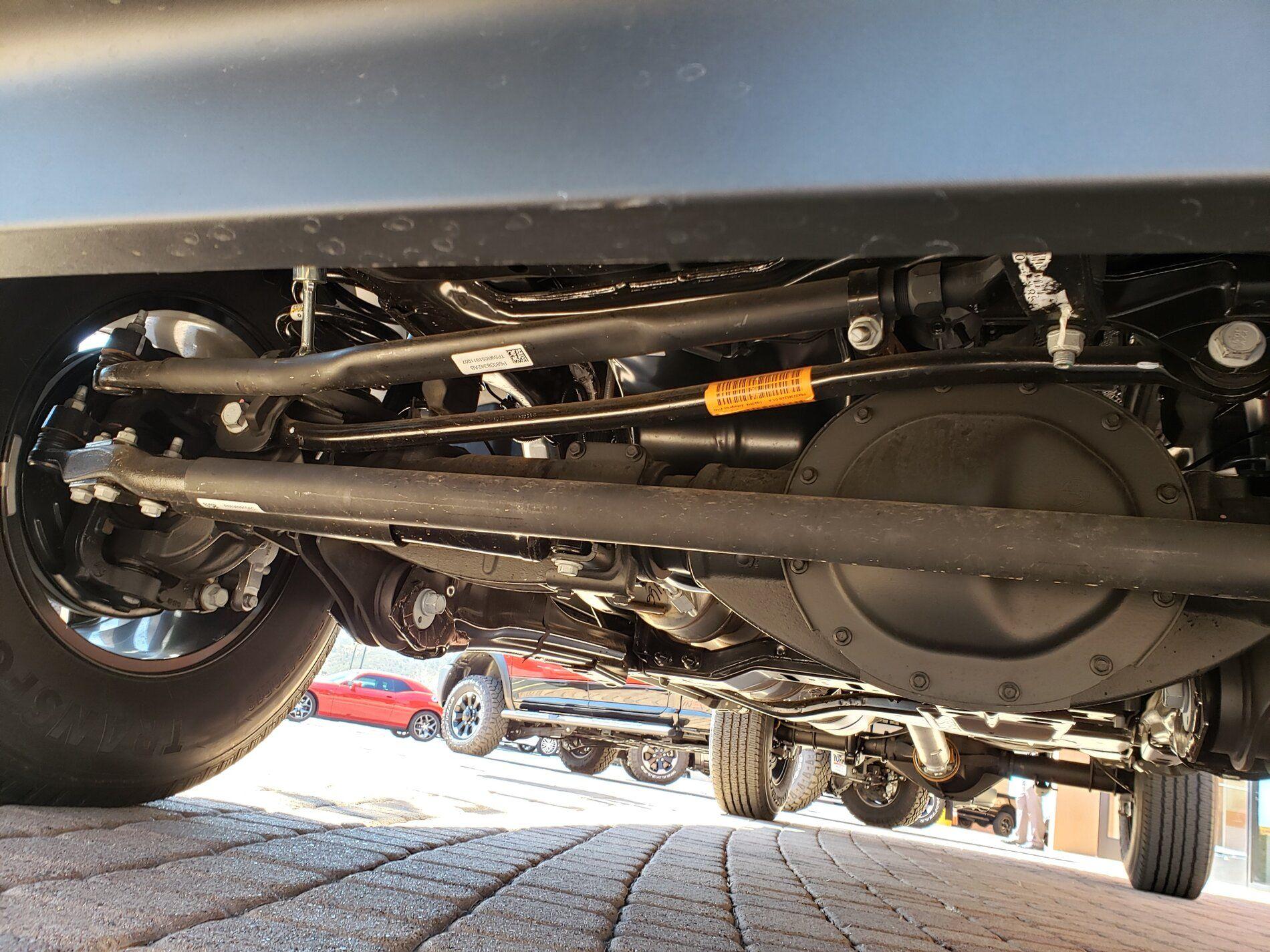

Any one happen to notice the pic of the "New" drag link and adjustment sleeve? The New sleeve is a split design much like we had on the older 5 link front end design. Split sleeve with locking clamps. No more Jamb nuts. My take is that there is too much flex to keep the jamb nuts locked in place that's why they want them wielded if the threads and sleeve are found to be in good shape.

Here is a photo of a 2019 3500 SRW. Hope it's clear enough.
