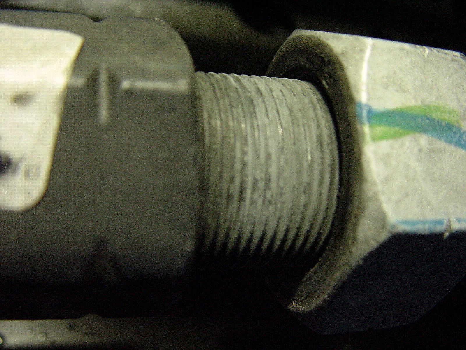

No B checks were performed. A checks were OK and they Skipped B (per procedure). They apparently skipped weld step C3 (check to see if the torquing affected steering wheel center) , see photo. It looks like the steering wheel is about 15 degrees to the left of center when the truck is straight.
.......(snip)...........
John, If they did A and NOT B, then from how I'm reading it, the wheel was not centered BEFORE you brought it in since they would not have disassembled anything to change the position of the wheel. Is that correct?
If the wheel WAS centered when you brought it in, then they did more than just check torque values.
Just curious. Either way, it is wrong.

heres a close up of the threads, I had a lot of play while moving the drag link assembly back and forth before the nut was tightened, I tried to take a movie of it, but it didn't come out too good.
I don't have an issue with the "Tac Weld" fix. as long as they checked the parts. Most of us here are too young to remember the first Gen trucks there was No adjustment on the drag link. The wheel ended up where it ended up. Once this link is adjusted there is No reason to adjust it again. Unless you lift the truck. if the steering wheel is off center after an accident some thing is still bent and needs to be addressed by the body shop.

I say that's fine if you can trust them to check the parts . I'm not

Again, welding is a stop gap measure until they can get enough new style drag links to replace them all. SnoKing
Mine was welded up on saturday... They found it to be loose. They also found the track bar mounting bolt was loose... Truck drives much more solidly now!
I think that if it was loose I hope they checked the threads out .. I personally would not trust it .. Just me
Welding is only done when it meets the torque specs in the document. If the thread wear caused a failure of the torque specs, then they contact FCA for a replacement.
How far is it on the edge of stripping out even after the torque test ? …. I don't like testing it with my fully loaded camper and boat in tow
