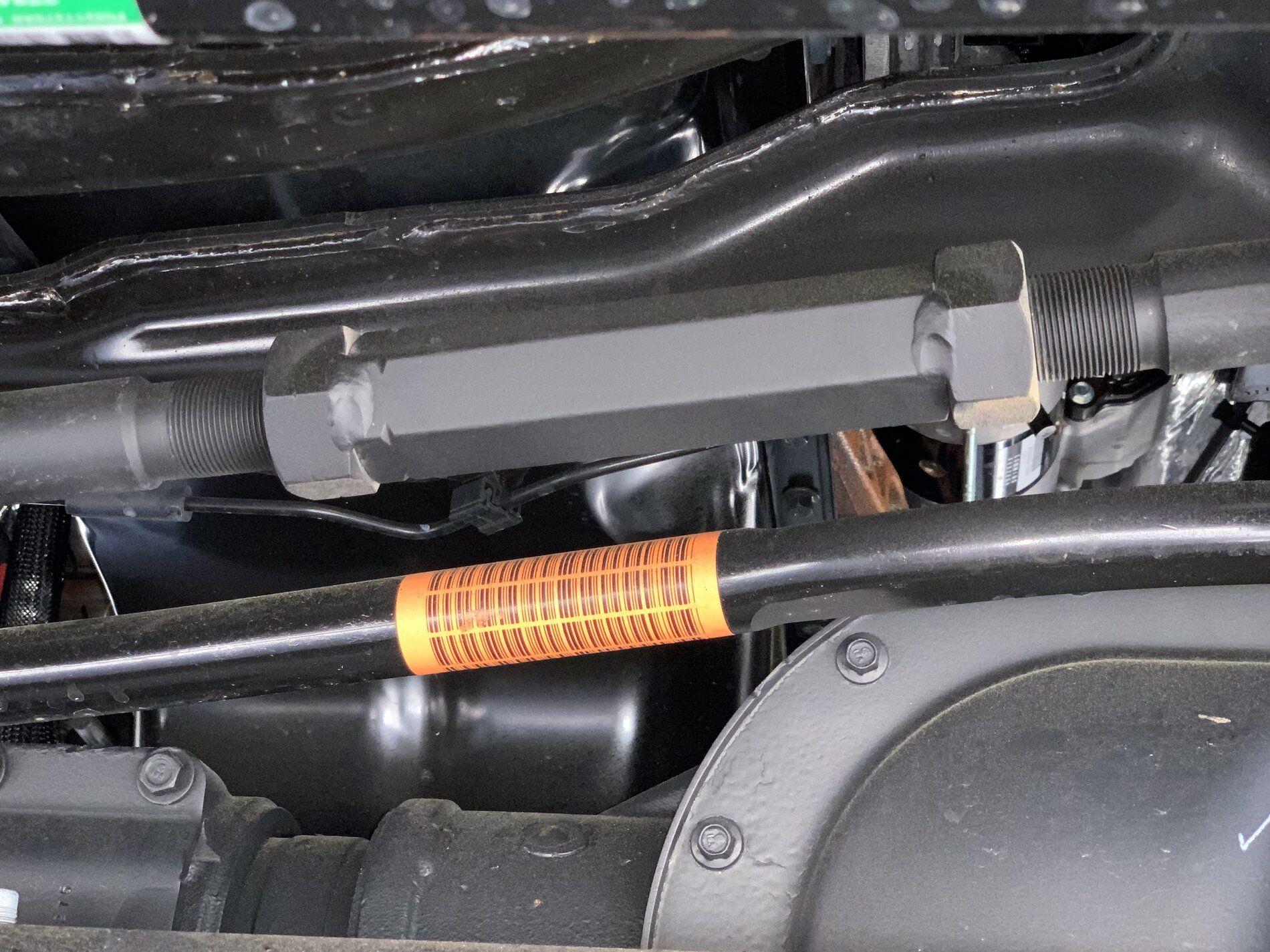

Service Manager is a MORON!the truck is in, the SM said because I tightened the loose drivers side nut they have to call FCA to get an opinion on how to proceed because now it is out of the official recall procedure . I guess I destroyed the evidence! I told them it was unsafe to drive , they said in the future have it towed. More to come![]()
I received the most recent FCA V06 recall notification for my 2016 3500 this past week that says it is now time to bring it in for the drag link inspection and weld job. Like many others, I am really reluctant to agree to a repair that complicates any future alignment work. My question relates to the many comments I read that seem to imply that a replacement drag link will be provided in the future. The FCA documentation that I read says that a replacement is provided only if a drag link fails the inspection, and even then, it does not say that the replacement will be any different than what it there now. My question is; what credible information exists that tells us that these Ram trucks will eventually get redesigned drag links?
It kinda covers your a$$ too doesn't it?
Nothing an angle grinder can handle... Alignment shops are gone hate it. At least they aren't tacking the threads!!
So would applying the proper torque to the lock nuts. Mine hasn’t moved in 120,000 miles.
