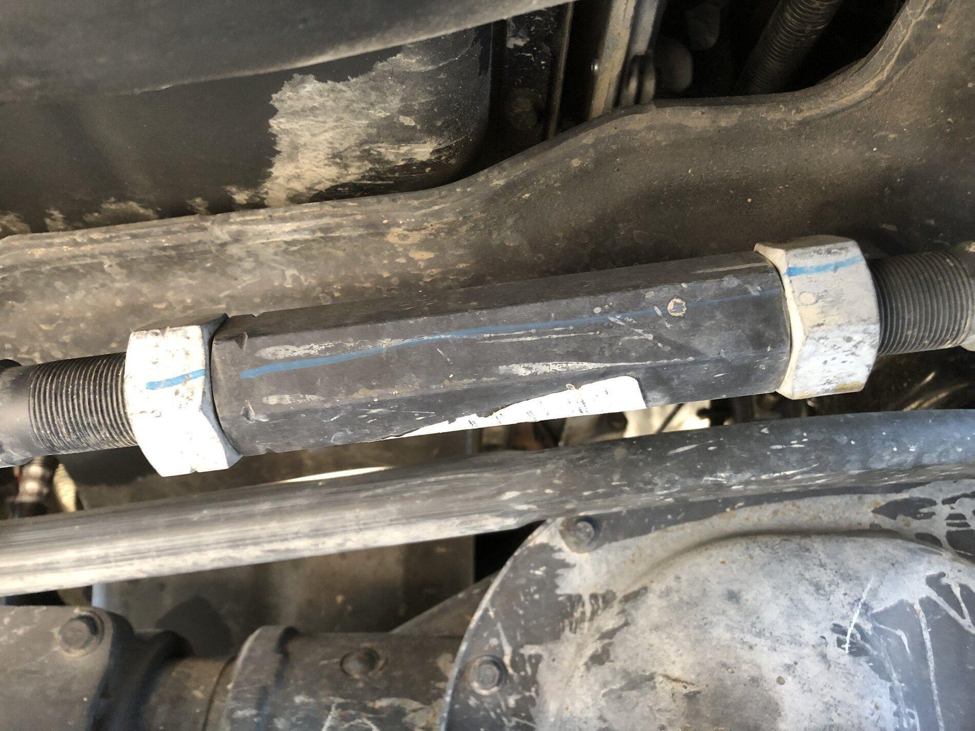

In my particular case, they have moved at least once according to the two colored marks on it...

"In my particular case, they have moved at least once according to the two colored marks on it..."
Have you had it aligned? If so that explains it.
Yea, that's kind of what I figured although I have only had the truck 8 months so not sure the alignment history of it. Either way, my wheel is currently off a bit and it has a slight pull, so it will be getting aligned shortly. I was curious why it has two colors, blue and green though.
Not sure on the two colors, mine has just the one and has been aligned.

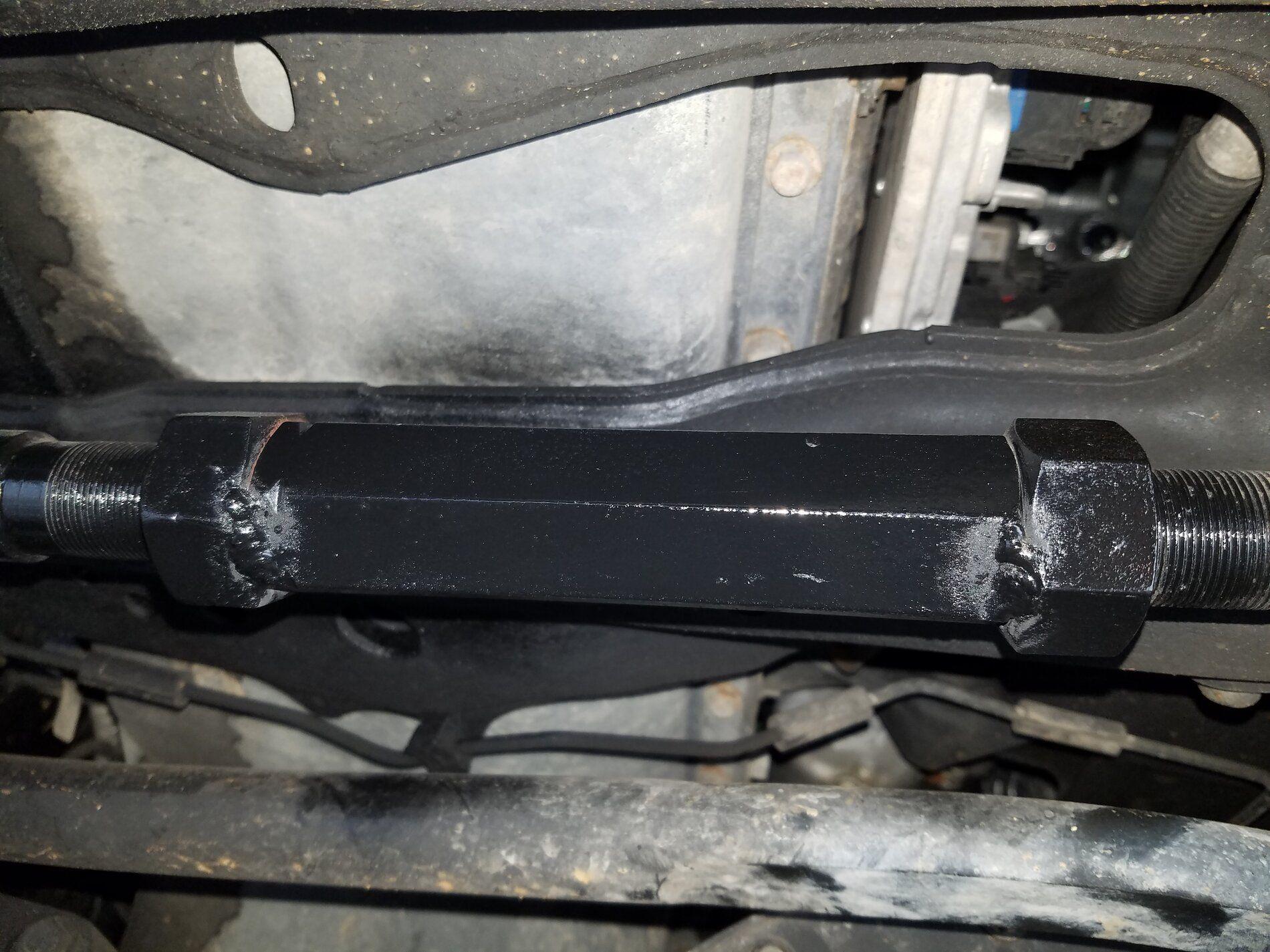

completed....although not loose...torque was low....threads passed measurement procedure...weld completed.
My 2016 has two marks on it and I've had it since new and it has never been aligned, retorqued or been to the dealer for the recall. Not sure why some have two marks while others have one. Mine is still tight and hasn't budged, dealer's a month out on getting me in for this and the tailgate recall.
When they welded the drag link on my truck I asked if this was the final fix, I was told that it was. I asked when front end parts need replaced how would they center the steering wheel after alignment, I was told they would grind the spot weld, adjust the drag link and spot weld again the drag link sleeve and nuts.
The problem with that, is if you go to a tire shop and get new tires and have them align it. Most tire shops I have been around don't have a welder let alone anyone that knows how to use one. Plus even if they did, can't help but wonder if they would charge more to cut and re-weld it. Very few take their vehicles to the dealer for alignments.
I dont have one of these trucks, so I'm not aware of the mechanical issues. However why dosen't the dealer add jam nuts on both sides, that way there not welded and any shop can adjust at a later alignment?
