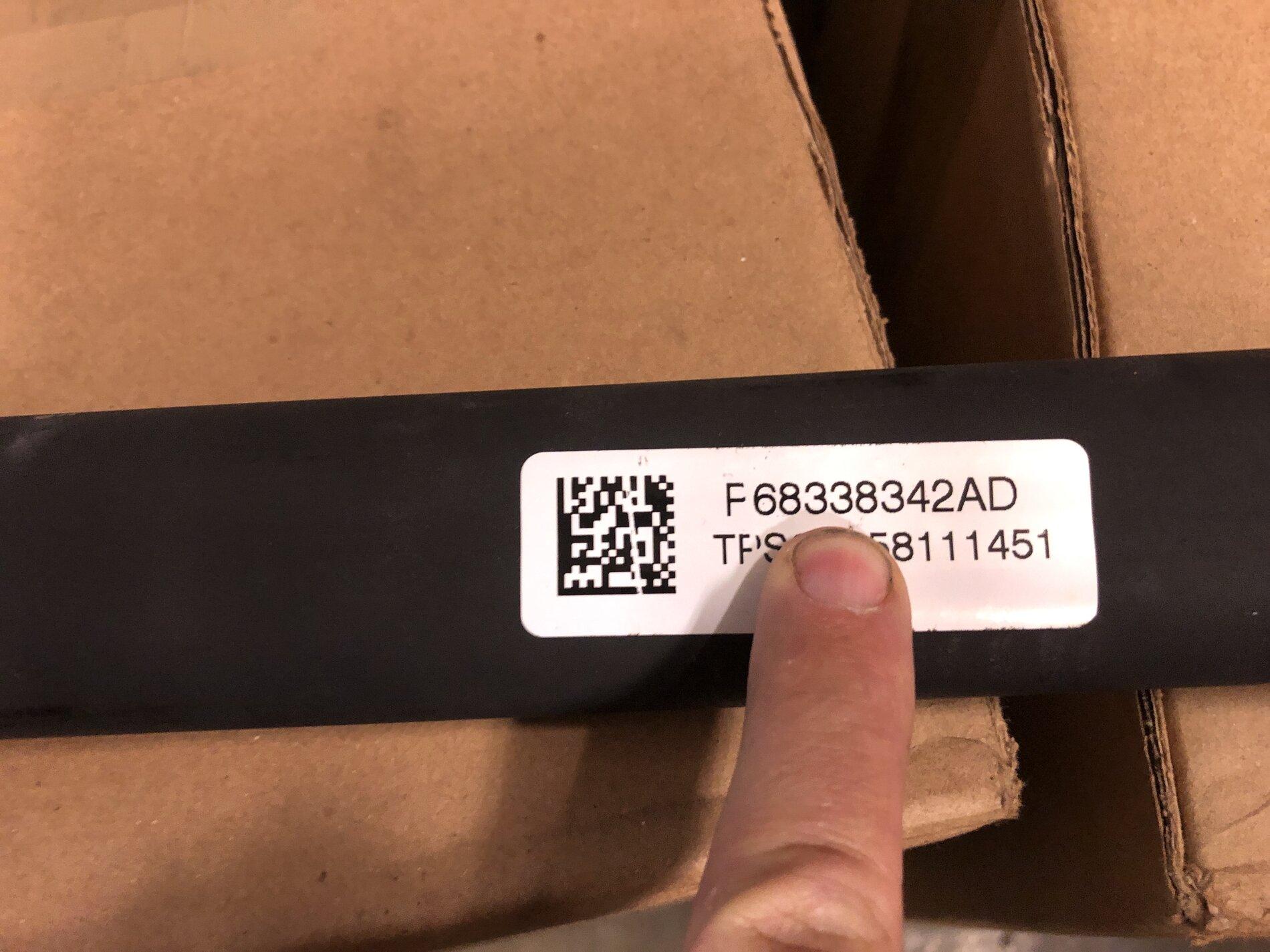

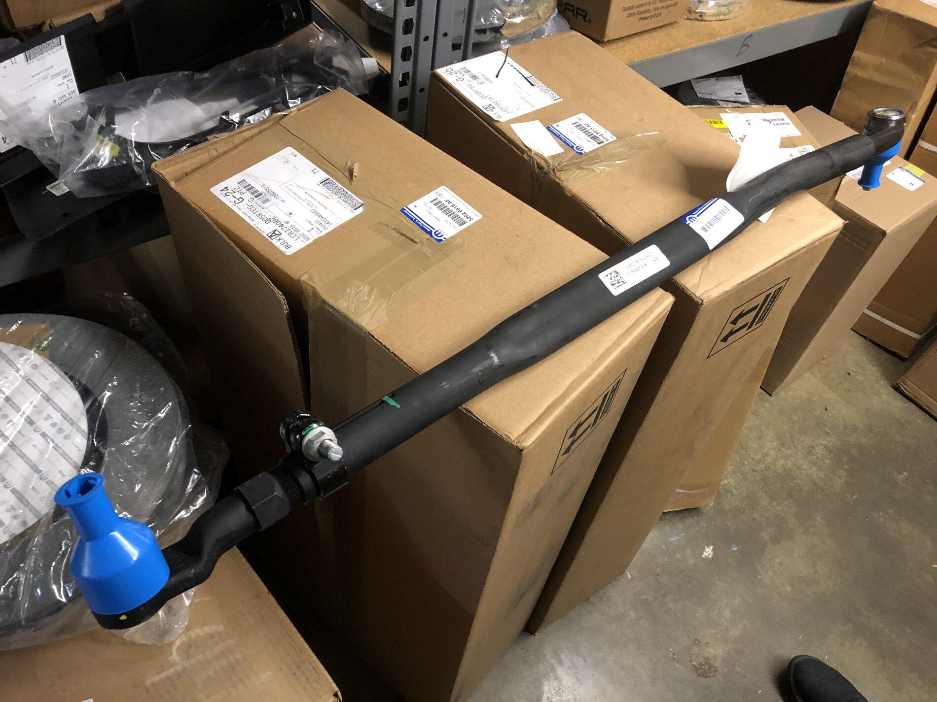

I will update and correct myself here as new information showed up in the mail. I received a W49 Recall Notice due to these "parts" the dealer used during my last alignment.
The W49 Recall tracking is a total failure from Stellantis, formally: Chrysler, FCA. They had no record of this July 2020 letter being sent to me or any open recalls on the 2018 3500 RAM pickup. I called the number in the Owner's Manual and eventually reached a live person. They had me send them the letter and the dealer service record where the recalled parts were used. I also sent them the tire replacement cost and partial "courtesy" warranty Firestone provided. They declined to help with the tire cost.
Finally I have the updated part on my pickup.
Part Number Description
CSZHV061AA DRAG LINK-STEERING
Retail looks to be $118.00. $81.14 online wholesale from MOPAR parts sellers.
I am NOT real pleased about the "What's in Your Wallet" this joke of a recall has caused me in tire cost and ~15,000 miles of radial pull. This has been a problem since the first tire rotation at ~5000 miles until the TrashForce tires were replaced: at the wear bars in under 20K miles. Along the way my selling dealer refused to do an alignment due to the weld so I found another dealer. I spent all day at Discount Tire until we identified one tire causing the pull. The radial pull went away the moment all four tires were replaced. More than one tire causing the pull apparently. The Firestone Transforce "TrashForce" wore so fast that at ~5000 miles Firestone said there wasn't any warranty left for Radial Pull.
I will give RAM credit for ultimately fixing it properly. But goodwill points are lost in the PIA to actually get it done with the boilerplate "we welded it it's fixed". Time from new pickup purchase to get it done made warranty on tires impossible. The Dealer's hands are tied by Stellantis so you have to go through Stellantis to get it approved: THE DEALER CAN NOT DO IT, PERIOD. Only when Stellantis/RAM gives them the "OK" and ships the dealer the part can the dealer do this for you.
Further goodwill is lost from FCA/RAM using the old parts the first time I made them align the pickup instead of the updated part. New old recalled parts that triggered the W49 in the first place.
This is one of three notable problems I have had with the 2018 RAM. Random not starting till I remove key try again with same key and the unrefined "Where is 1st gear" Aisin shifting (Software updates have improved but not solved it.) have been the other two.

I tried to buy that part number, however that is the internal "recall" one for dealers only to install. I had to order a different part number and the price on that one doubled right after I got mine. Look back in the thread. I installed my own RAM one and FCA paid we for the parts, but not the shipping.
