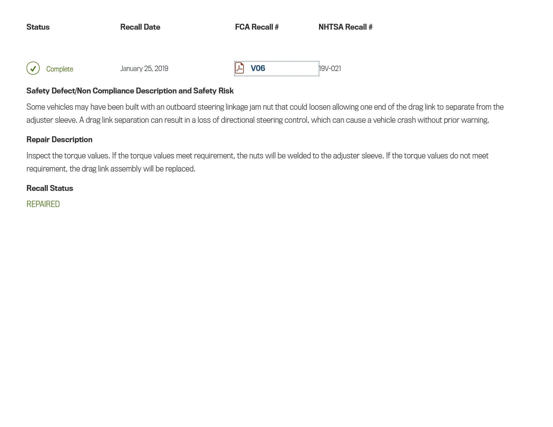

Yeah!!!!!!!!!!!!!!!!!!! It took 6 months and 2 separate visits to dealer to get FCA to mark my installation of the new style drag link as complete.
Status Complete
Recall Date January 25, 2019
FCA Recall #V06
NHTSA Recall #19V-021
NHTSA 0 Unrepaired Recalls associated with this VIN

Wow, this is just crazy, I got a recall notice on my smart phone app today saying V06 was outstanding. Both sites showed it complete when I made the post above. Logged onto the RAM site and Safecar sites and both say it is outstanding. WTF???? This is beyond crazy! April 1st is months away.
Call FCA Recall line last Thursday and they said they would get back to me by the next day. Went to doctor in the area of the dealership in Mesa, so I stopped by the dealership and asked again to get the recall removed from the vin. They called the regional service rep and he said because I installed the new drag link they would not write it off. This morning I called the FCA Recall line again and got "Evan" (ask for him if you ever call them), while on the phone with him he put me on hold. After a few minutes he came back on the line with a manager for the dealership on the line with us. They asked once again that I bring it in, as the last work order was left open and they could not get into because the service writer was no long with them. They setup and appointment for 10:30 and had the for 45 minutes or so and gave me this work order saying they completed the recall. Finally maybe six months later this mess will stick to the wall rather than sliding down to the pavement.
