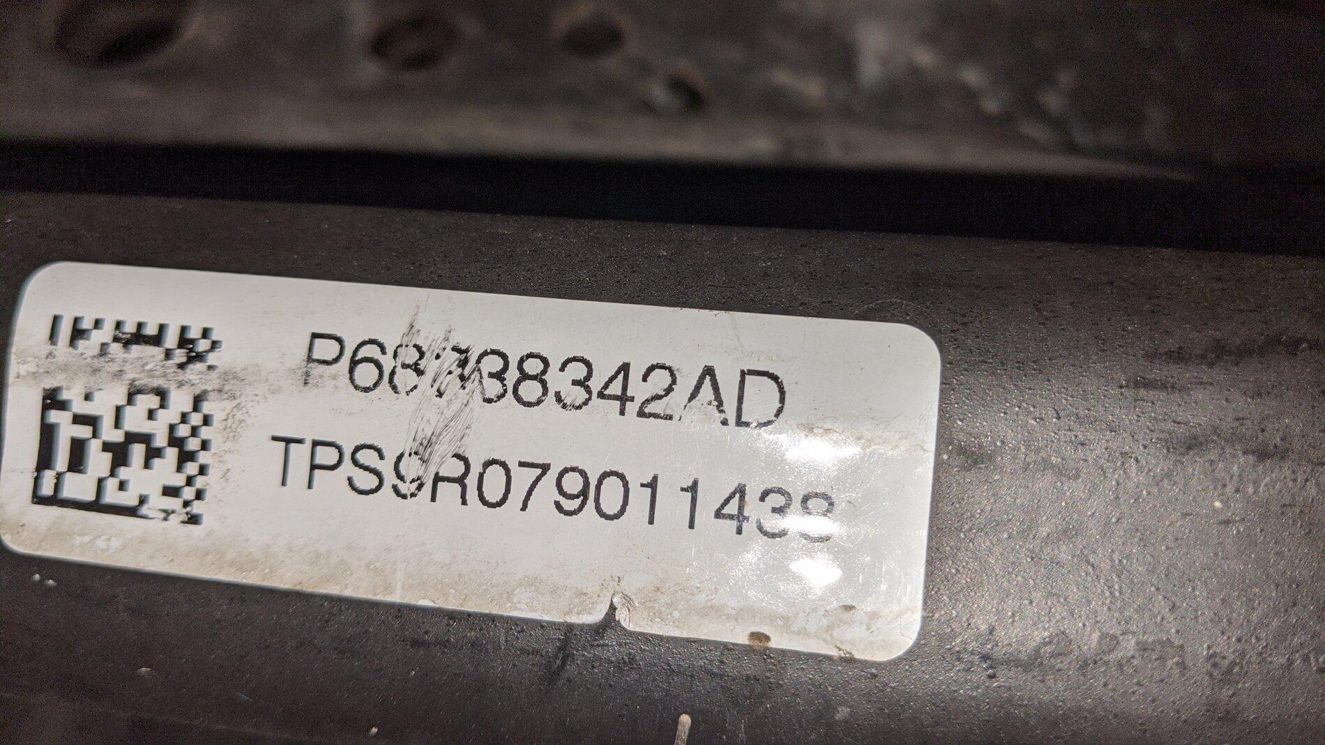

You might want to look at the crimps on the passenger end. The end price is inside the tube and I have two distinct crimps in the tube to hold it in place. I wonder if the difference in letter at the end deals with these crimps? The question is raised in at thread about failures of the new parts.
There has been a few people writing on the Cummins forum about failures of the new style drag link. They posted that on the Carli Facebook page there are more write ups about the failures. I can’t get into Facebook. I’m not a member nor will I ever become one so I can’t access the pages.

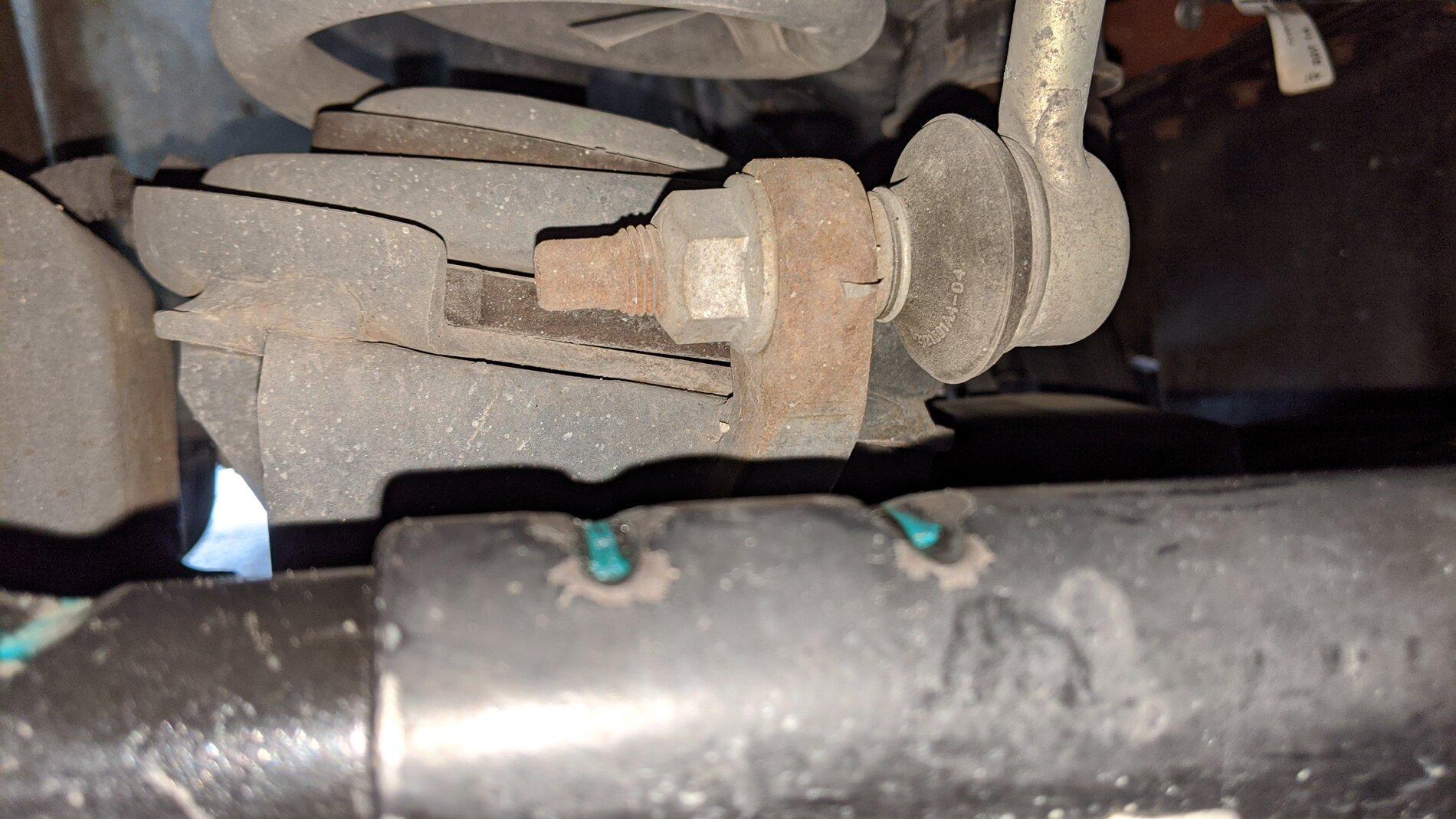

What they are saying that the passengers side end is now having issues. The end is pressed(maybe) into the tube and then crimps are done to the tube to hold it in place. I guess they did not have a welder!!!!!

Huh! Thanks for the pic!!! You just made me stop from clicking to order this setup. That picture made me second guess this setup. What the hell is holding that in place with all the pressure on that linkage. Dang, me no like!!! What is it with freaking Chrysler and these front ends!!!!!!Never ending story!!!!

Maybe it is threaded into the tube and the crimps are to keep it from turning? I changed the picture to a better one. AH64ID's is an earlier PN (AB? vs AD), and wonder if there is a difference?
If done correctly the crimp/ stake will never come apart... all depends on the person doing the job at the factory. Miss align it and I bet all goes to hell. The 08 update kit has the same crimp connections on the cross over link between left and right tie rod ends. You never hear of one failing.

It did. They changed the part number sufix to a AD (which now covers 2013-2020 but same drag link as far as I can tell) and more the doubled the price. It's pushing $300 now.
