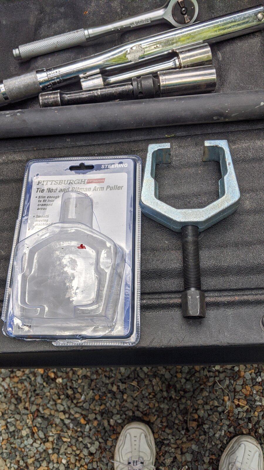

Steering wheel was at 10-11 O'clock. Three shortening of the drag link has it just perfect. Adjustment is very easy, loosen the cramp and turns by hand. :):):)
