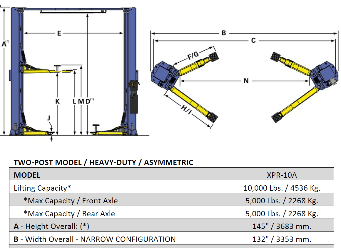

yeah good point John... My new truck is right at or just over the SPEC for the front arms on my 10k (all are rated at 5000) since it is heavier than my 04 was...either way, I do not get under it without the tall jack stands.

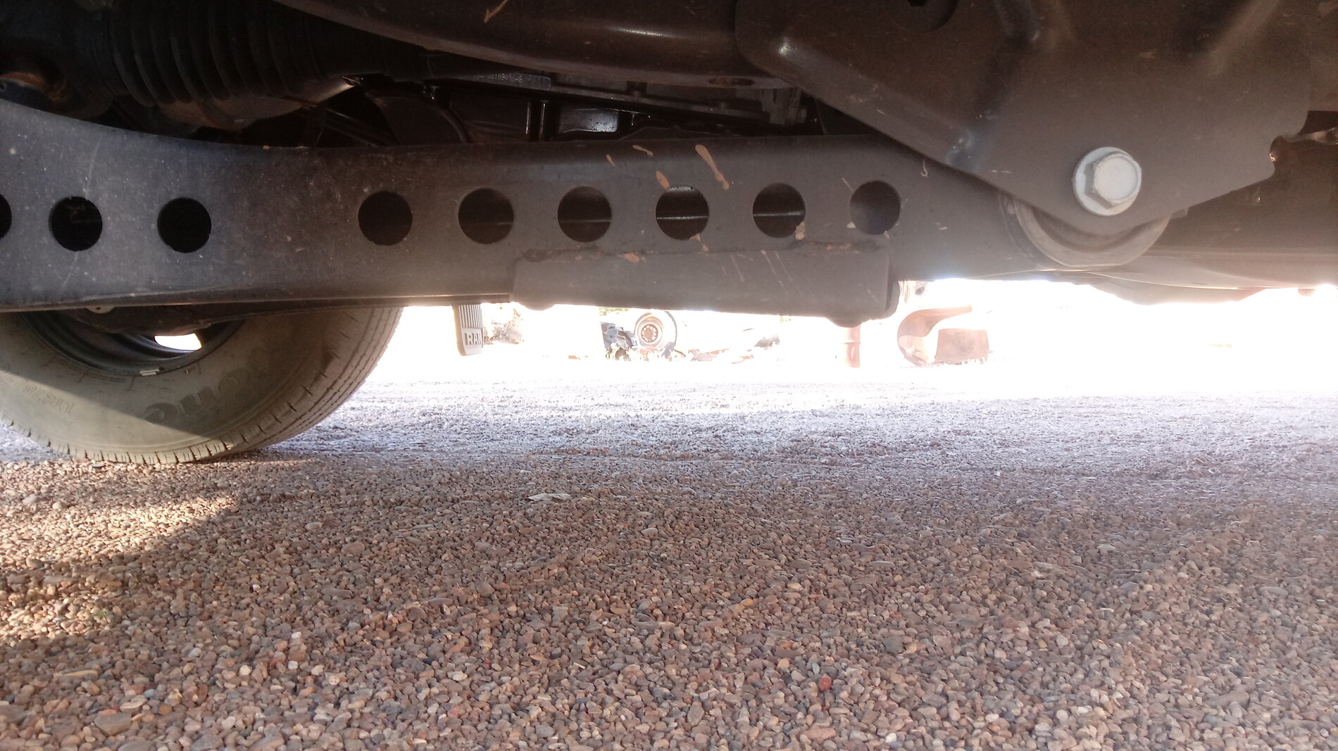

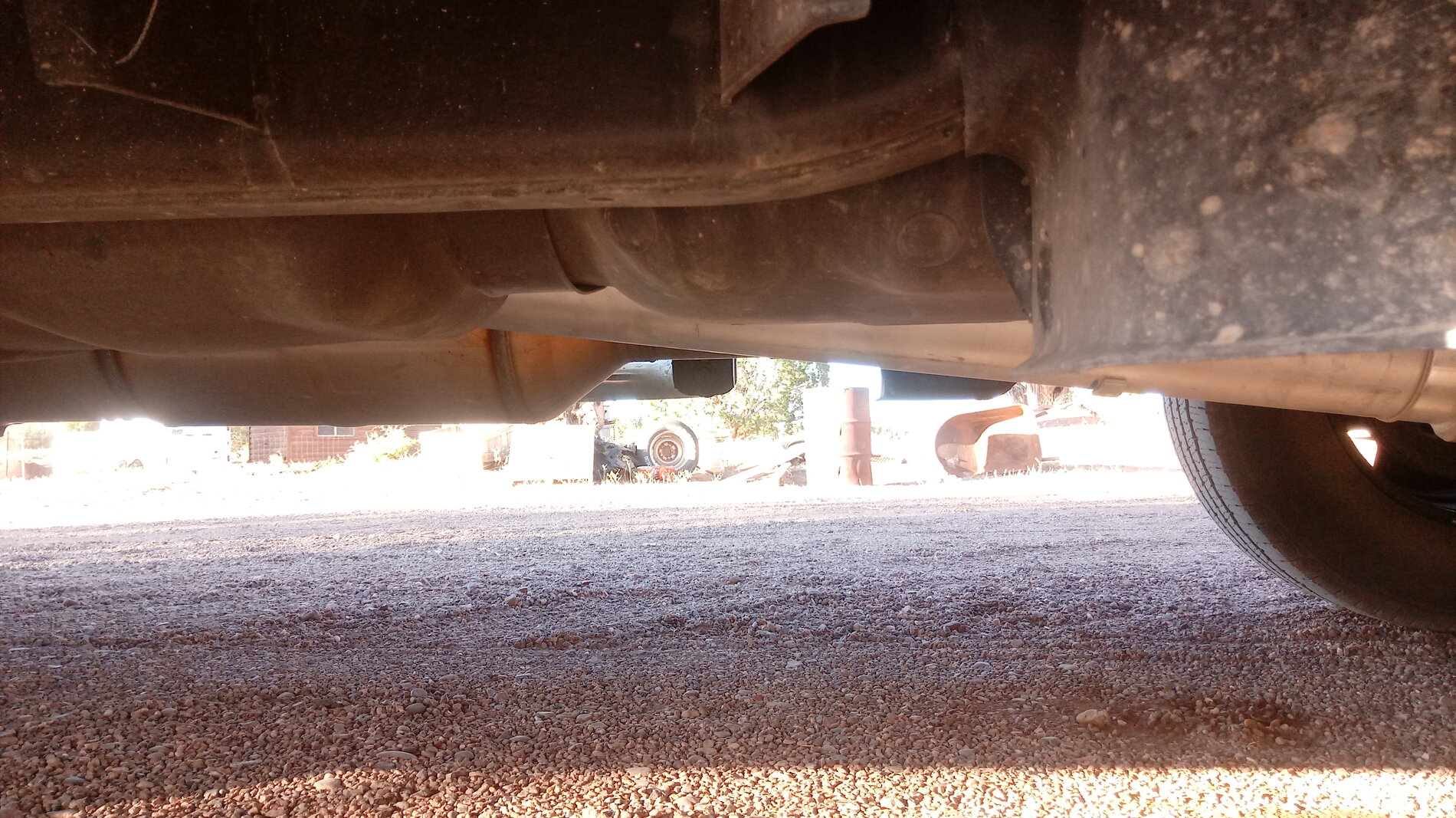

I just checked the truck for lift locations and it appears the front has a purpose built bracket on the control arms for lifting. It is 6' from the tow hooks and the last straight section of the rear frame is in front of the rear suspension, or about 7.5' from the bumper. That will give a 6' spread on the lift arms. That is probably a good place to start.

My truck weighed in at 8980, 5580 FR/3400RR... Of course I think that was with my 60g aux tank and two passengers,.. so I think like John said its right at the limit. I need to figure out what the weights are at the lift points (which are fixed pads on the lower control arms) on the 19+ trucks, but I suspect since the rear lift points are significantly closer to the front of the bed that they will be taking up more of that split..
Gives me incentive to put stripes on the ground for wheel location, I have an Asymmetric lift so long arms in the rear, short in the front, they are much beefier in the front than the rear yet same rating..:confused:.. anywho still have to have the total CG in the correct location, .

On my Asymmetric lift they are "ALL 5k rated" but as said some are twice as long as others... the ones carrying the heavy end of the truck are the short ones so like I said, at the top end but not too concerned if the longer ones are good for 5k, just try to balance the CG best as possible.

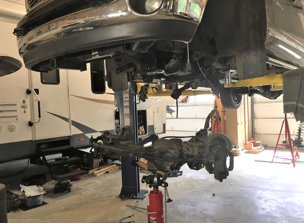

below taking the front axle out of my 04, easy peazy with support stand in the back to hold the weight once removed from the front!
