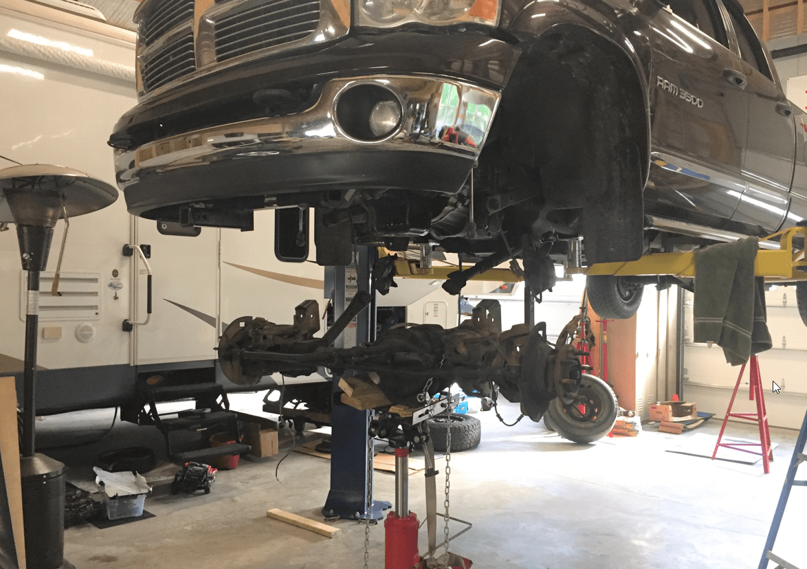

Do it! That was a must have when we built our new shop and it's kind of like a loader on a tractor - once you have it, you don't know how you ever got along without it!
X2 on do it!!! you'll never sit on you porch chair and say I wish I hadn't bought that tool!! It's gotta be one of my favorite tools I have (next to my tractor and loader...
Makes jobs like this, axles, trans, etc a whole lot easier :cool: .... but even tire rotations are a walk in the park now... if only RAM hadn't blocked access to that filter!

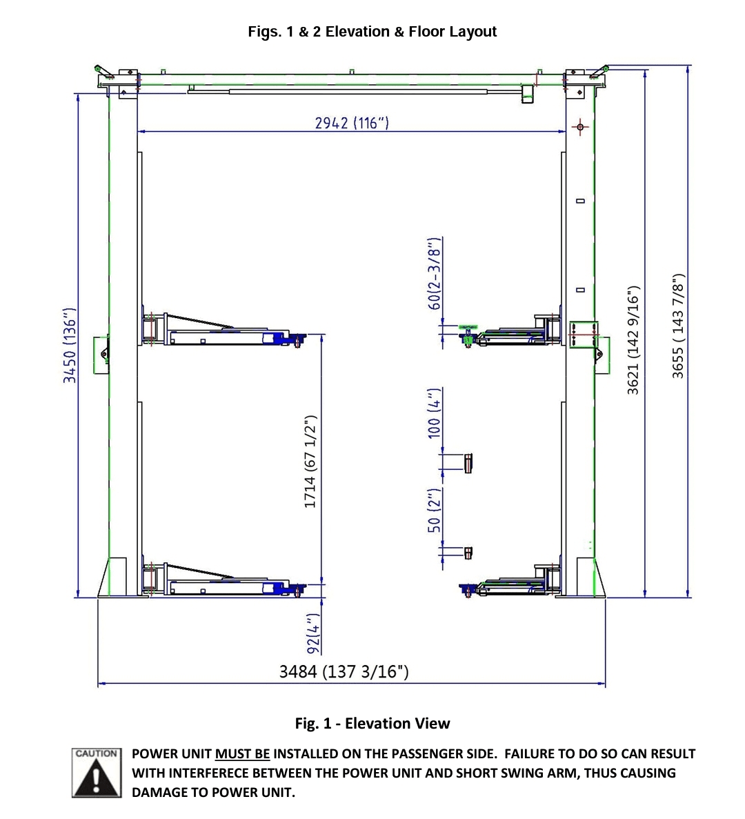

I have been doing some research on vehicle lifts, in the 10k range. I am dreading my transmission service without one. Of all places, Lowes seems to have some of the best prices with free shipping.
It will be mounted to a 18'x18'x4" outdoor slab. I hope that is strong enough. It does have rebar in it. One thing I don't see in the specs, is the foot print of the posts.
These are both ALI certified...looking mostly at the cheapest one, the Ideal.

4.25" is where the install guide has the pad.
Check this is the correct info but looks like 137"/138" (11.5') to the outside of the columns, and 116" (9.6') to the inside, but it shows some tighter stuff then that 116".

Pad
2.2 Surface Condition / Foundation & Anchoring The 2-post hydraulic lift should be installed on level ground. The foundation must be 4-1/4” minimum thickness concrete, with a minimum compressive strength of 3,000 psi. Failure to meet the foundation requirement may cause the lift instability or personal injury. Installing on asphalt, soft clay floor or near the expansion gap is prohibited.
FOUNDATION and ANCHORING REQUIREMENTS
1. Concrete shall have compression strength of at least 3,000 PSI and a minimum thickness of 4-1/4” in order to achieve a minimum anchor embedment of 3-1/4”. NOTE: When using the standard supplied 3/4” x 5-1/2” long anchors, if the top of the anchor exceeds 2-1/4” above the floor grade, you DO NOT have enough embedment.
2. Maintain a 6” minimum distance from any slab edge or seam. Hole to hole spacing should be a minimum 6” in any direction. Hole depth should be a minimum of 4-1/4”.
3. DO NOT install on asphalt or other similar unstable surface. Columns are supported only by anchoring to floor.
4. Using the horseshoe shims provided, shim each column base as required until each column is plumb. If one column has to be elevated to match the plane of the other column, full size base shim plates should be used. Torque anchors to 110 ft-lbs. Shim thickness MUST NOT exceed 1/2” when using the 5-1/2” long anchors provided with the lift.
5. If anchors do not tighten to 110 ft-lbs. installation torque, replace the concrete under each column base with a 4’ x 4’ x 6” thick 3,000 PSI minimum concrete pad keyed under and flush with the top of existing floor. Allow concrete to cure before installing lifts and anchors (typically 2 to 3 weeks).

I looked for quite a bit before selecting my lift and went with a 12,000# capacity. With the weight of today's pickups, I figured a little extra cushion was good and the price wasn't that much more. Every time I use mine, I have a smile on my face thinking about rolling around in the dirt from days gone by. You will be elated knowing the creeper is mostly going to be a shop ornament!
One thing I did was make an adjustable leg to go in the receiver of the truck. It makes things rock solid. I put a red card over the controls so I don't forget to remove it when letting the vehicle down. I can take a picture, if you would like to see it.
Bud
When I started teaching the diesel class at the college they put in a 10k lift for me. If we were going to replace it I would go no smaller than a 12k. The 10k is pretty scary sometimes with a Mega Cab or one that has a bed full of stuff. You will want a high stand to place under the hitch for extra stability. Just remember to pull it out before lowering.

So the anchor needs to be a minimum of 3.25" deep. Dang, I hope the rebar is lower than that. If not, that could be a real issue.
It also looks like a tight squeeze to get out the door? I would hate to have to push the truck the last few feet to line it up.
I checked on some 12k lifts but they all require 6" concrete and are way more money.
