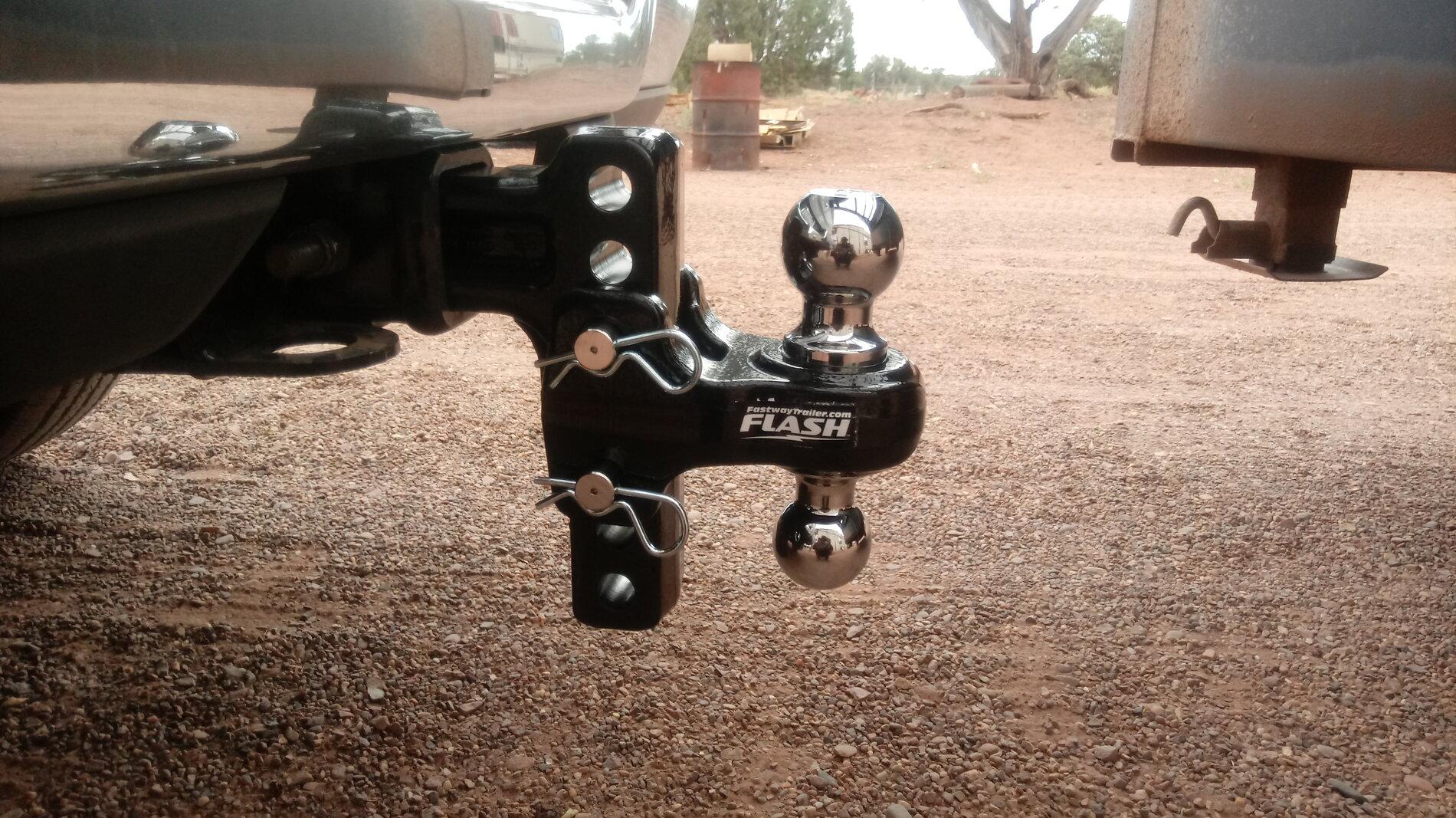

Installed the Westin steps and Fastway 2.5" adjustable ball mount, made in USA:) 20k rated.

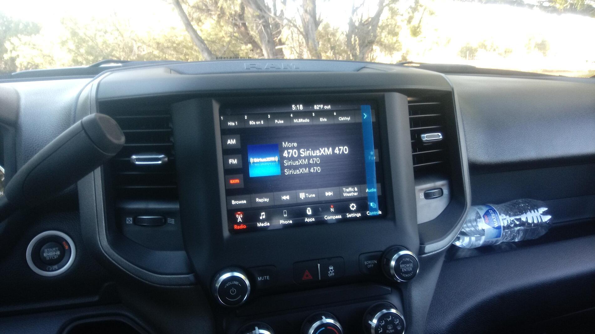

So, the menu buttons along the bottom of the radio screen doesn't have an HVAC button?

And, you know, of course, that the ball mount may be rated at 20K but the receiver on the truck isn't.
No buttons on the screen that I could find, here is a picture of it. Yes, lower fan gets more heat or cooling.
The operators manual says Class V/2500 models are rated 20,000/2,000, the 3500 is 23,000/2300. Gooseneck/2500 models is 20,000/3000, 3500 is 35,250/5,287.
On both on our 2019 (12.0) and 2017 (8.4), the only control for HVAC on the screen is "Climate" that you select which ducts air flows from. On our 19, buttons control fan speed and temp... on our 17, dial controls fan speed and buttons control temp.
Maybe where it says "CONTROLS" on the right end of the screen buttons.
And, do you still have the peel off protector on the screen, is that what that blue strip on the right side is?
And, I guess they uprated the receiver on the newer trucks, mine is like 18K rated.
