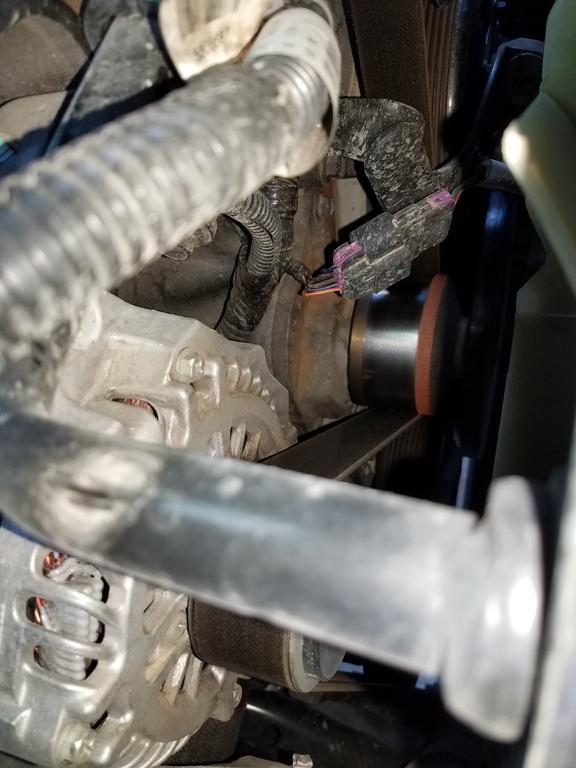

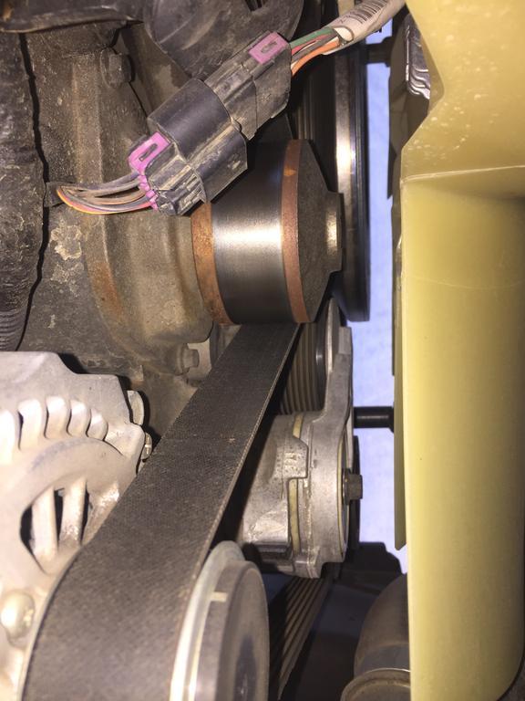

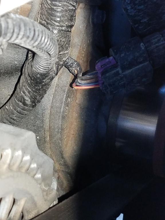

Looking from the top can you see holes if they are on the pump?
The vent hole,if equipped,is located at the 10 o’clock position behind the water pump pulley.

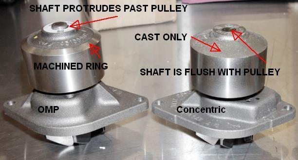

With a good light I would say yes.Only the concentric built pump has to have the hole,the omb pump is fine without the hole.
This should eliminate some fear. Check your pump and see if it needs to be replaced. But remember if you have a pump that is one of the good ones, you still need to go down to your dealer and have them do the inspection and delete the recall from the system. Some states are blocking vehicle registration renewal if the vehicle has an open recall.
If you have the OMP, no replacement. If you have a Concentric with vent hole no replacement.

thanks for the detail description and pictures. looks like mine is part of the recall to get replaced. no vent, and defiantly not OMP.
