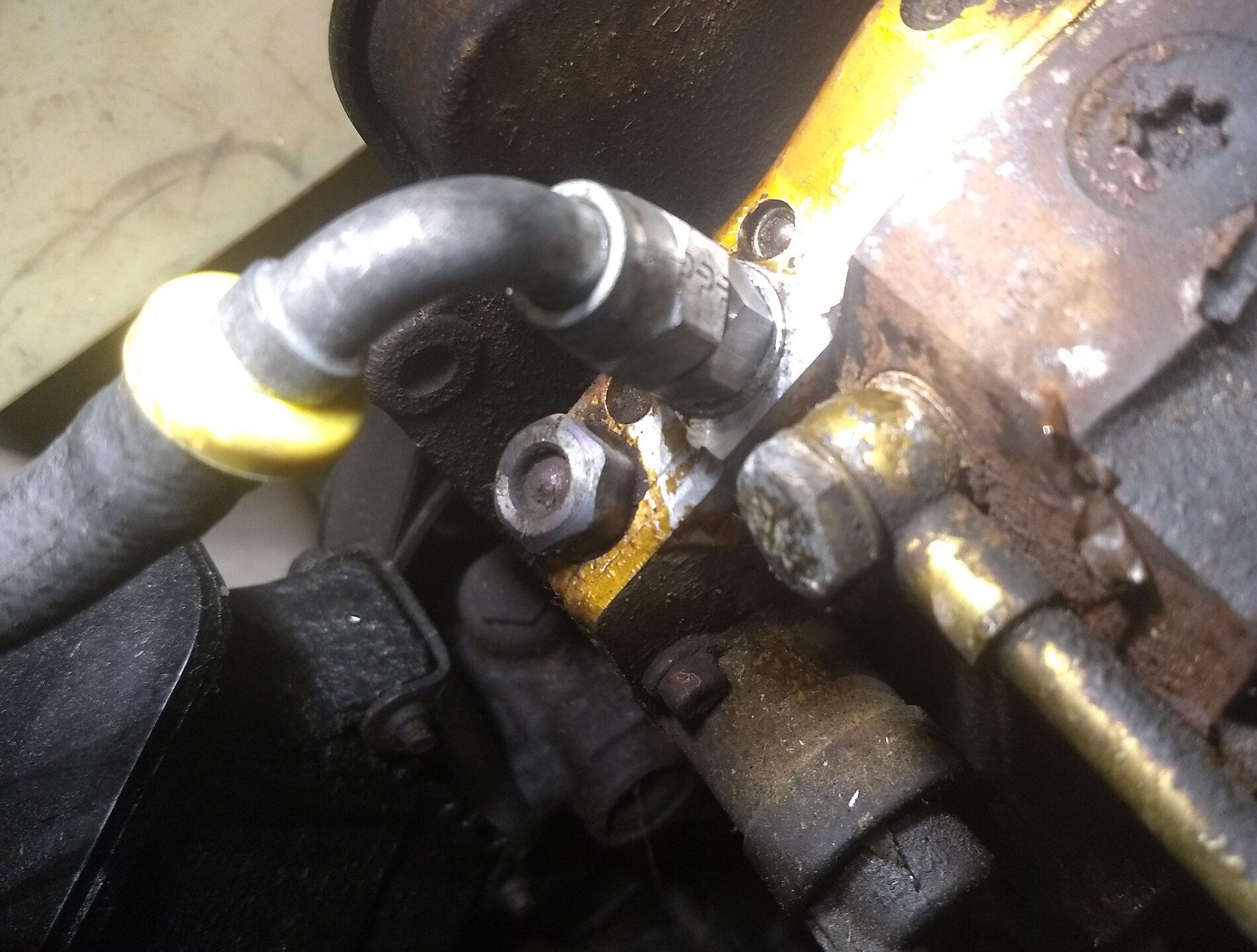

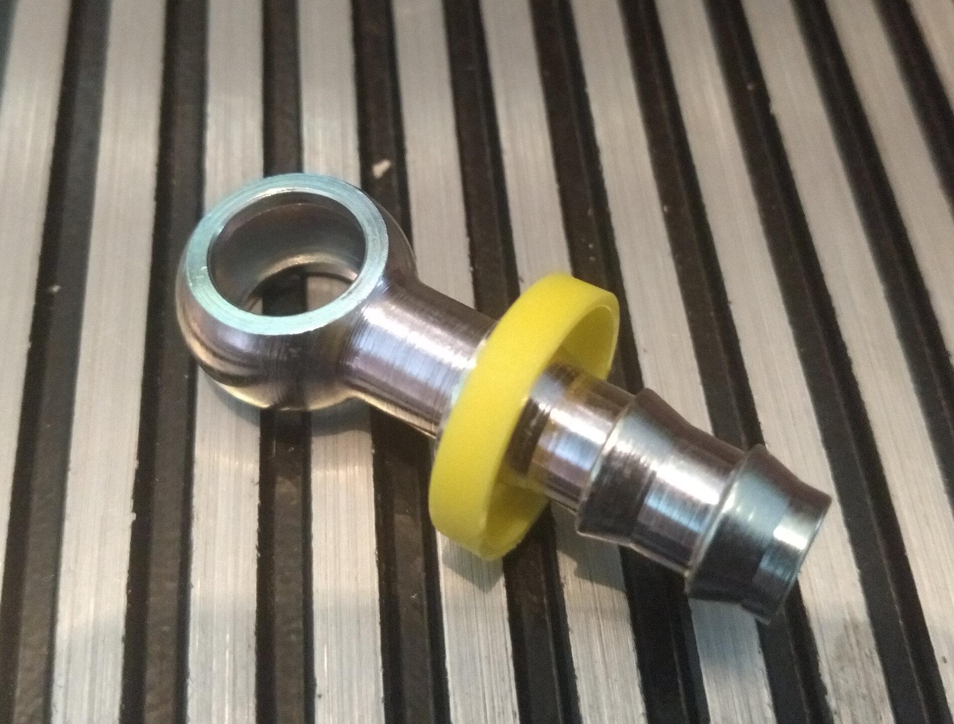

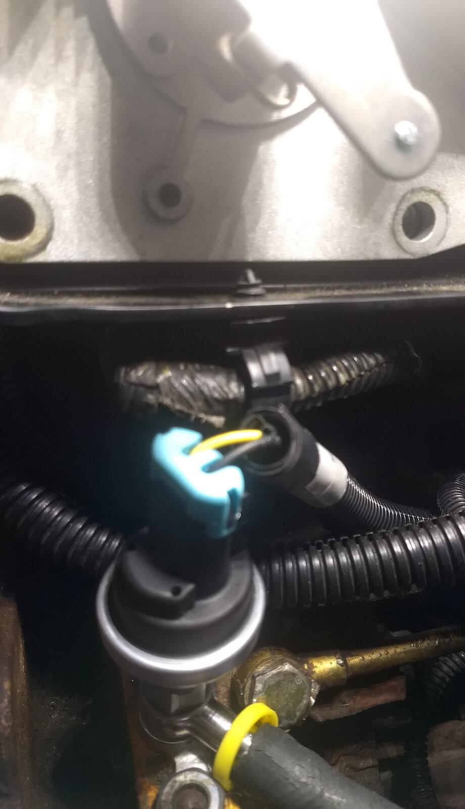

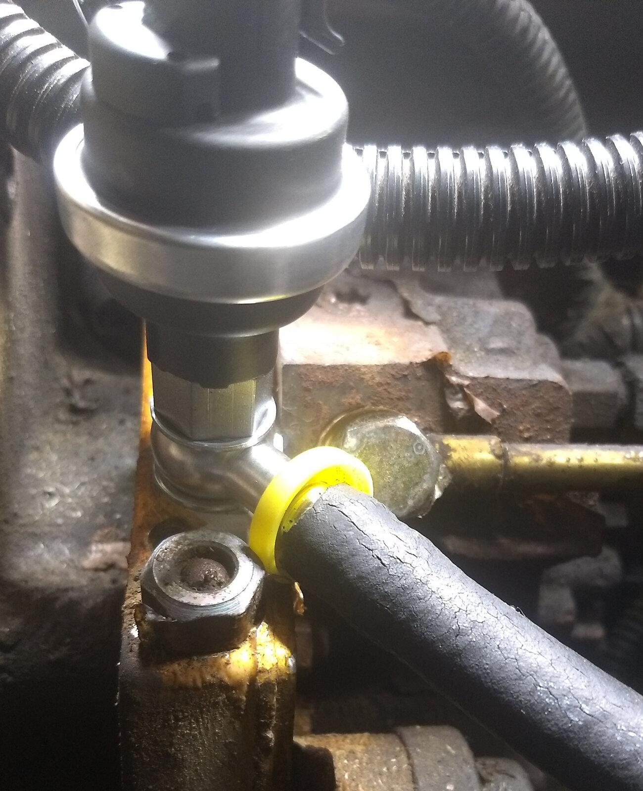

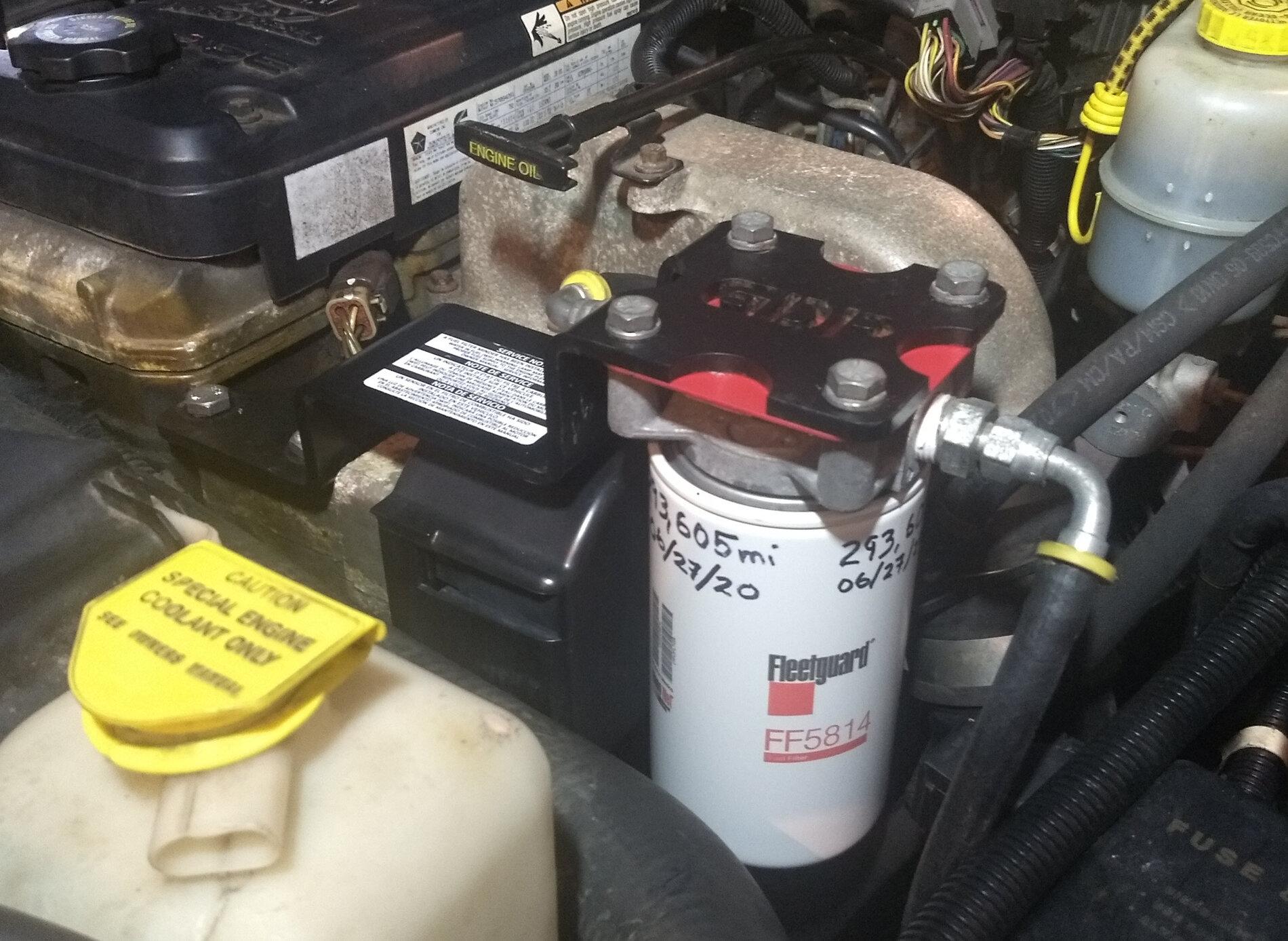

Mine came yesterday; I have the GDP MK-2 + BLK APPS Mount on my 5.9L which replaced the banjo bolt with an adapter to MJIC, coupled to a 90° FJIC to 3/8 PushLoc. I'm going to need a 12mm banjo to PushLoc adapter like the Parker 34982-12-6. GDP sells them. Should have it in a week or so. I'll post before and after photos if I remember.I wonder if this kit can be used with the Glacier Diesel Big Line Fuel Filter Kit for the 6.7L Cummins. I have installed the Big Line Kit on my truck and this required a new 3/8" ID fuel hose with fittings into the pump. It does not look like it will work to me but I could be wrong.
