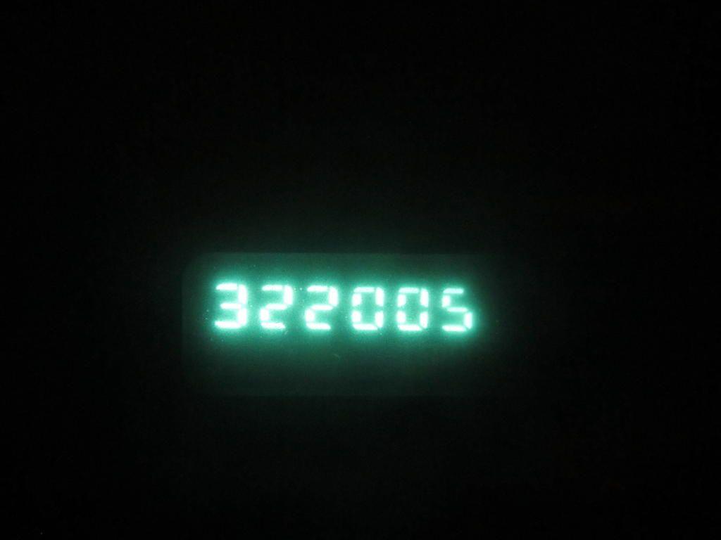

I am not one to brag but I wanted to let everyone here know what a great truck I have had. I have over 322K miles on her putting out 39 boost with the following OEM parts -- OEM transmission, rear end (with new clutch plates at 318947 miles), OEM turbo, motor and OEM shifter with other smaller OEM parts. I did try to attach a picture of the miles she has to date. I have worked as an electro mechanical technician until there were no more manufacturing plants for my experience so I ended up working with James, who was a diesel mechanic on heavy equipment, farming equipment plus Dodge trucks. I had done my own work on my farm equipment plus diesel truck but James taught even about the over sized pipe, Edge attitude, Smarty chip, Bosh injectors, air dog fuel system plus more for the older diesel trucks he had were up to 12 with 5 pieces of heavy equipment. Even the 2007 Dodge truck of his he bought brand new we installed the EGR delete kit.

I would say you are certainly in the minority having that good of service out of a 47re. When I bought my former 00 it still had the original trans at 270k but I couldn't even download a moderate catcher tune on the smarty without experiencing some serious TC shudder under acceleration. It Got pulled shortly after that for a rebuild and I still have that trans in my 98.5.
