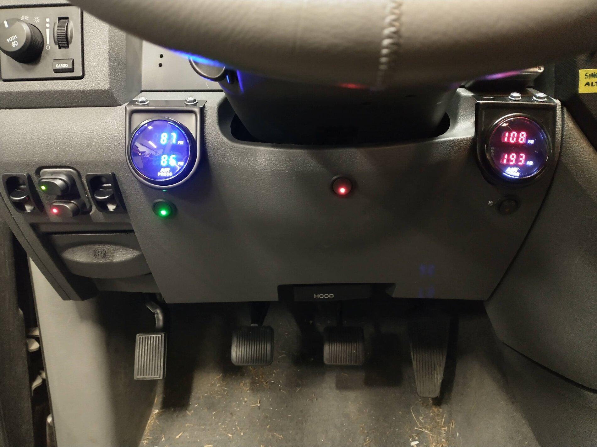

Almost forgot, the inside. The blue pressures are for the air bags, left on top, right on bottom. The red pressures (top is regulated 100psi service, bottom is tank 165-200 psi). The inflate/deflate valves on the left, either side of the red and green led switches (it's where I could fit them). Under the blue pressure gauge is a green led switch for the DRLs I installed, the Red LED switch is to enable/disable the air horn solenoid (horn activates with the OEM horn). The other switch under red pressures (orange LED) is for the air compressor, and next to it an LED for compressor running indication (both off in this picture). The red and green rockers between the air valves are pre-existing, Green is for fuel transfer from aux tank to main tank, the red is for a pair of 120A relays to power a high amperage connector on the bumper that lets me fully power the RV, to include enough juice to run the rooftop AC via the inverter on the RV (This is something you can do with twin 220Amp alternators!)
