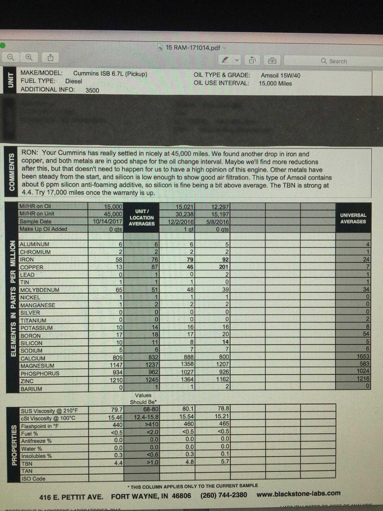

I change my air filter every 15K along with my oil, oil filter and fuel filters. YEA, YEA I am wasting money and not getting the best filtration. :cool:
Oil report says I am doing just fine! The comparison numbers are for 6K changes so I am running 2.5 times that.
