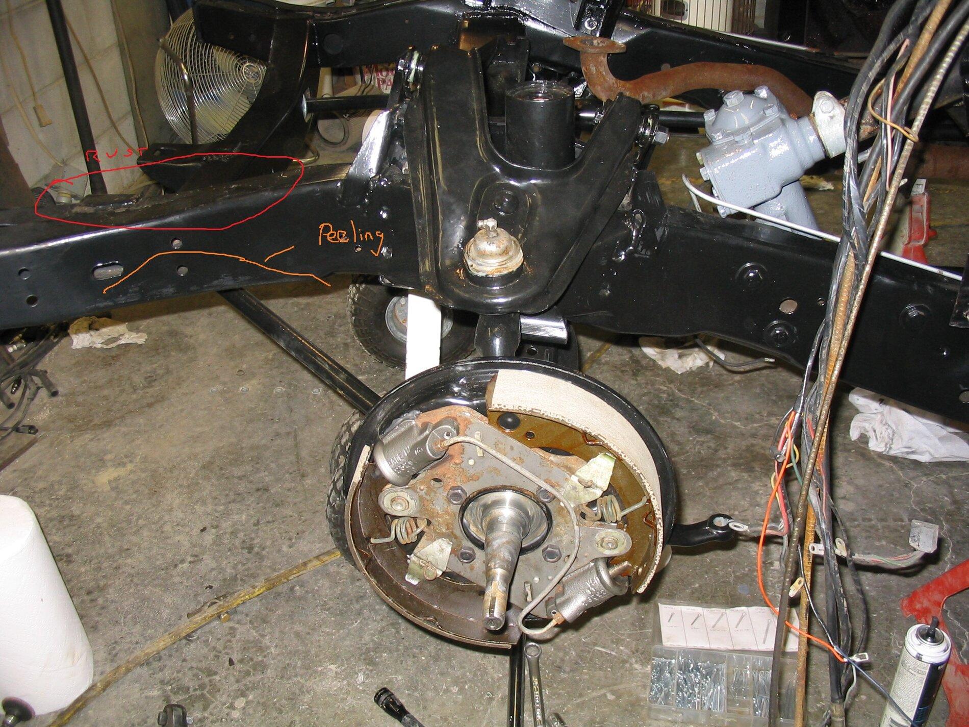

I sand blasted the frame - down to bare metal. Used their degreaser, their metal prep, their paint, etc. Still had rust showing on the top of the frame after 1 year and some flaking of the top coat. The painted chassis did sit outside for about 6 months.
Not the best pic, but you can see on the front of the frame what I'm talking about.
followed all the directions to the letter - metal ready, primer and top coat (chassis black)
I have used POR 15 Products extensively. From the sequence you stated, you did not follow directions. "Metal ready" is actually "Metal prep" and is not needed in most cases but gives extra protection and adhesion. NO PRIMER before chassis black. That is your problem. After chassis black or POR-15 if you want to top coat, you must use their Tie Coat primer. Also oil and grease must be removed.
I have used POR 15 Products extensively. From the sequence you stated, you did not follow directions. ……..
Sorry, you are wrong too. I did follow the directions. That was 15 years ago, so maybe I did not use the correct exact language in this explanation,, but I did follow the exact directions.
There was no need to use the tie coat primer stuff because I never put anything but their product on top of itself. Again, don’t know the exact wording, because I don’t care, because I’ll never use it again, but I did follow the exact directions.
Since you have used extensively, have you had any problems?
I figured I probably had a bad batch of something. All of it was bought at the same time. But the fact they wouldn’t stand behind anything when I spent a whole Lotta money buying a whole bunch of their product does not bode well for me buying anything from them again.
