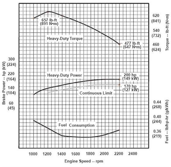

The following explanation of torque rise might be worth a read:
Torque and Torque Rise
Horsepower is a rate of doing work. Torque is "the rotary force in a mechanism" according to a dictionary definition. The two are related (Torque lb-ft = H. P. X 5252 / RPM) but torque is often misunderstood. Since there is a fixed relationship between HP (or kWm) and torque, two engines having the same horsepower at the same RPM will have the same torque. However, at work, the two engines may perform very differently. The reason for this is they may have very different torque rises. Therefore they respond differently to the demands of the load.
The length of piston stroke, number of cylinders, rotating mass and other factors, affects torque rise. Newer electronically controlled engines are able to produce torque characteristics that could not be achieved with mechanical fuel controls.
Engine horsepower curves often show the torque curve or "pull down torque" as well. This curve illustrates the amount of torque available from the engine as a load is applied that exceeds the engine's rated torque at the operating RPM. The difference in the torque at the rated RPM and the maximum or peak torque is the "torque rise". It is usually expressed as a percentage. (Peak Torque - Rated Torque / Rated Torque = Torque Rise X 100)
In this case the rated torque is 477 lb. -ft. and the peak torque is 657 lb. -ft. @ 1200 RPM. The torque rise is: 657 - 477 divided by 477 = 38%.
Note that although there are two horsepower curves, continuous and intermittent, only the intermittent torque curve is shown. The assumption is that if the engine is "pulled down" (reduced in RPM by the load), then the engine will be performing on its intermittent rating curve. Torque curves are usually available for any published horsepower rating.
What all this means in actual usage is that, in many applications, the engine with the greater torque rise will do its work more quickly. It will seem more powerful and responsive. This difference will be very evident in applications where the engine is routinely pulled down from its rated speed by the load. Examples of this are a drilling rig lifting the rod string, a grinder processing a stump or a loader digging into a rocky bank. Even applications not generally thought of as sensitive to torque rise such as generator sets and marine engines can, under some conditions, benefit from good torque rise characteristics. (Pulling a heavy trawl net, bucking a current or starting a motor load, for example. )
Torque and torque rise are very important considerations in many applications particularly those where the engine is routinely pulled down from its rated speed owing to the effects of the load. Greater torque rise allows the engine to run at a higher r. p. m. under load and thereby accomplish its work more quickly. In extreme conditions, inadequate torque rise will prevent the engine from accepting the load and it will stall.
There is a lot to add on the importance of torque. "Droop" and "isochronous" governing, electronic or mechanical controls and other factors enter into the aspects to consider. Again, if the intended usage is clear, the best option will usually be apparent.
