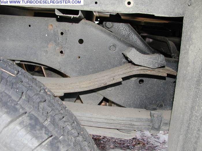

None of this has anything to do with "Off-Roading". All airbags do is inhibit the normal operation of the suspension and worsen the ride quality of the truck. Been down that road. You want to fix the problem? Put an auxiliary progressive spring pack in play on top of your rear stack of springs so the come into play gradually as you load the rear of the truck. You will maintain the unloaded ride quality this way as well. Any spring ship can outfit you as the photo demonstrates. This particular aux. spring pack is rated conservatively at 3,500 lbs. all by themselves.
