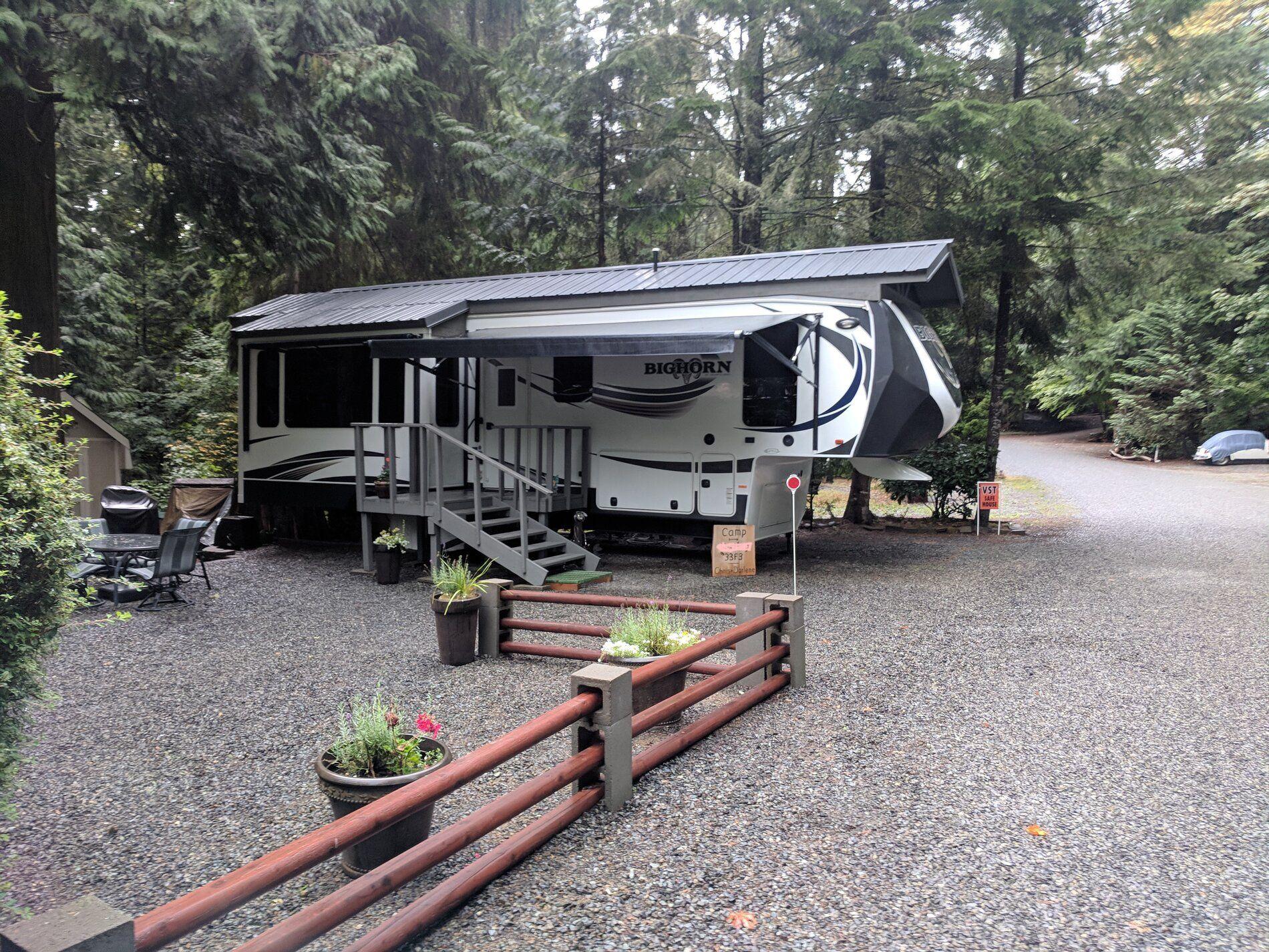

We traveled heavy, full timing in the Big Horn for a year and a half. I knew going it that I could not add a washer/dryer and generator and stay under the truck's 7K rear axle rating. The LT275/70R18E tires along with the OEM 20's are rated to 3640 each, so there is NOT a lot of extra capacity there.

I would also add that we towed the Bighorn in very windy conditions several times without issue. DW decided that she was not comfortable traveling with the 39' foot fifth wheel back and forth to our AZ park model, so it became our Northern home and we bought a commuter trailer.
