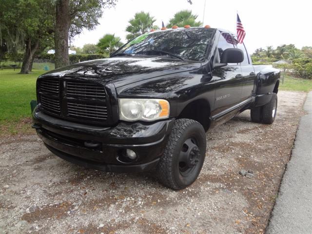

Motor back in truck, looks like I have another days work before its done. Still having problems with posting pictures, got one done and that's all it will allow me to post.
