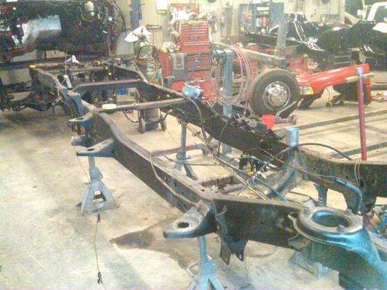

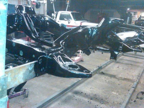

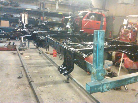

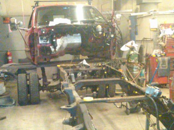

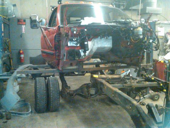

They disassembled my truck and painted the replacement frame last week. I stopped by Friday to check it out and was able to get some pics-posted below. What a great job they're doing and I can't wait to see it all back together. Just hurts to see my truck in a zillion different pieces. Also posting some links to cell phone video I took while there:
Old frame http://www.youtube.com/watch?v=s9Pc0FeNDHs
New frame before cleaned up: http://www.youtube.com/watch?v=Hc2naZB3ykw
New frame after cleaned up: http://www.youtube.com/watch?v=wenXgIEXY_Y
That's the kind of work custom restoration shops do all the time on classic cars and trucks. It looks like they're doing a nice job for you. It probably won't be cheap but new trucks are surely not cheap either.
