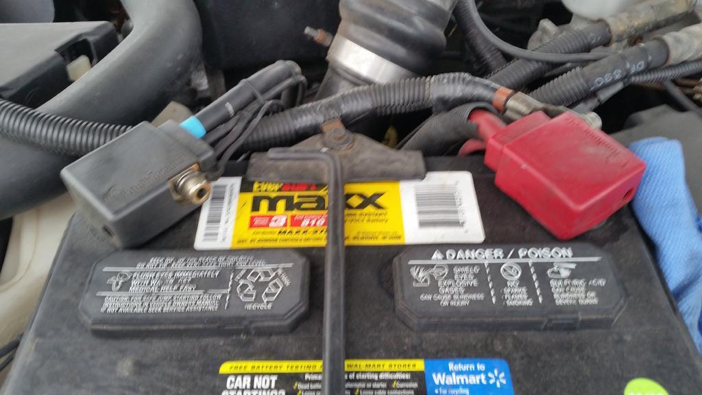

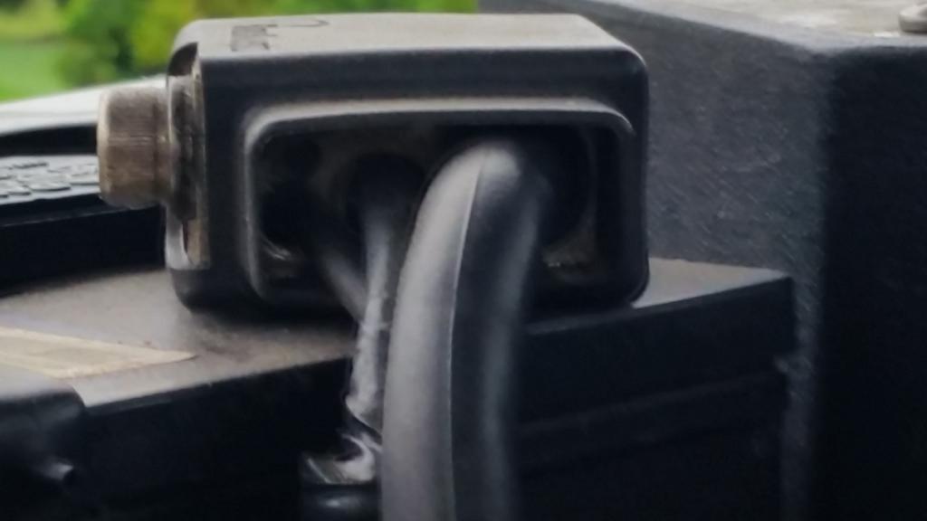

been a while since I posted pictures but here goes...
Sorry but it is raining and pictures might not be that great. Basically all cable connections are made by inserting into lugs and tightening allen set screws. Like I mentioned before I packed hole with Lube Guard and then tightened. Hope this helps and too boot these are available on Geno's...

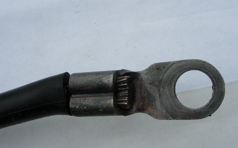

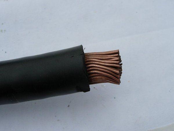

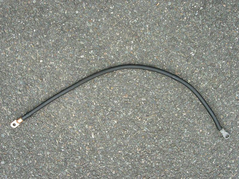

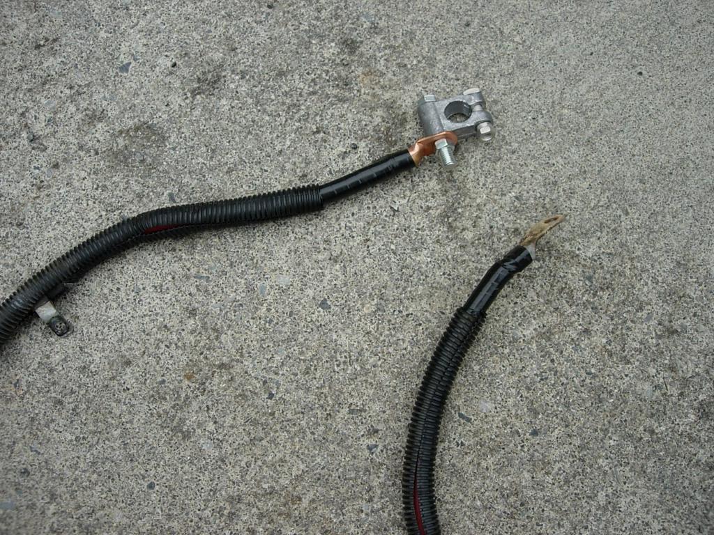

Pics of the finished product [bottom pic is the factory end attaching to the engine block. it didn't get cleaned up as well]:

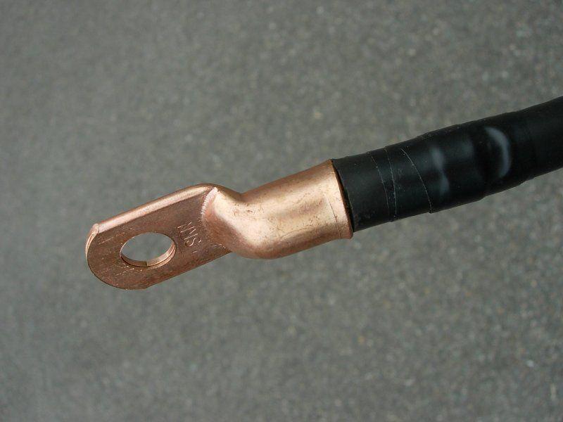

part 2 of the pics:
I added electrical tape over wear marks on the cable.
[It rarely pays to be in a hurry. I forgot to include the heat shrink tubing on final assembly.]
The "silver" connection is factory original. I tried to make it shine like new copper, but I think I should've used a degreaser on it before letting it sit in a mild acid solution.
The uncrimped copper lug attaches to the cable through solder only. It's tight, but there'll be no tug of war competitions using it! lol

I'm very pleased with them and couldn't beat the price when you need 2 for each battery that's a plus, and they're actually pretty neat. When you need to take them off its a ¼ turn on the allen head and they pull right off, put them back on a ¼ turn to tighten and "they are tight". Solid Block of steel with a slit that the allen head snugs up. I like it! Beats the hell out of OEM terminals.

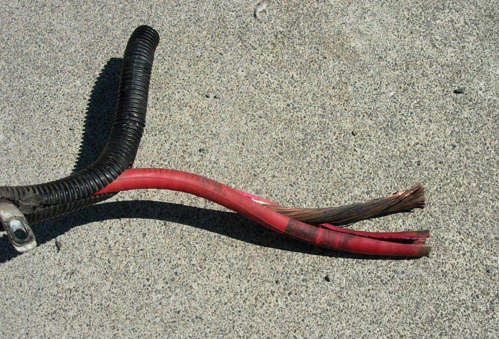

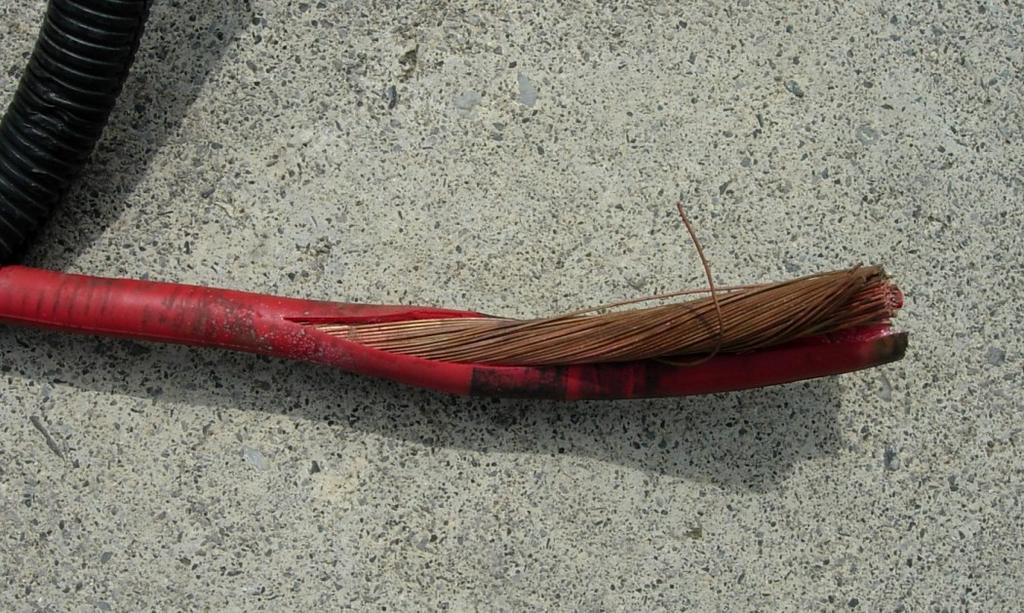

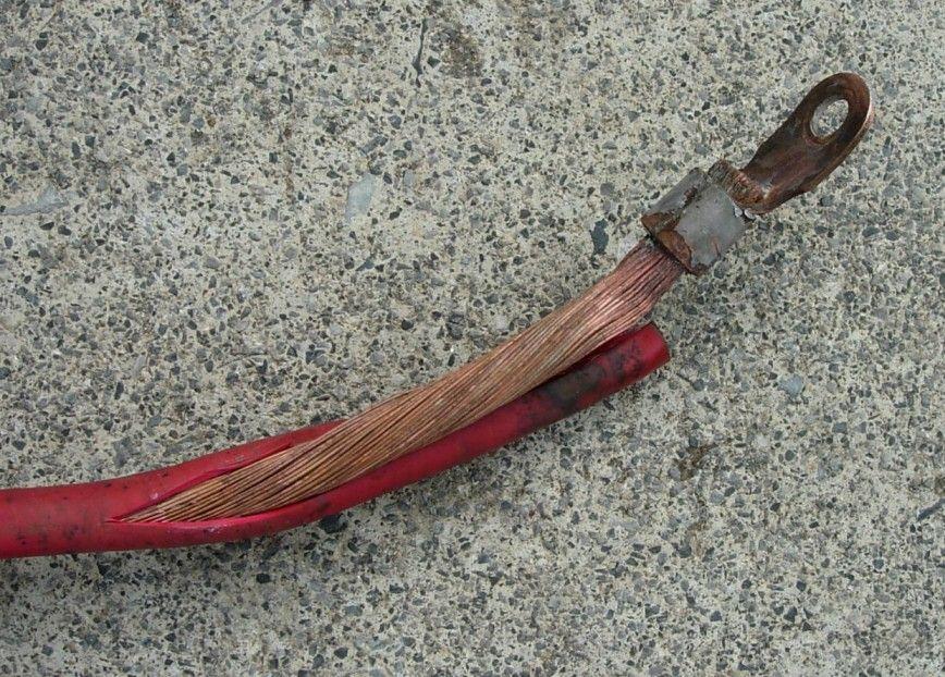

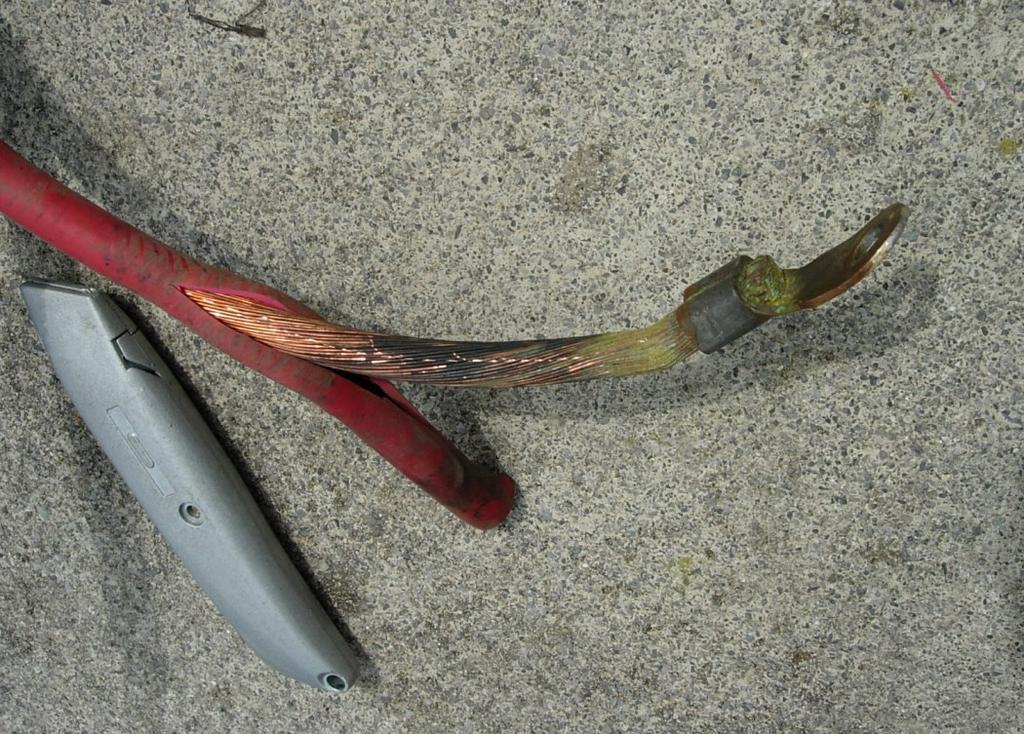

Finished up another cable. Positive crossover cable bridging the two batteries. This time I measured resistance before cutting the connector off. I also decided to peel back some of the insulation. [pics follow] The minor issue with removing some of the sheathing is that the cable loosens up - making it harder to fit into the lug. Zip tie remedied that. Wanting to expedite things, I used the strongest acid possible: muriatic, undiluted. It ate that copper oxide in 5mins. I left the cable in there for 20. Then I dipped it in a baking soda solution [heaping tablespoon worth] for almost 15min, even though it was probably ready in 10. You'll know once you see the bubbles stop rising.
Ohms, old factory cable after 21 years: 19ohms.
Ohms, old cable "restored": 0.2ohms !
Out of curiosity, I tried to measure the resistance of the corrosion. It was hard because the results fluctuated drastically - from 20 to 1500ohms! Brought out a cheap Cen-Tech multimeter, & it performed similarly. The harder I pressed the leads onto the cable, the less the resistance. Nonetheless, the readings never stabilized.
Mistakes made: I didn't pay attention to the orientation of the original connector before I cut it off. Installing the new lug in a different orientation caused difficulty when attaching it to the battery terminal.
Also: the sheathing never closed up tight. I suppose some liquid electrical tape is in my future, but my current electrical tape shall do for now. [After the liquid fills in the valley I made, I'll tape it with some Tesa wiring loom tape. http://www.tesatape.com/industry/automotive/applications/wire-harnessing]
Regardless, those are small prices to pay for a reliable connection at a fraction of the cost of a new cable.
