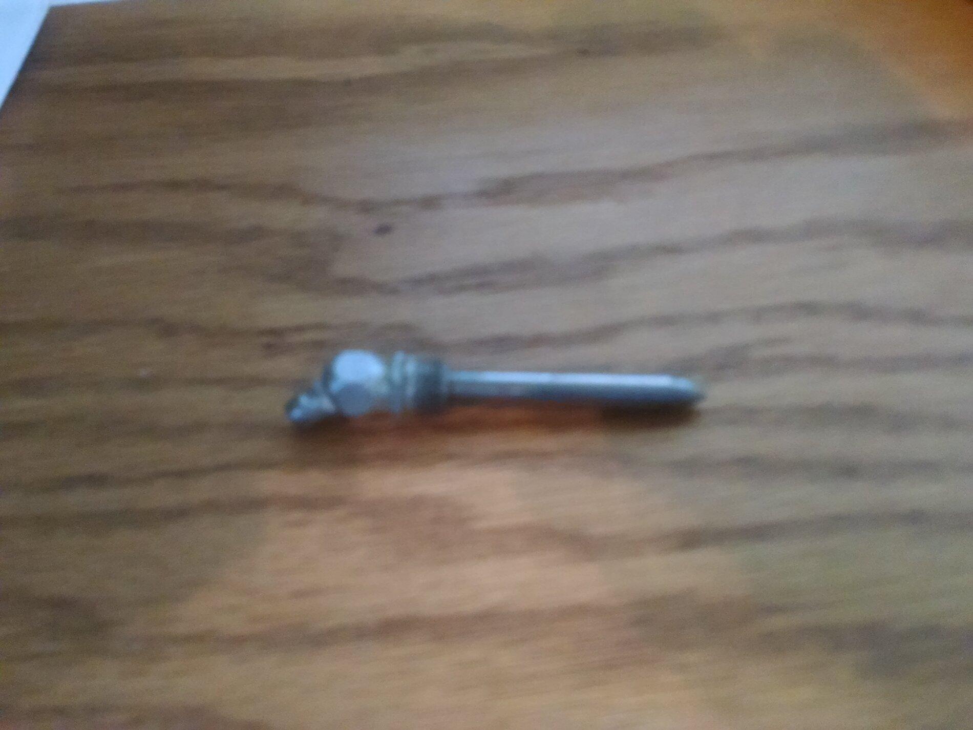

I made my own like that back in the 1980's.
A basic and easy oil change along with a front drive shaft greasing.
