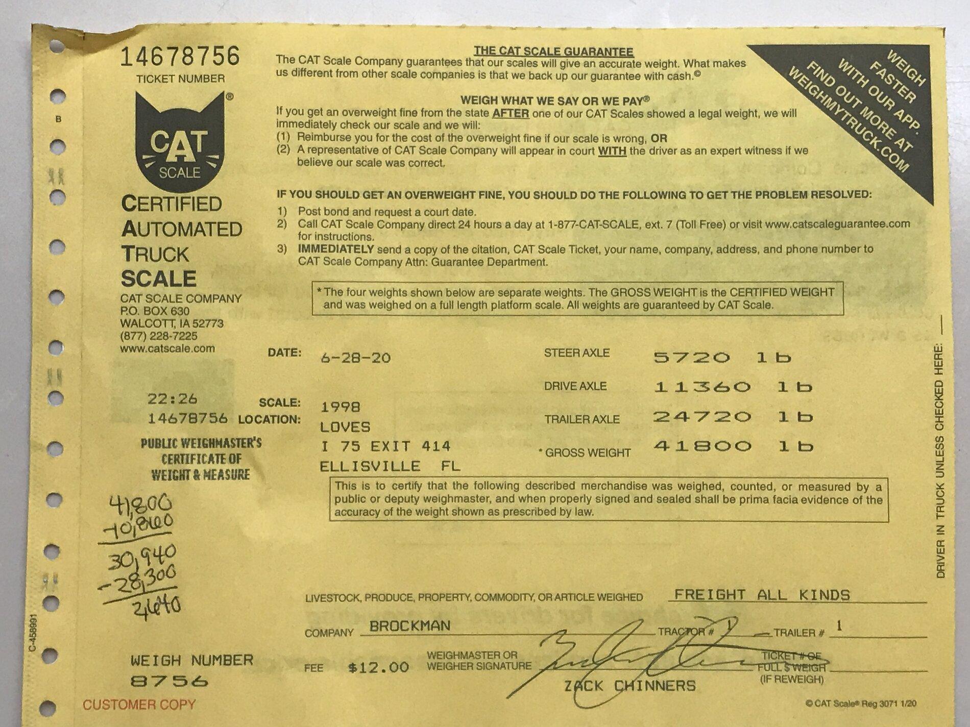

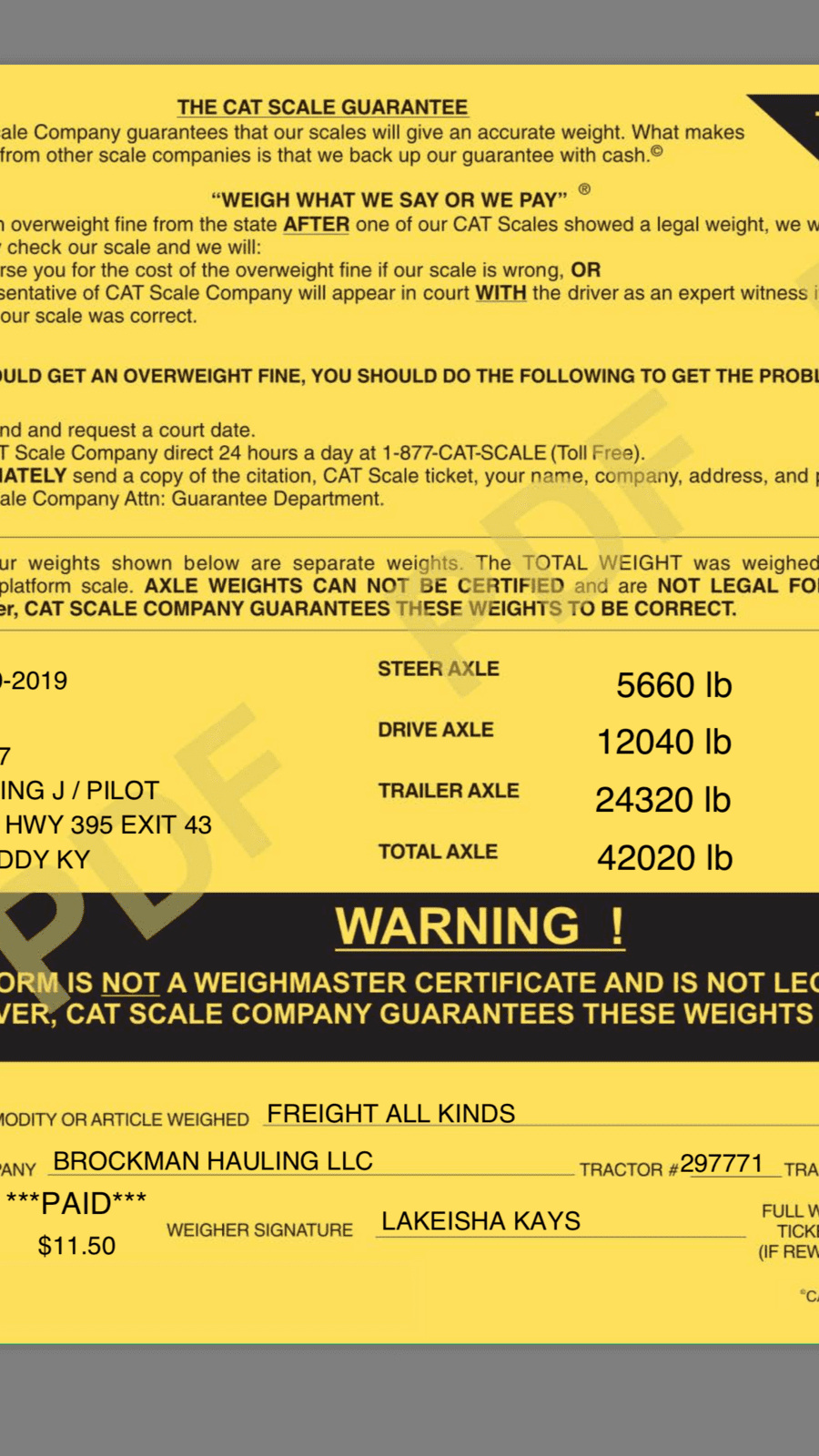

So.....where’s your scale tickets showing ANYTHING you’ve towed that has remotely netted anything close to over 26,000 or over? Oooooooohhhhhh....that’s right. You don’t have ANY. I guess if I were schlepping around pulling those tiny RV’s all day...I, too could average 63.5 mph :rolleyes:
Excuses, excuses...:rolleyes:
