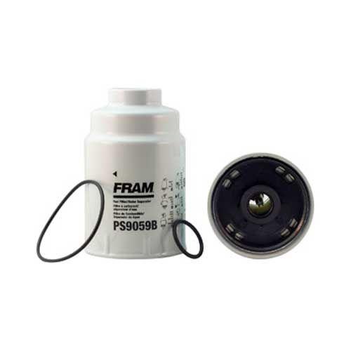

and what do you know, since the subject matter changed to Fram, Fram makes that spinon filter that goes underneath the latest greatest Rams truck... a FRAM PS11937 http://www.fram.com/parts-search/PS...gJxAGhAAgGJ4CMATAOwCcWAdgK4A2dmtDT9jz7brDAukA
I wonder if Fram actually makes this filter.

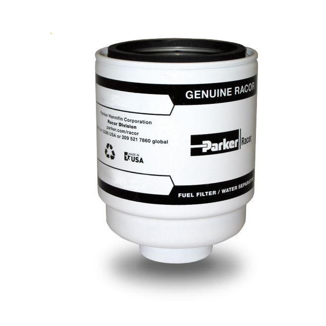

It's $20 more than the mopar equivalent on Amazon. Might just be a rebranded Racor?
Newsa, as far as I know Fram is a manufacturer , not a relabeller.
