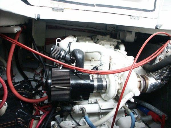

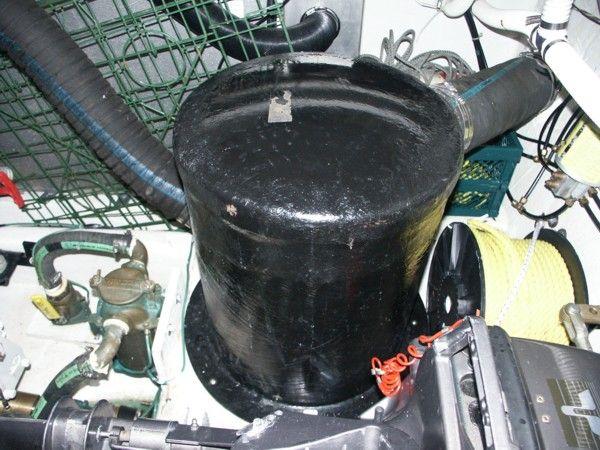

A marinized 4BT would be to heavy for a small boat. It would be similar to having two or three big guys standing at the very rear of the boat all the time. I had two in my 3388 Bayliner that we owned for 19 years. Snoking
These aqua lift muffles kept them quiet.
