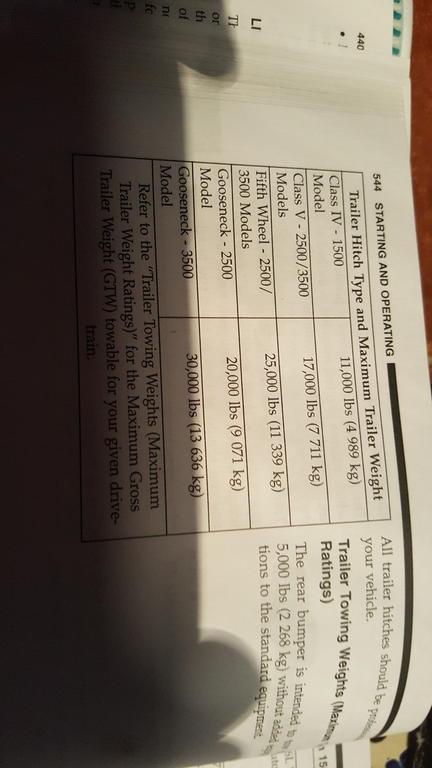

My 2013 manual says 17,000 lbs for class V. Pg. 544.
