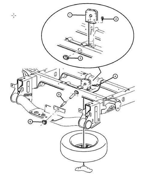

Just another thought................ I am planning on doing a similar thing, but with a bronco spare tire carrier.
Best info I have:
I was wondering if anybody out there knows how the spare tire mount thingy assembly mounts undr our trucks. A buddy and I would like to mount them under our travel trailers to hold spare tires.
I'm hoping it's as easy as mounting it against a flat surface or square or C channel steel stock. We'd just get a couple off trucks in a salvage yard.
Thanks,
Scott
Thanks for the info everybody.
I wanted to stick with a Dodge assembly so I wouldn't have to carry a separate crank handle.
