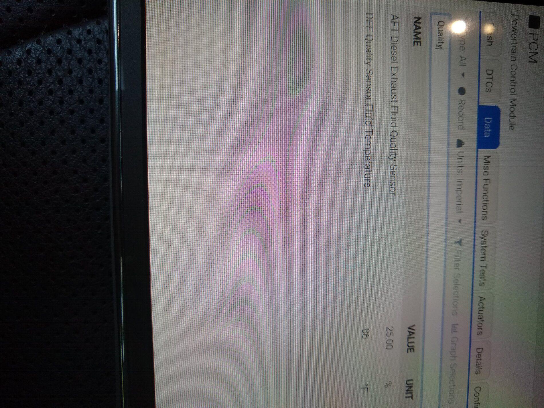

So I started the test last night. The DEF was showing about 2/3 so I'm not positive on the actual level in the tank. I added 1 gallon of distilled water and it took the concentration from 32% to 25%. Probably not scientific, but the DEF dosing rate at idle was 9-11 g/hr before when it was at 32%, and 11-13 g/hr at 25%. At first glance it would appear that it just upped the dosing rate to compensate for the diluted DEF. I have not been driving the truck much so it will take a while to get any feedback on using the diluted mixture. I will also bring the refractometer home from school and double check the accuracy of the in tank sensor. It does appear to be fairly accurate as I first put in a little less than 1/2 gallon, went around the block and it was at 30%.
At certain conditions the Rate increases it will level off to normal, I mentioned it earlier that the Ammonia Smell would increase at 1st startup it levels off, but if you leave it run at Idle the smell will return its harmless....MY guess is its the increase in H mixing with the NOx ( @ colder ETs) over the years I kept track of usage its not measurable , in other words it was like 1 GP 1000 miles. DD and 1 GP 400 miles Towing, additional.
Sag2 thank for the Update and Info.
Yeah. Dosing will increase up to a point. Increased dosing likely doesn't hurt it for a tank or 2.
But dosing will only increase to a point .... To the programmed limit, i would think
