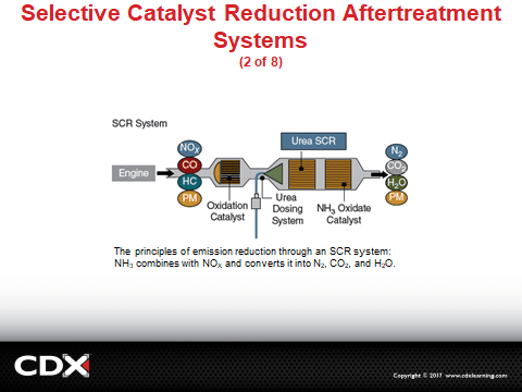

Here is a simple description that I use for my students. It really does not get any more complex (well the chemistry does, but the result is the same) than this. This is one of the slides I use from my textbook from CDX Publications, Light Vehicle Diesel Engines by Gus Wright. ISBN-978-1-284-14509-0. The bottom line is you need enough Urea which is converted to Ammonia to react with the NOx to convert it into the harmless gasses coming out of the tailpipe. If you don't have enough to do the chemical reaction all the NOx will not be converted and some will still come out as NOx. I'm going to make another assumption that under lower load conditions the DEF injector can deliver enough to make the chemical reaction, but under heavy loads where NOx is really high, if the DEF concentration gets too low the complete conversion will not take place. It is simple chemistry.
So Sag2 Your teaching is misleading and incorrect, If You would like, come to Minnesota at Your expense I will provide the Fuel analyzer, Your just passing on info without...... First testing the info, You still have NOT provide any info other then what read, YOU have NOT put forth any effort other than non-tested info.
Also YOU do NOT provide any NOx levels prior and after the SCR or the tail Pipe Statics... If you support loop hole testing, that's the diagram I would recommend, I would like to attended your classroom...I won't be so easily fooled as students. CA is one of that last States I care to pay to visit. I may be compelled if you accept the challenge.
