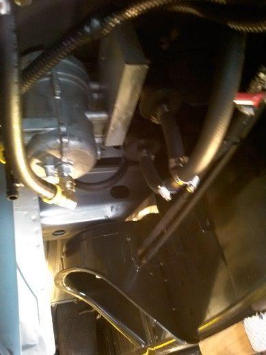

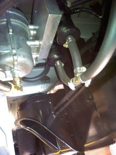

Also You can thank this truck for the Fuel/heater Flashes, TSBs. When the in tank Module failed I replaced the Module with OE and install the auxiliary filtration system I checked the filter heating elements manualy and they would NOT work June 13 , I notified Ram of this and FCA investigated and found it to be software related undetected and turned off....If it was not for this truck the fix would have NOT BEEN available in NOV 13 for Recall and turn on...If you use the search You will see I shared this problem and Fix Here at the TDR DEC 1 2013 way before the TSB or Recall was released. 1000s of owners were able to get this fix before winter. 2013-14 was extremely cold in Midwest and south east, it was -18 Here Blaine MN Dec 6 2013.
