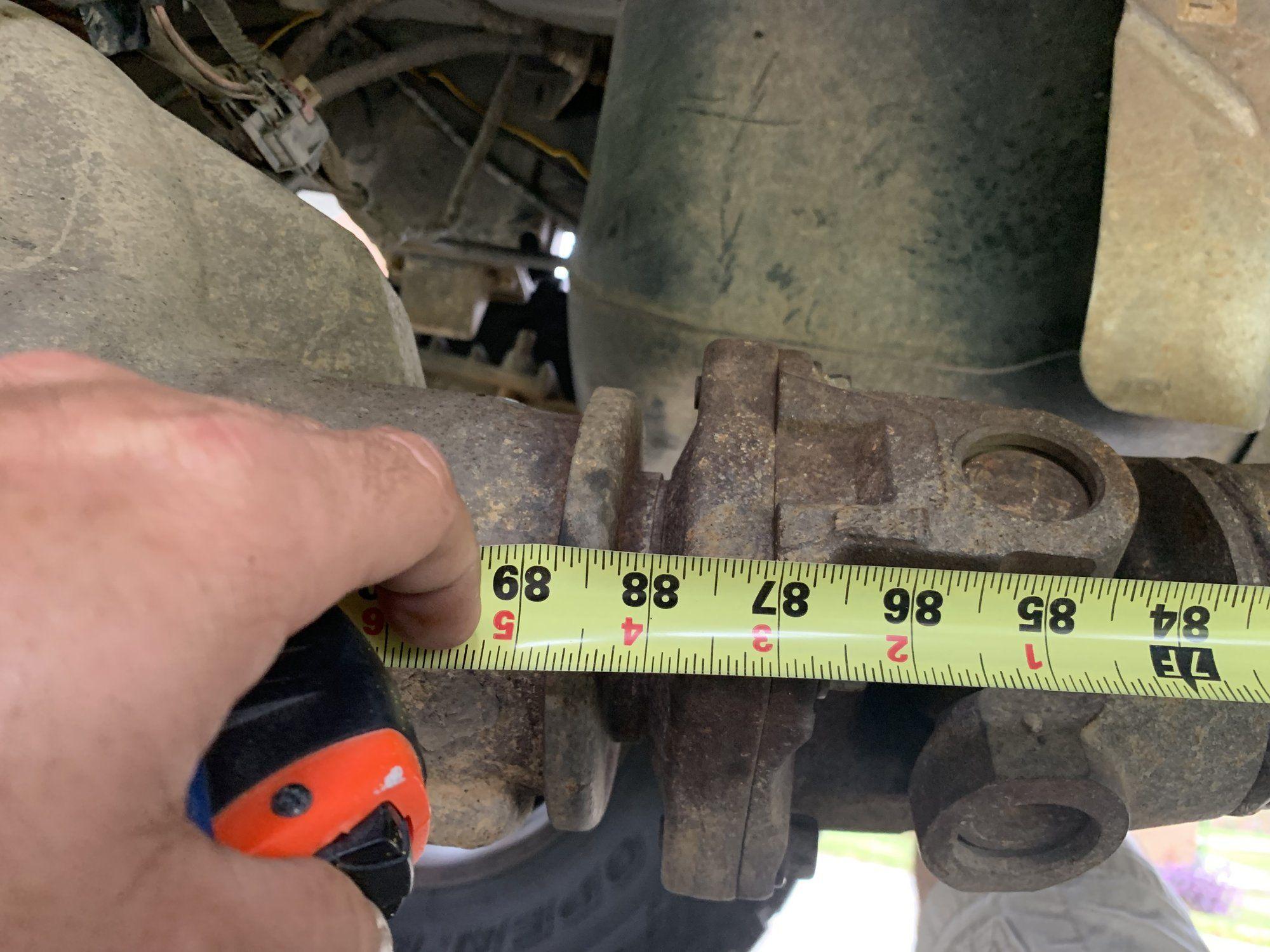

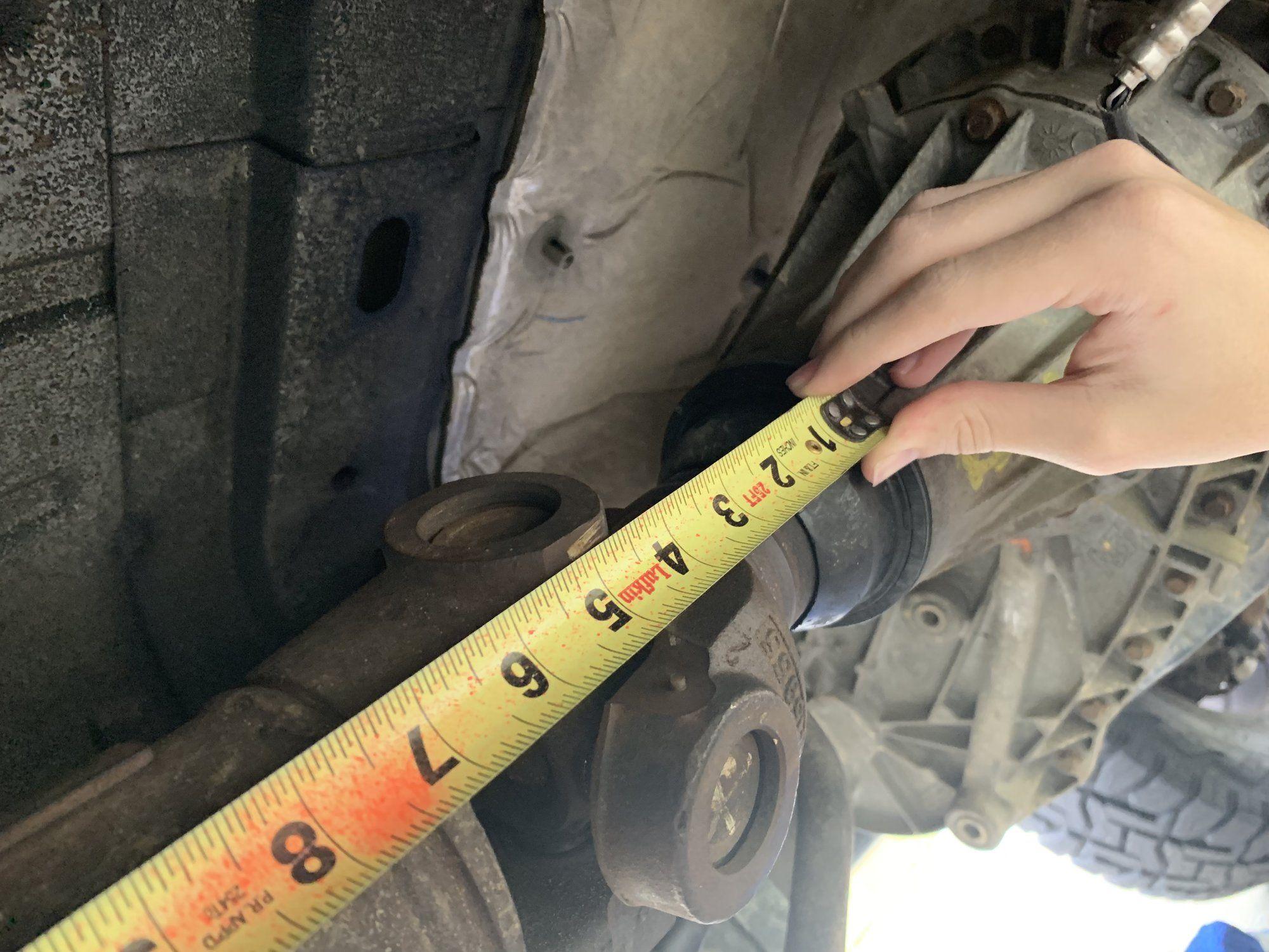

Sorry for bringing up a old thread but need some help, the 1 piece is so confusing to me on which one to get, I have a 2006 Dodge Ram 1500 4x4 auto 5.7 mega cab with 37” tires and a 6” lift. I sent driveshaft specialist a email which used to be dog diesel with the measurement and this is what they said
“I am sorry but with the set up you have this driveshaft is too long for a single piece conversion.
At this length with the gas motor this driveshaft will vibrate at higher speeds.”
-Craig
So am I not able to go to a 1 piece drive shaft? Here are the pics I took of the measurements. If anyone can help I would appreciate it thanks!
Yeah, I think 84" is the maximum they will do with the 5" aluminum shaft.
So how are people upgrading to a 1 piece? All mega cabs have a length of around 87” even the 08, my brother has a 08 mega cab that came with a stock 1 piece and his measure 87” what makes a gasser different from a diesel to where you can’t run such a long length? Tired of the vibration when taking off and I do have shims in the carrier bearing. Any other suggestions I hate this 2 piece
So how are people upgrading to a 1 piece...what makes a gasser different from a diesel to where you can’t run such a long length?

Check the length from ujoint to ujoint and make sure it is 84" or less, if it is longer they won't build the shaft as there is a maximum length they will not exceed. If you want to fix the source of the vibe problems you need to lose the rear flange drive and go to a u clamp like the GM's use
