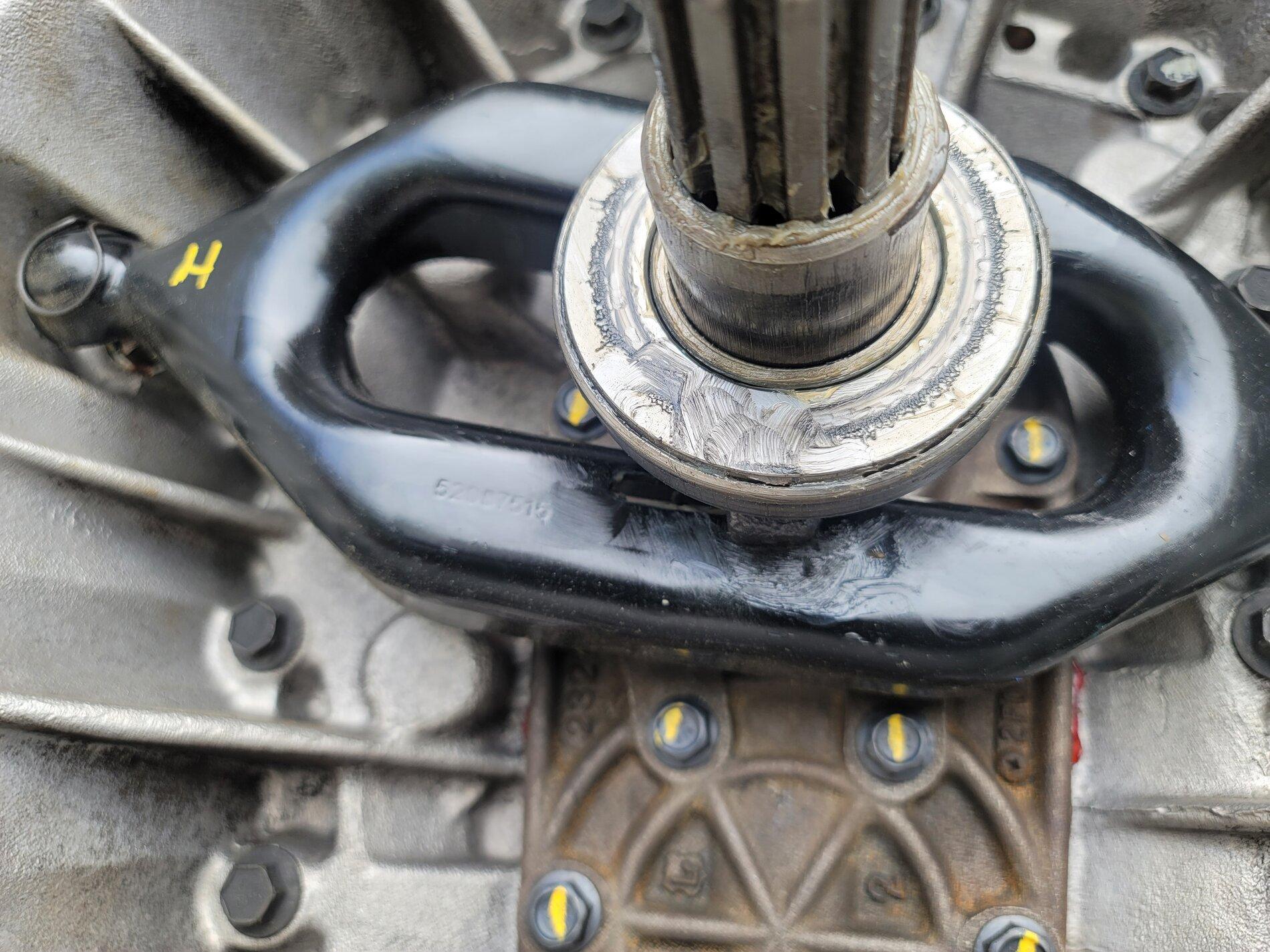

Timken Clutch Release bearing, NV5600

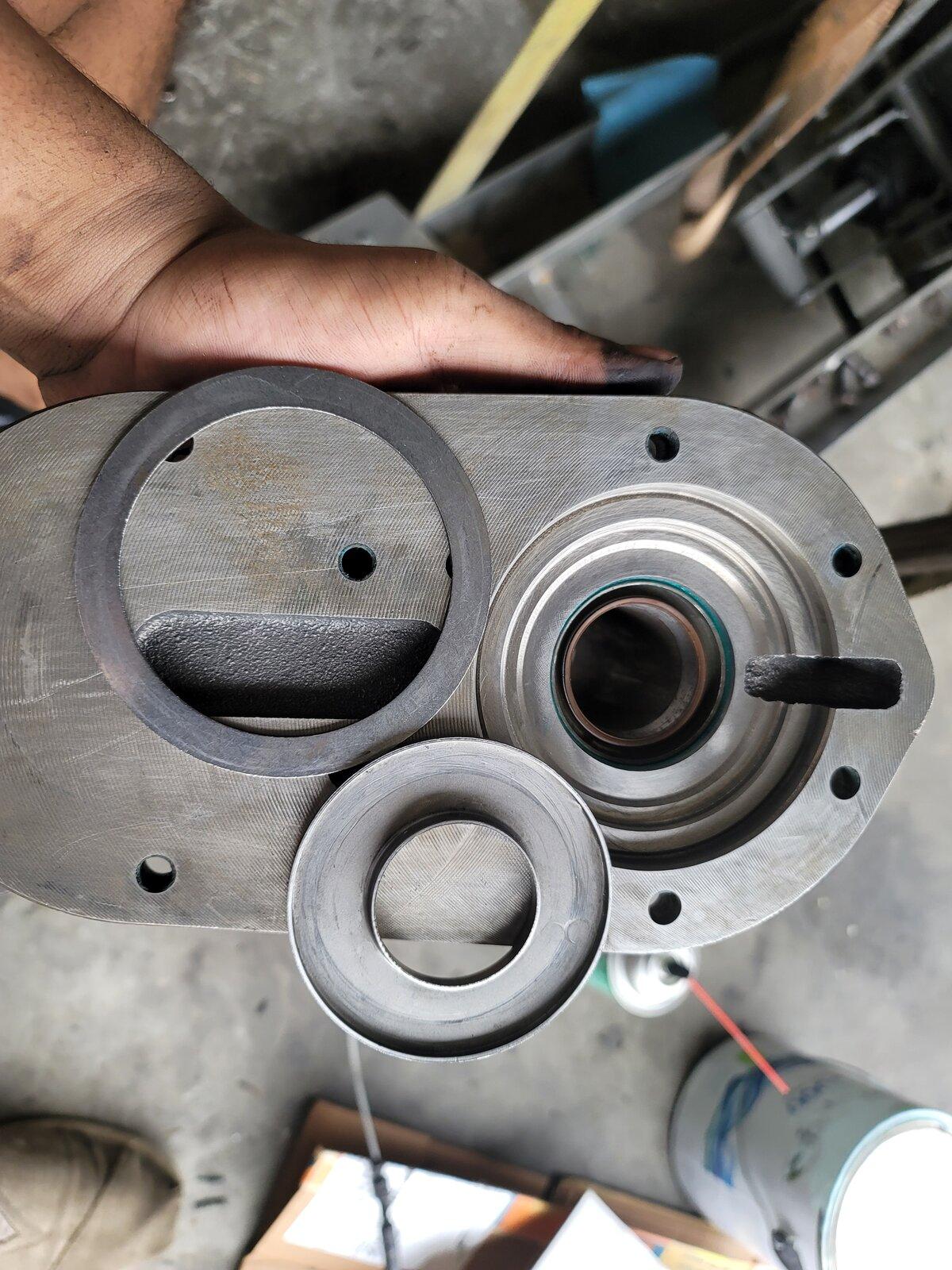

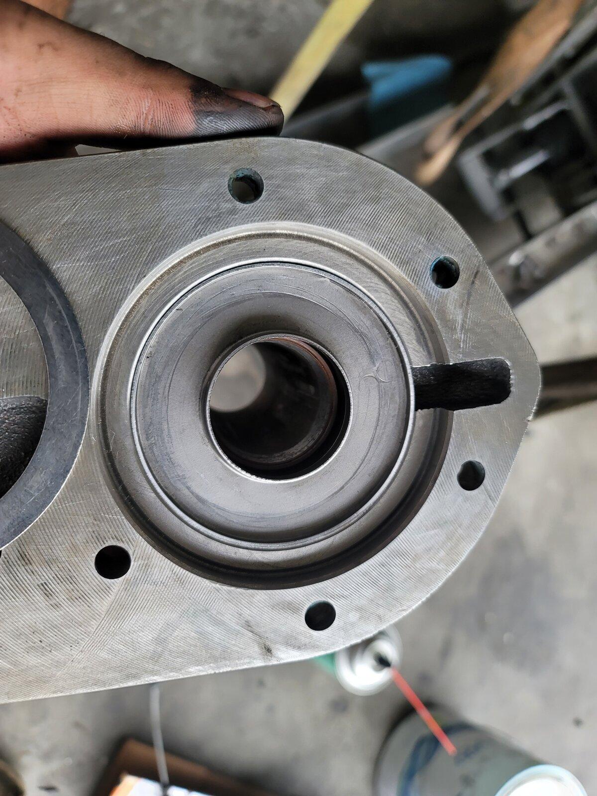

the countershaft oil guide and any shims made it back in right

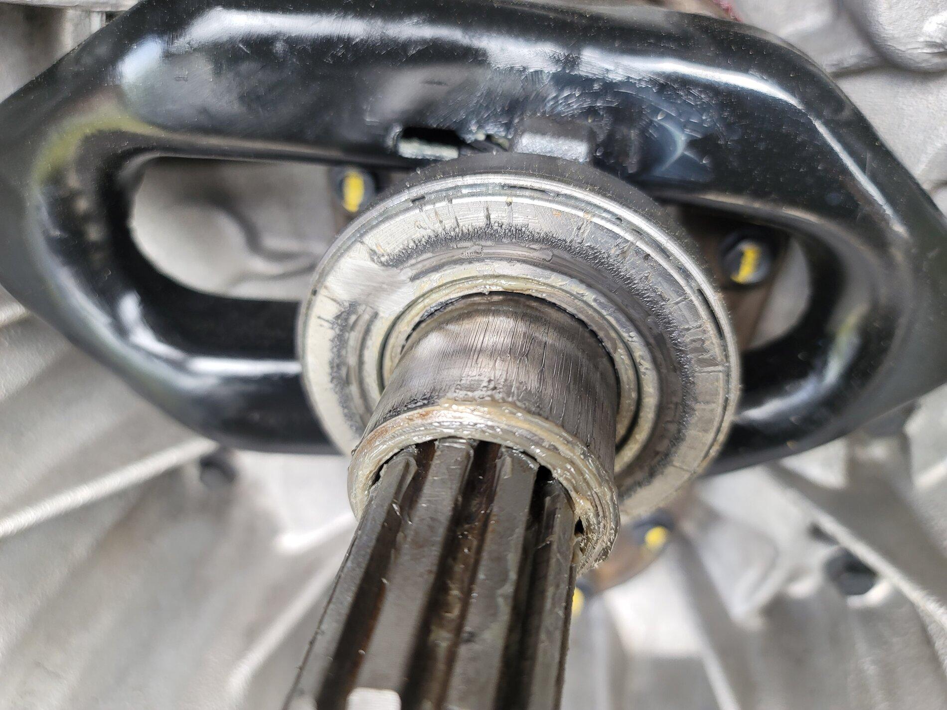

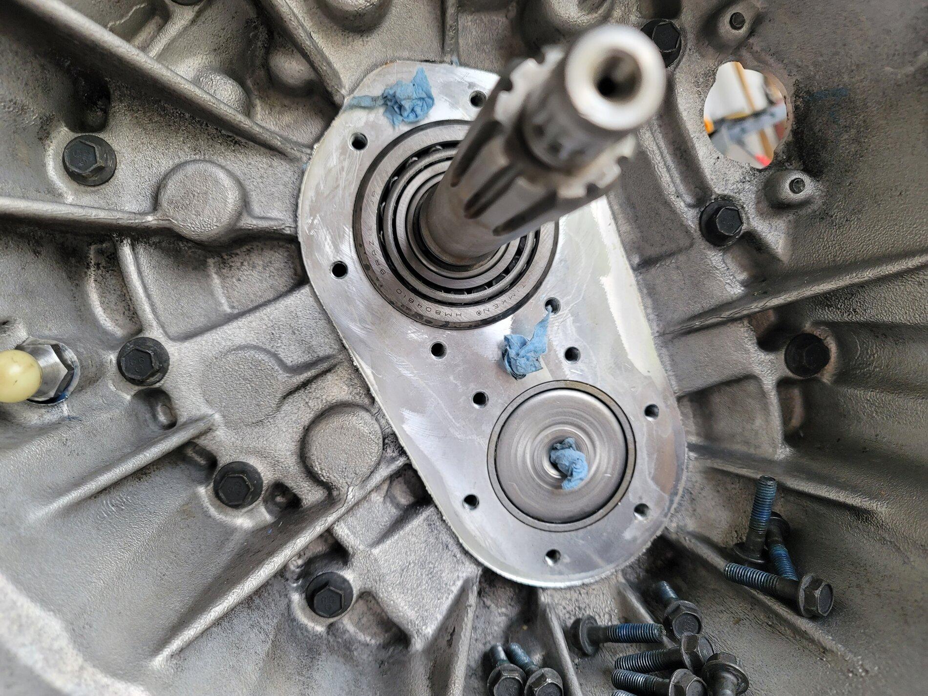

One shim on the main shaft no shims on the counter, counter oil guide was not removed. pics below of my clean up and prep.

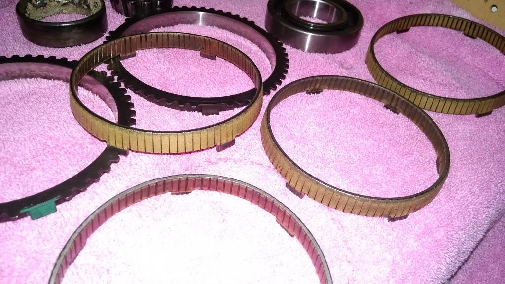

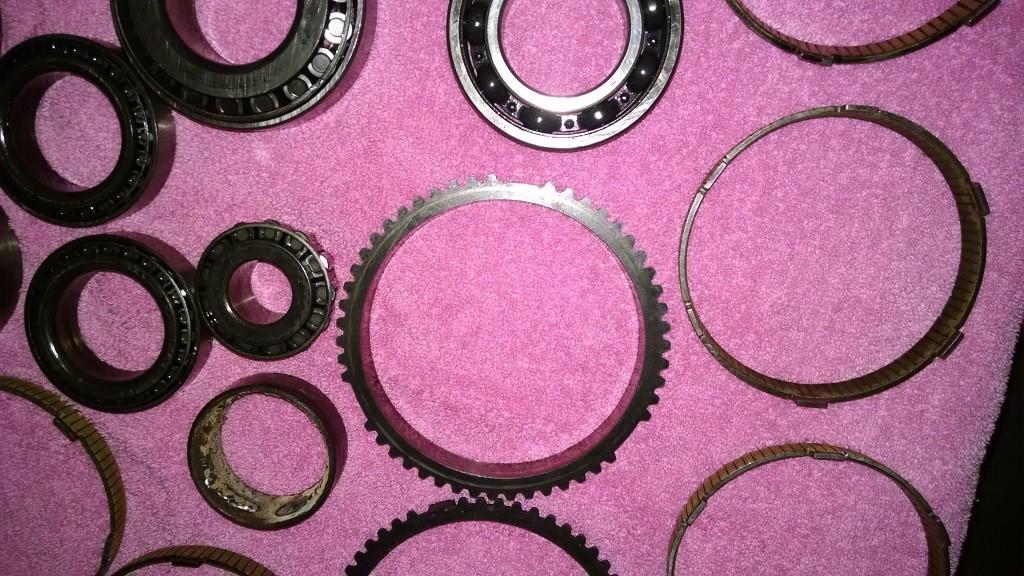

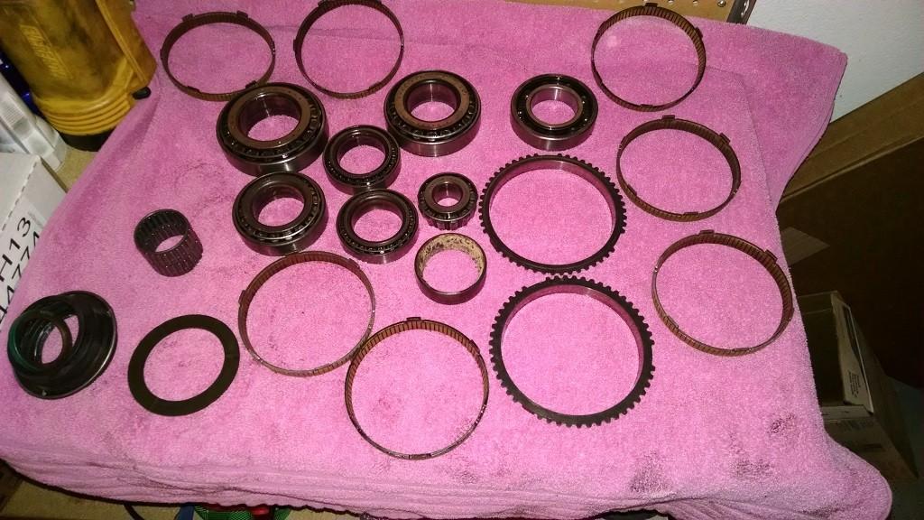

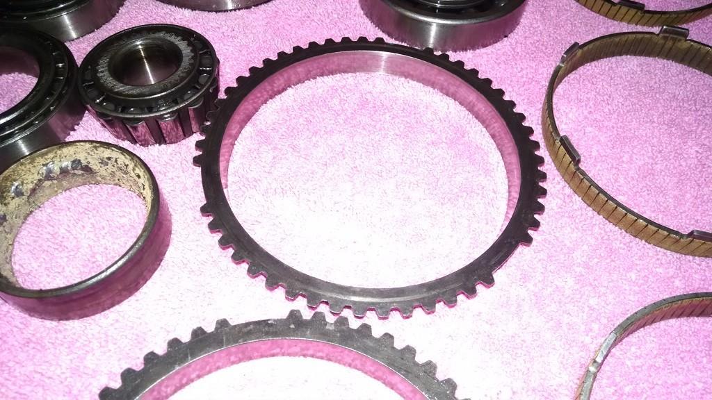

Because of the night and day improvement in shifting after the rebuild I highly recommend it. Why fight a worn out transmission? Other than being cold this indicates the syncro for the notchy gear is worn out and not providing enough friction. I recall the transmission being louder after the rebuild. However it shifted way better as long as you kept in mind it's a slow shifter and will drop in when it's ready. The heavier clutch slowed shifting down on the worn syncros.
This is what the replaced worn parts looked like in mine. "Flat" means the syncro is rubbing somewhere else aside of the friction basically having reached it's wear limiter and isn't providing much friction to change speed to shift. I also had the case machined for the now common rear bearing lube mod. They had to weld one bearing race to get it free, that be the nasty looking one. They also flipped the reverse over so it had a non chewed up part.

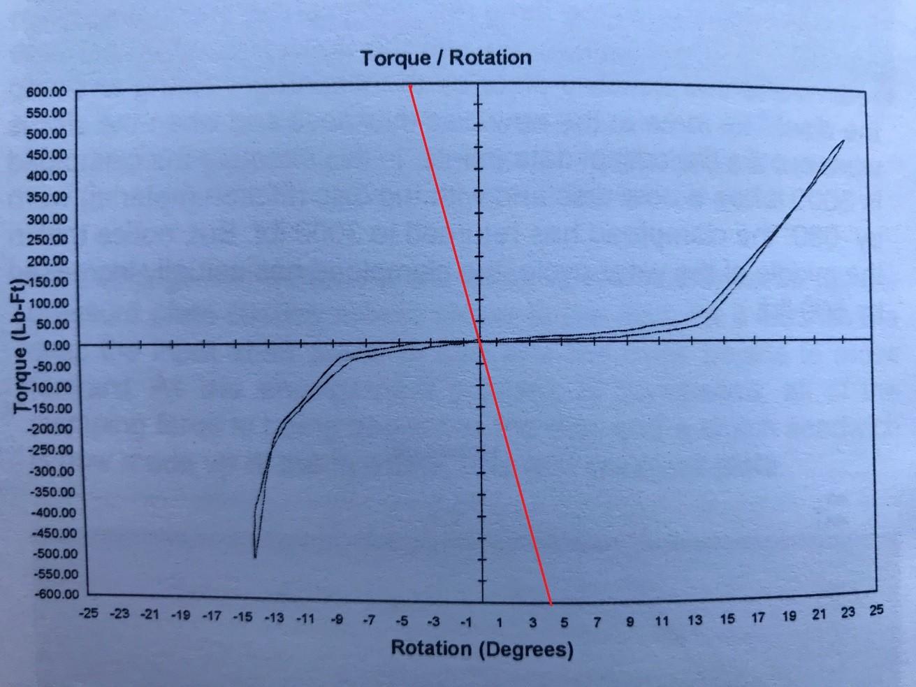

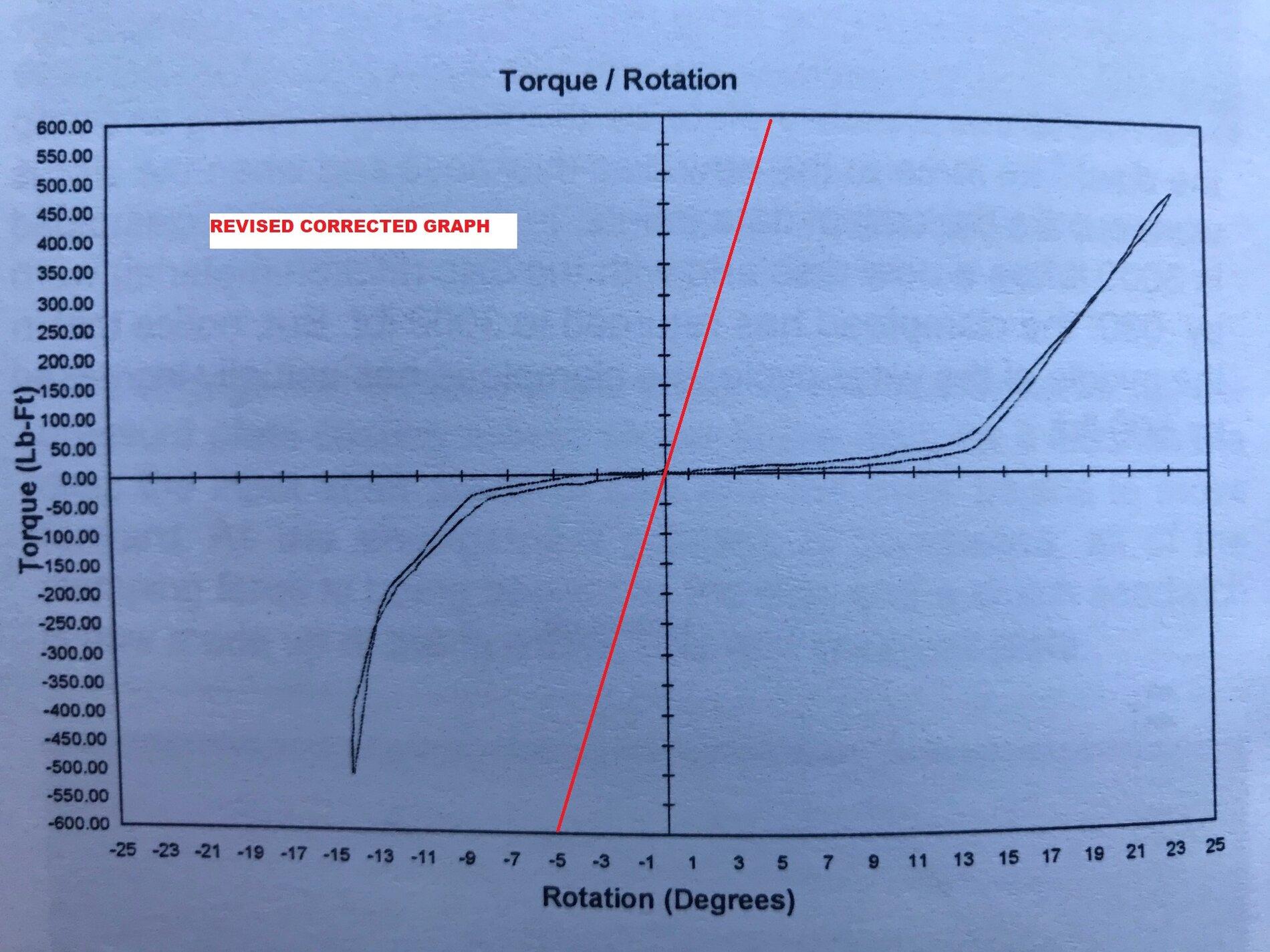

If you have old TDR copies go find Issue 63, 2009 pages 40-44 but look at page 42 bottom right column the torsion damper curve.
That is an actual clutch disc torsion damper curve of the OE disc for an NV5600 and in fact I'm pretty sure it's the disc from my personal truck. The disc is clamped in the machine and the input shaft is rotated. The computer plots degrees of rotation vs torque required to rotate the hub INSIDE the damper. Notice the progressive curve, it doesn't ramp up linearly and it has a predamper section about 5 degrees or so drive and coast then it gets into the get er done mode and it ramps up to 500 ft-lbs at 23 degrees of rotation.
This was the adopted, approved and supplied torsion damper design. Had to meet torque capacity, durability and most importantly provide an approvable reduction in gear noise. That's the Genie they try to put IN the bottle and keep it there. A tough nut to crack.
Same illustration as in Issue 63 but now I took artistic license and made a second graph in red. Less than (estimated) 4-5 degrees rotation and you're in the 500 ft-lb range that needed over 20 degrees of travel bit without a predamper, noise reduction is not the characteristic of this type disc brute strength, durability under stress and simplicity.

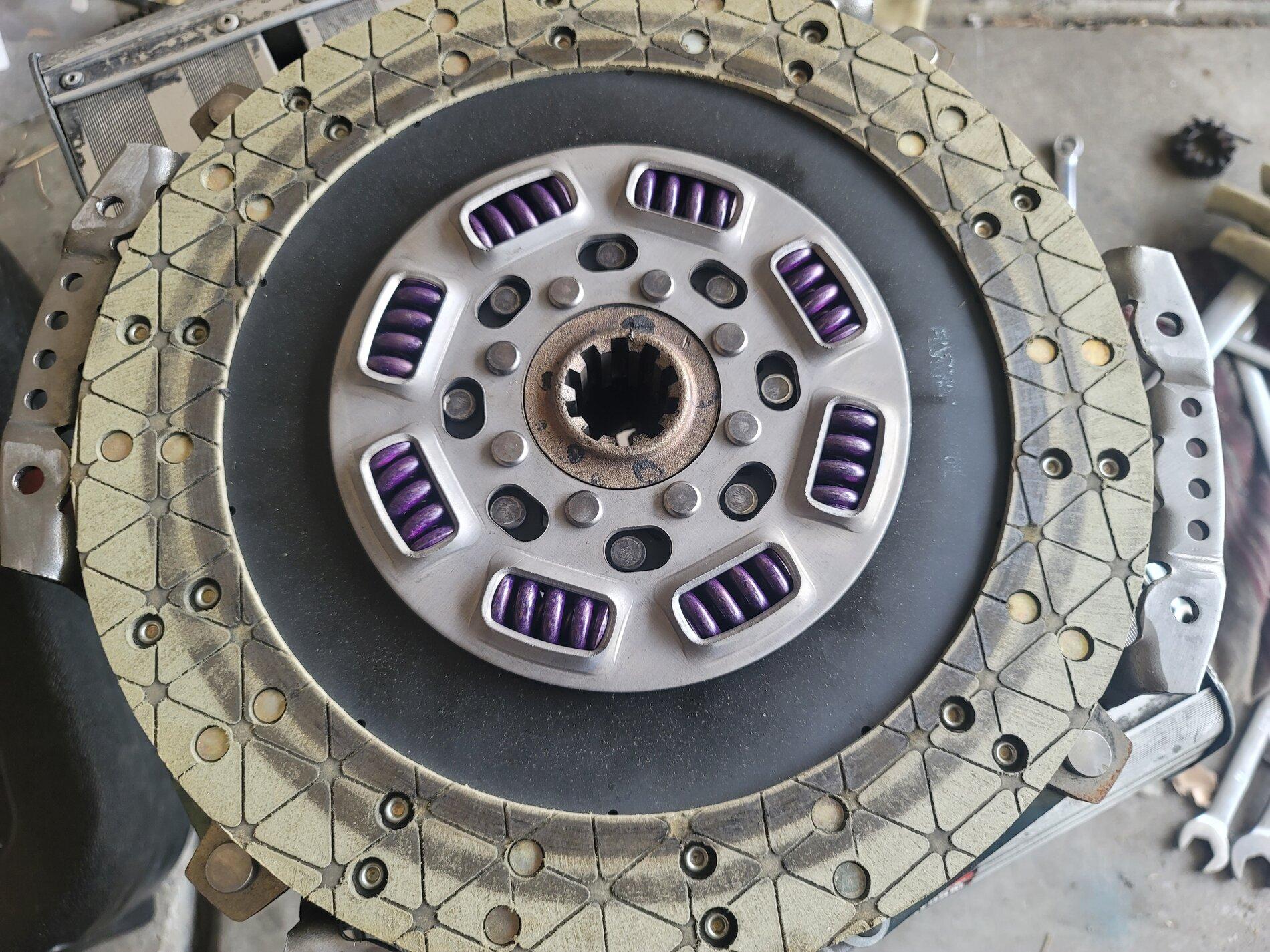

Can this 8 or 16 spring disc be built or the design modified to improve it's noise dampening traits, only slightly and usually with one of the springs being exchanged for a very light spring rate and the internal window of the damper modified to permit this "modification" to the crude strong parent disc.

CORRECTION TO MY PREVIOUS POST.
Massive brain toot. I put the red line in the wrong quadrants. This pic shows red line in the correct quadrants. No change to performance etc just correcting a I have other projects in mind today oops.
MY ERROR
Gary
I'm skeptical of questioning the manufacturing and testing of this clutch but I'll shoot them an email Monday asking if they're willing to test it paired with their pressure plate and send me the results. I can't do much else otherwise with it once the trans is pulled besides look at it.
Am I correct in assuming that you don't think this clutch has the right springs or spring rate to dampen vibrations?
This isn't a sled pulling clutch or competition dual disk; Just a smooth engagement, higher holding capacity, longer lasting Kevlar clutch.
Do you understand why I'm skeptical? I'm not saying a manufacture cant mess up but this clutch was designed around being quiet and smooth, and it's everything but that. Something must be critically wrong why that is and I just don't see why it's design would come into question.
But hey I've eaten my words before, and I've been wrong on many occasions. You'll be the first to know if I get any data or test results back. Maybe data test sheets should be sent with clutches from manufactures like alternators and starters, it'd probably help in instances like these.
The pressure plate is only involved with a clean release, smooth engagement, good pedal feedback and enough clamp load to prevent slippage per the design.
The disc has roles in smooth engagement or heading towards harsh depending on the facing type, clean release, torque capacity, service life and the issue you're presenting the discs ability to mitigate gear noise if that is the choice.
Look at a solid hub disc for pulling etc. No moving parts, no damper just twist the input shaft. ZERO filtering of engine pulsations you get all the gear noise possible.
8 spring, 16 spring and their variants. Need to see the disc and review the description to see if its super crude and strong or has a tiny bit of pre damper type filtering capability in it.
OE design disc and damper. This is the one that was approved and supplied to the vehicle mfgr. It's a combination of strength, drivability, torsion damper to minimize gear noise, service life and price.
But Diesel pick up truck owners didn't leave stuff alone, power gets added, new failure modes found like a torsion damper getting beat to crap facings burned up and then the aftermarket unveils their offerings.
You're the customer I don't think asking for a torsion damper curve of the exact disc design that you bought is beyond a reasonable request for tech support.

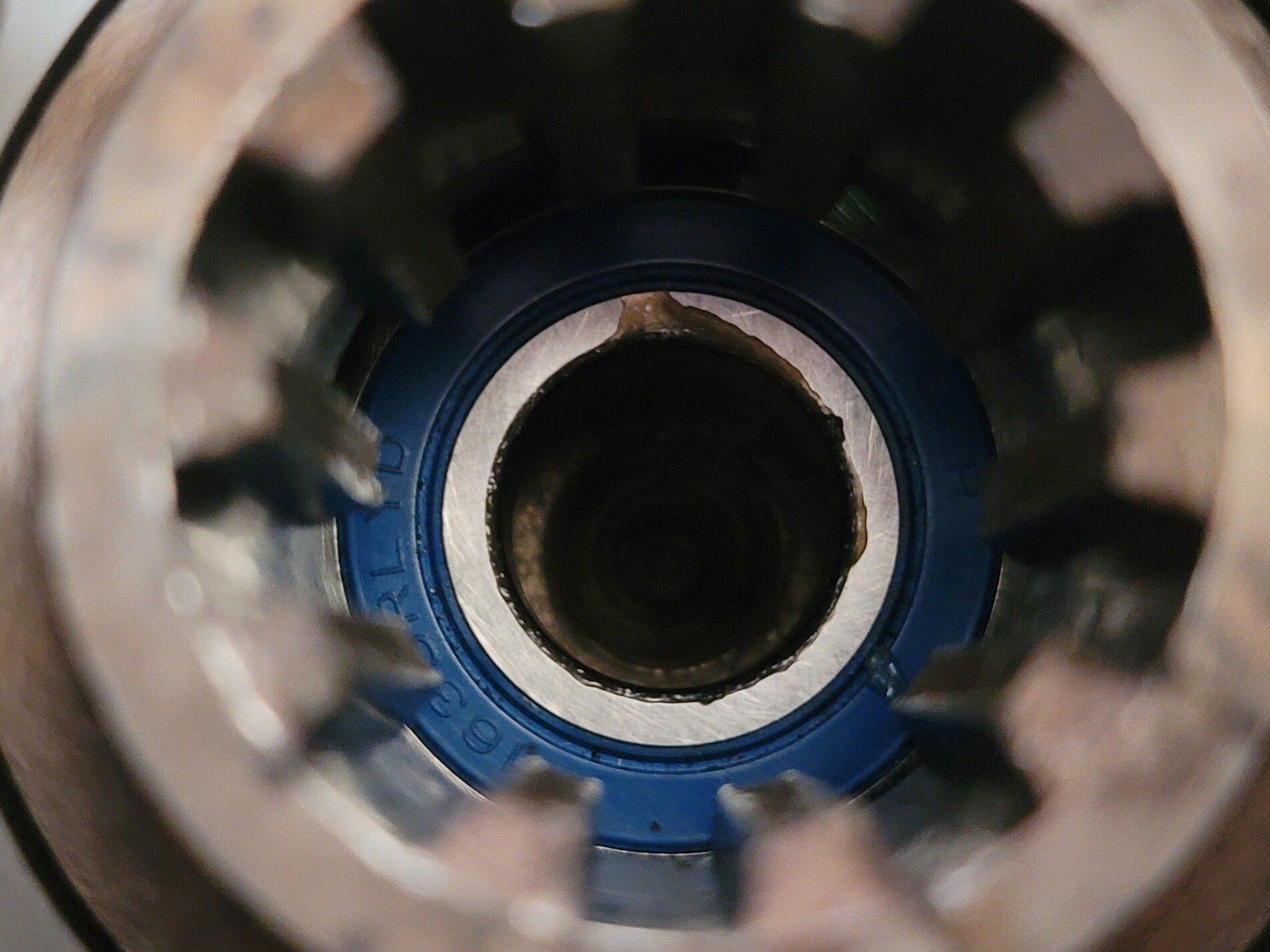

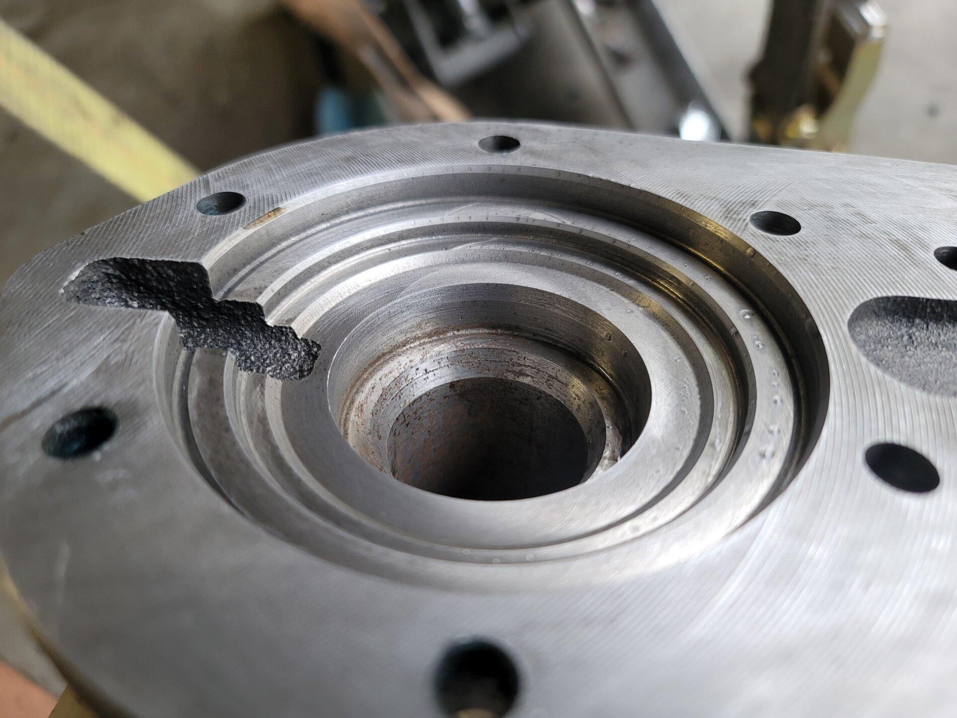

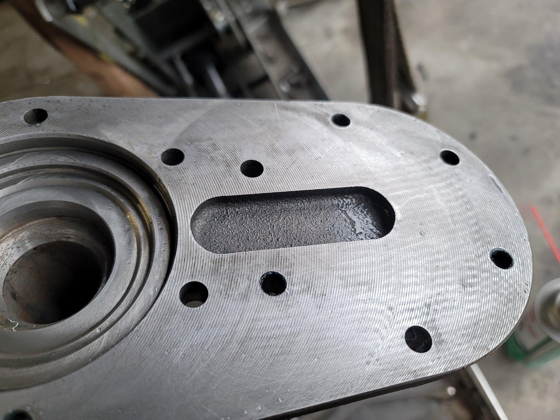

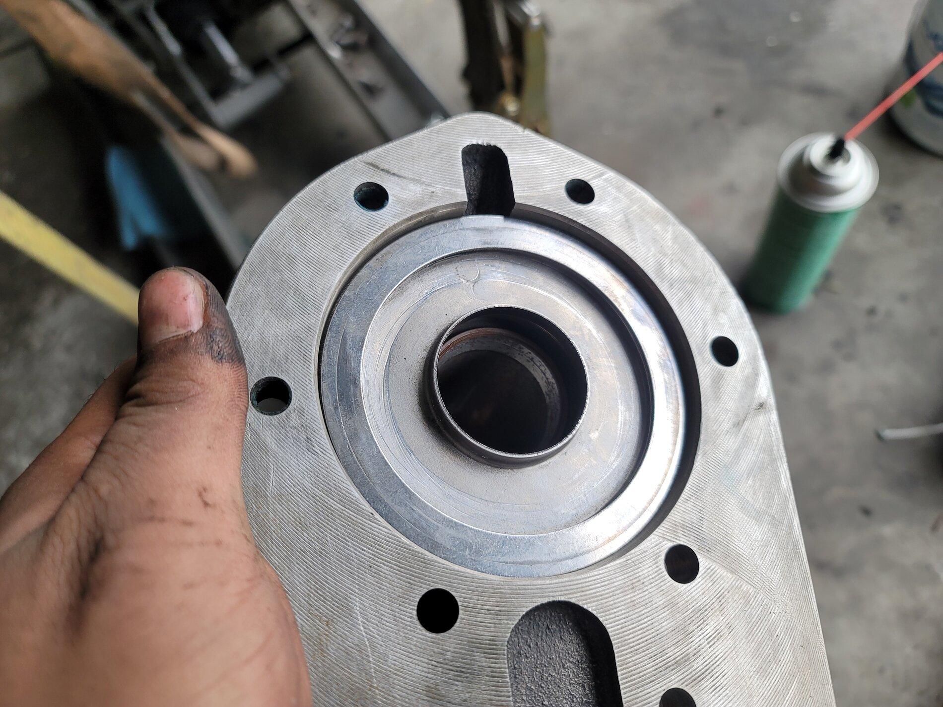

I assume the oil guide/slinger is a snug fit in the seal retainer. It also looks like there is very little clearance between it and the input shaft bearing. Is it possible it is not fully bottomed out/seated in the retainer and is making contact with the input shaft bearing? Other than that possibility, I don't see anything wrong with your seal install, very professional, you are hired Lol.
I thought about that, it was sitting nice and snug on the retainer, solid hits all around. The shim pushes up against the bearing race. During assembly I would expect the torque procedure to fully seat anything left undone given how tight the clearances are.

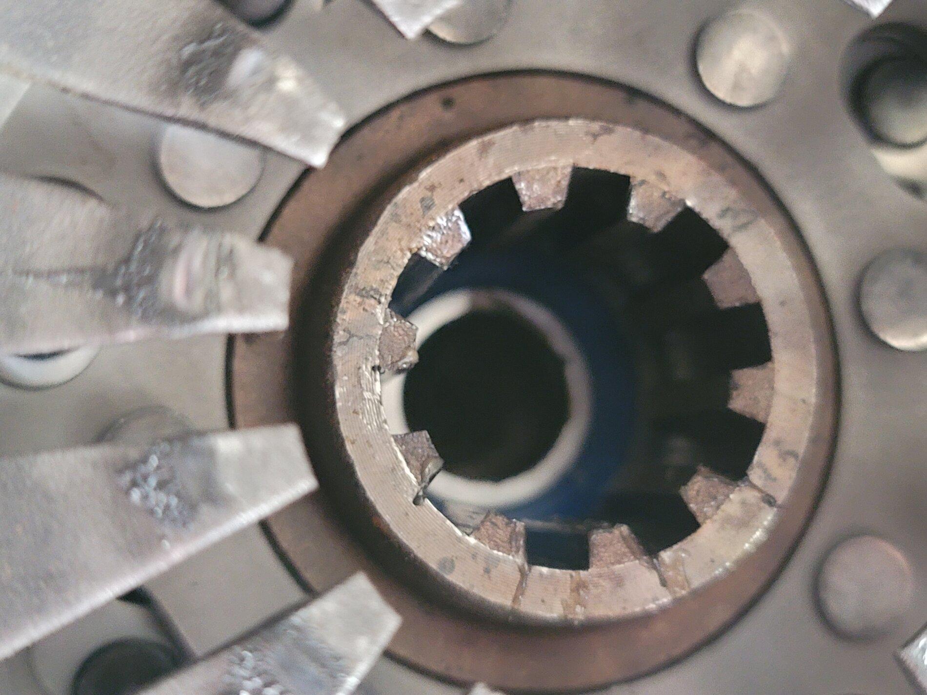

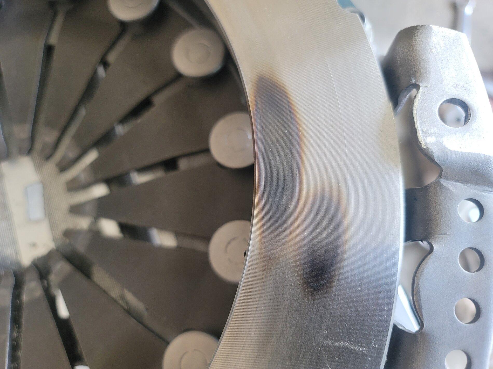

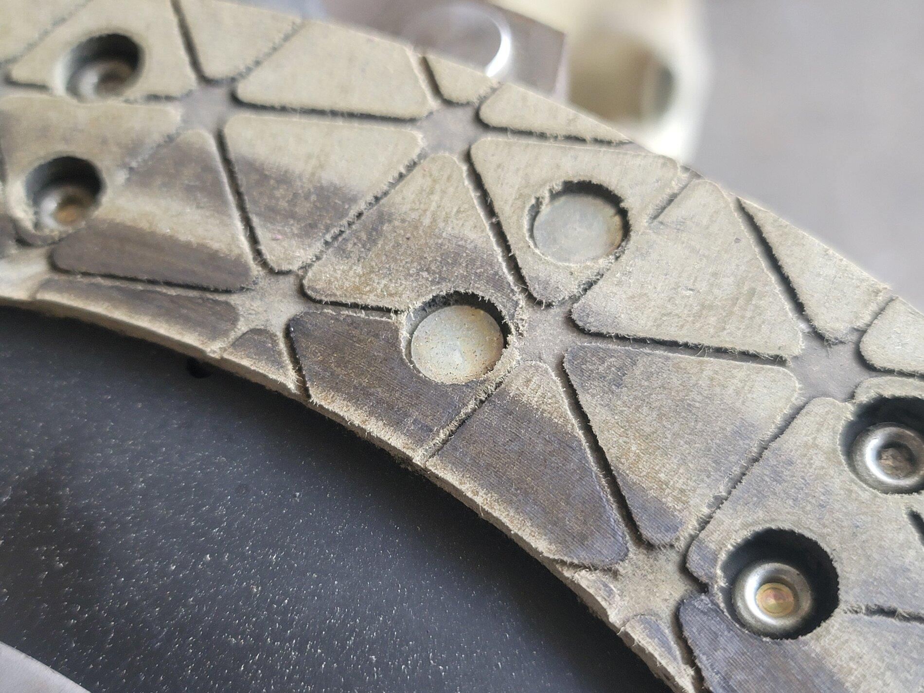

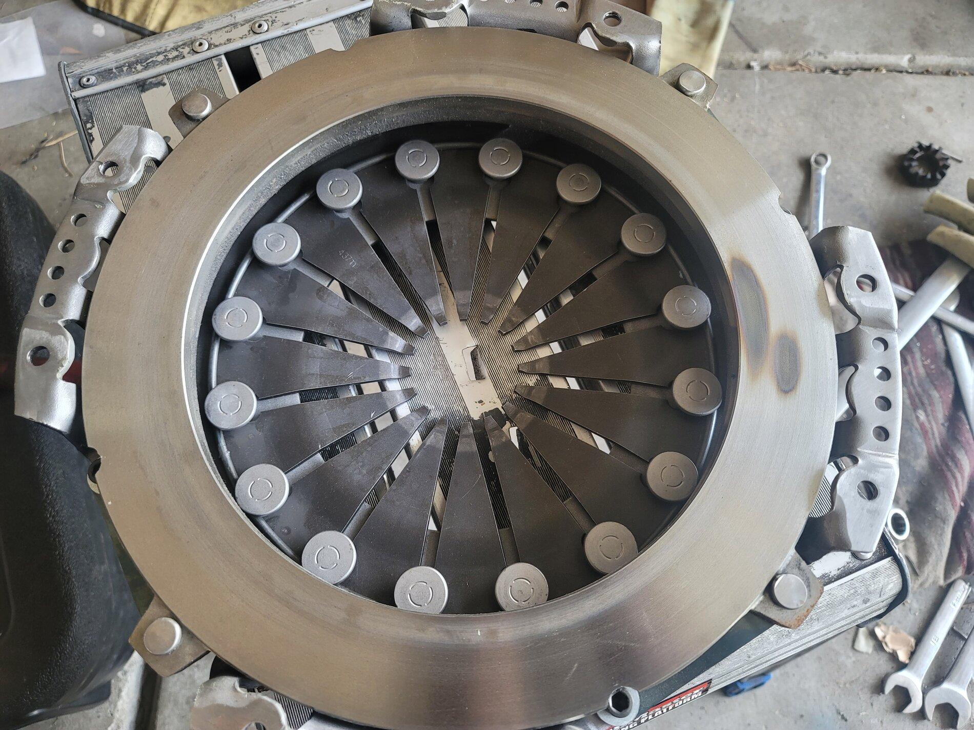

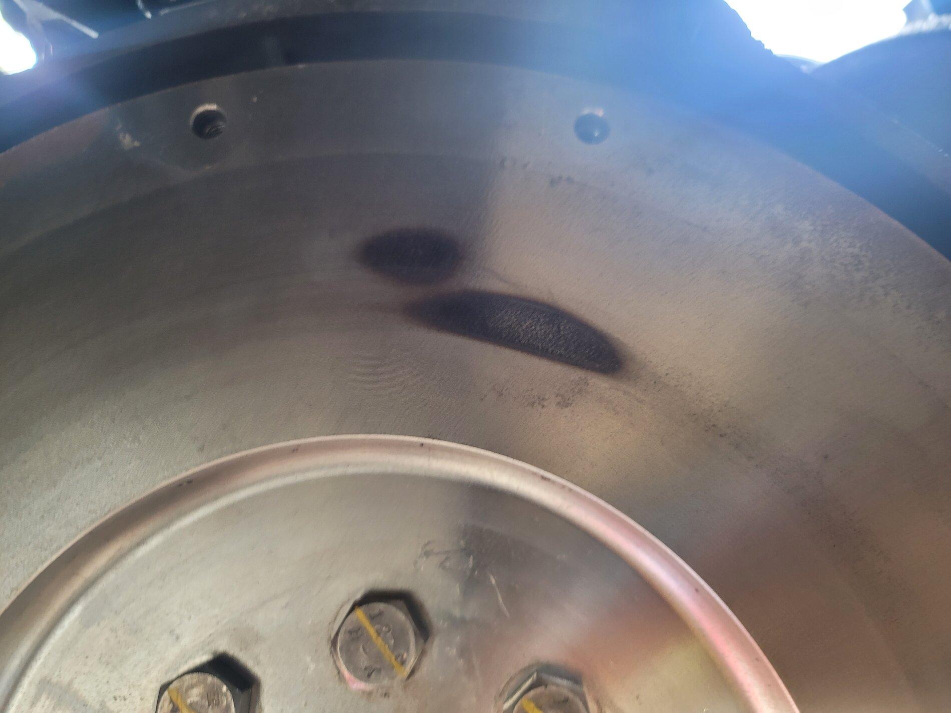

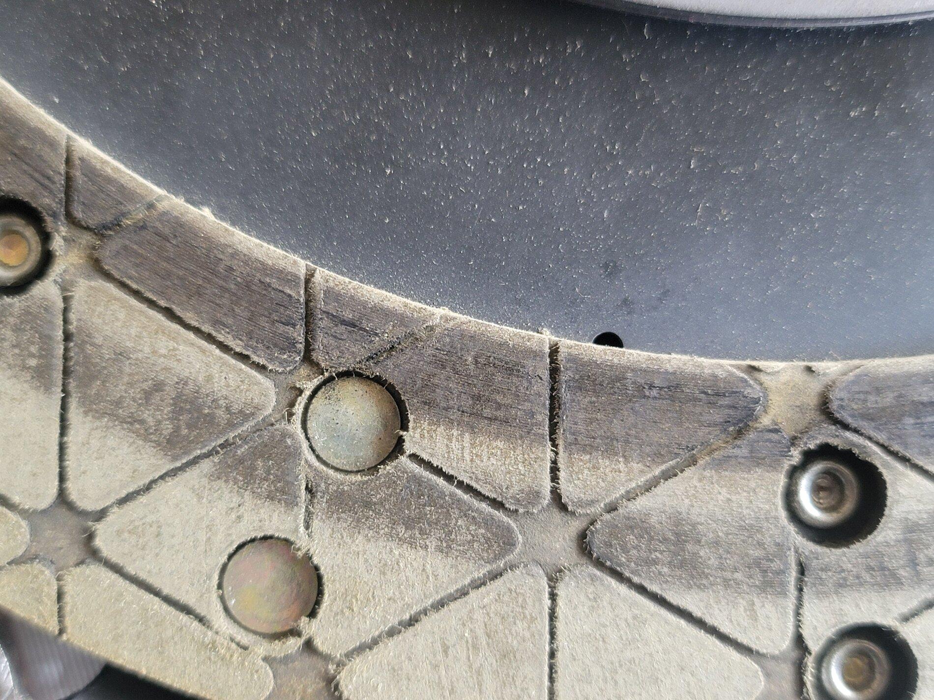

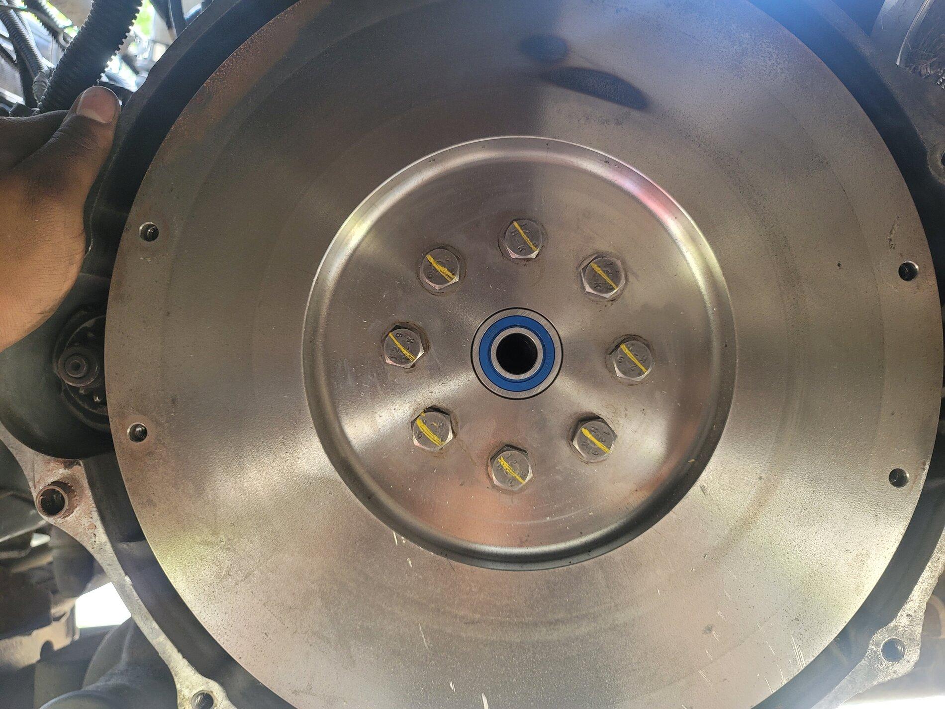

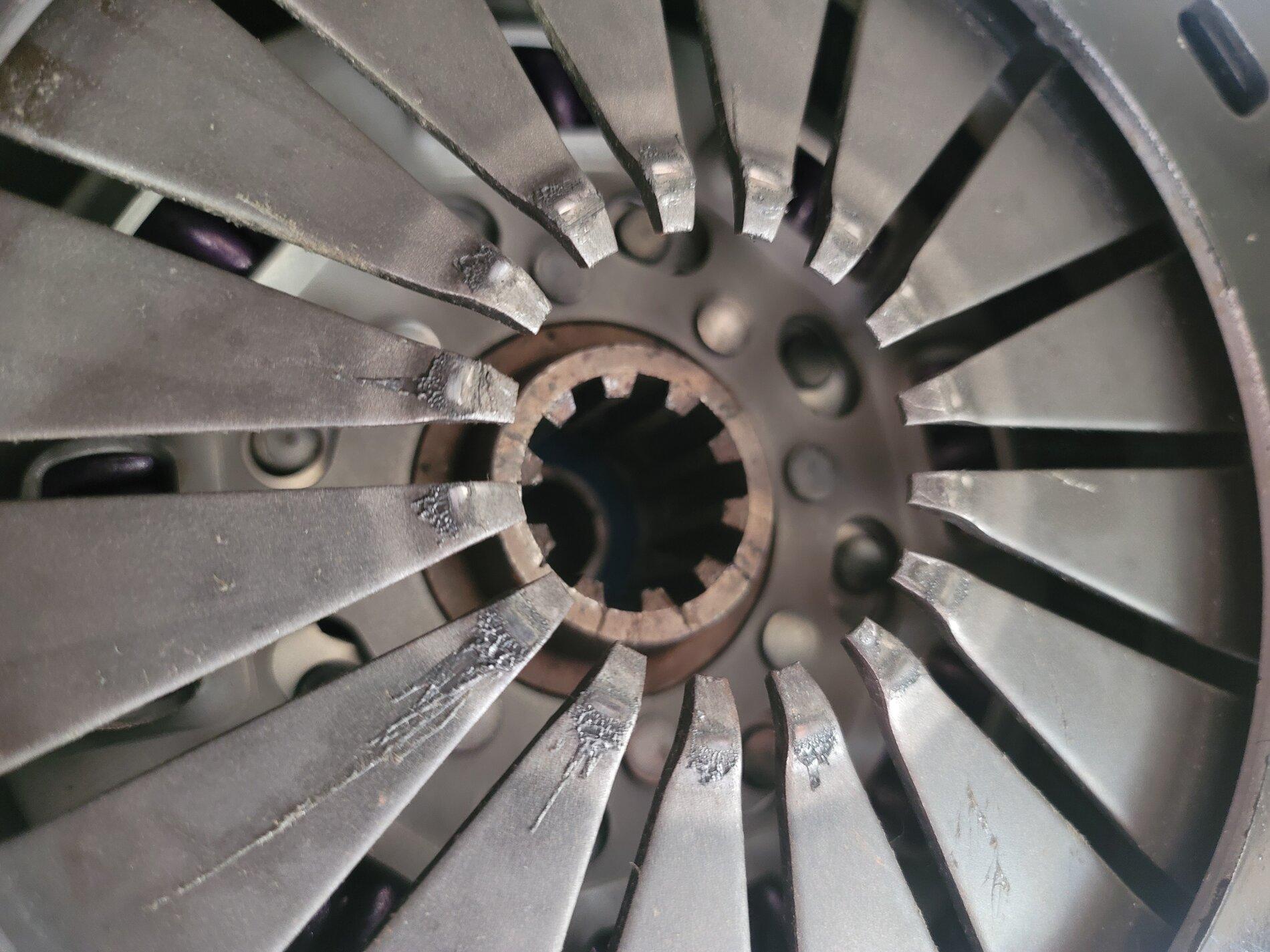

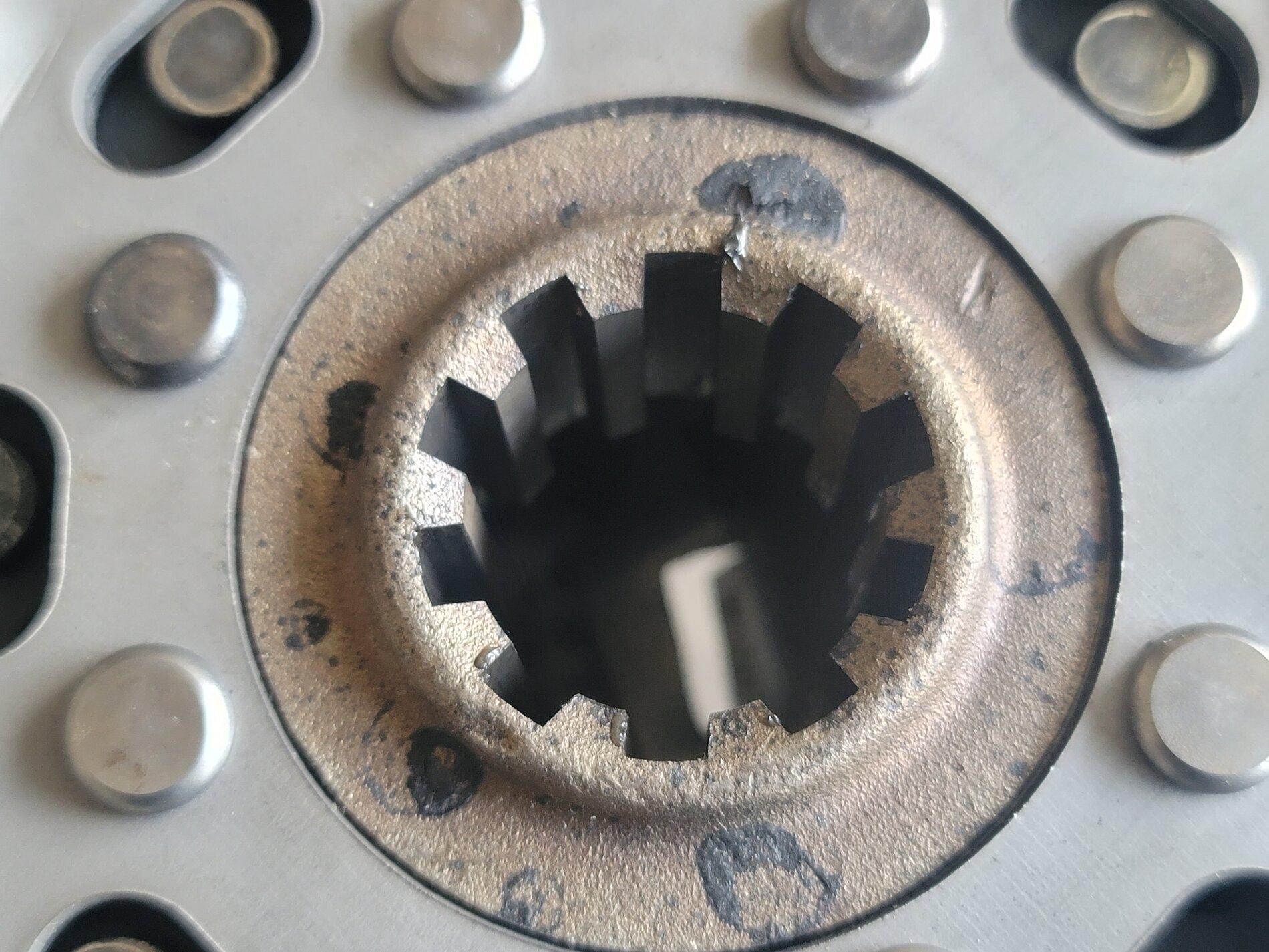

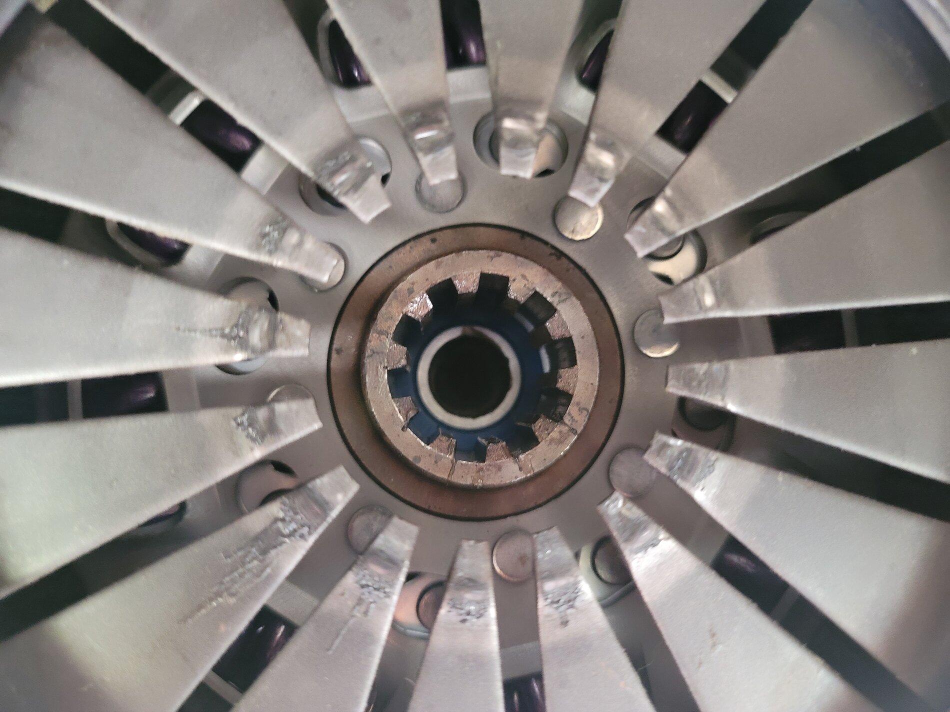

Trans pulled, clutch removed. Assembly was as it should be, Disc was not flipped, nor was the fork. Transmission did not get up to temp on the 4 test drives around my block up to 3rd gear.
Before you jump on the hot spot; keep in mind I was holding the clutch in listening for this noise repeatedly. I don't think that its the sole cause. Here is a link again to the video for the grinding noise, ill be getting in contact with Phoenix Friction Monday morning with these pictures.
Thoughts?
