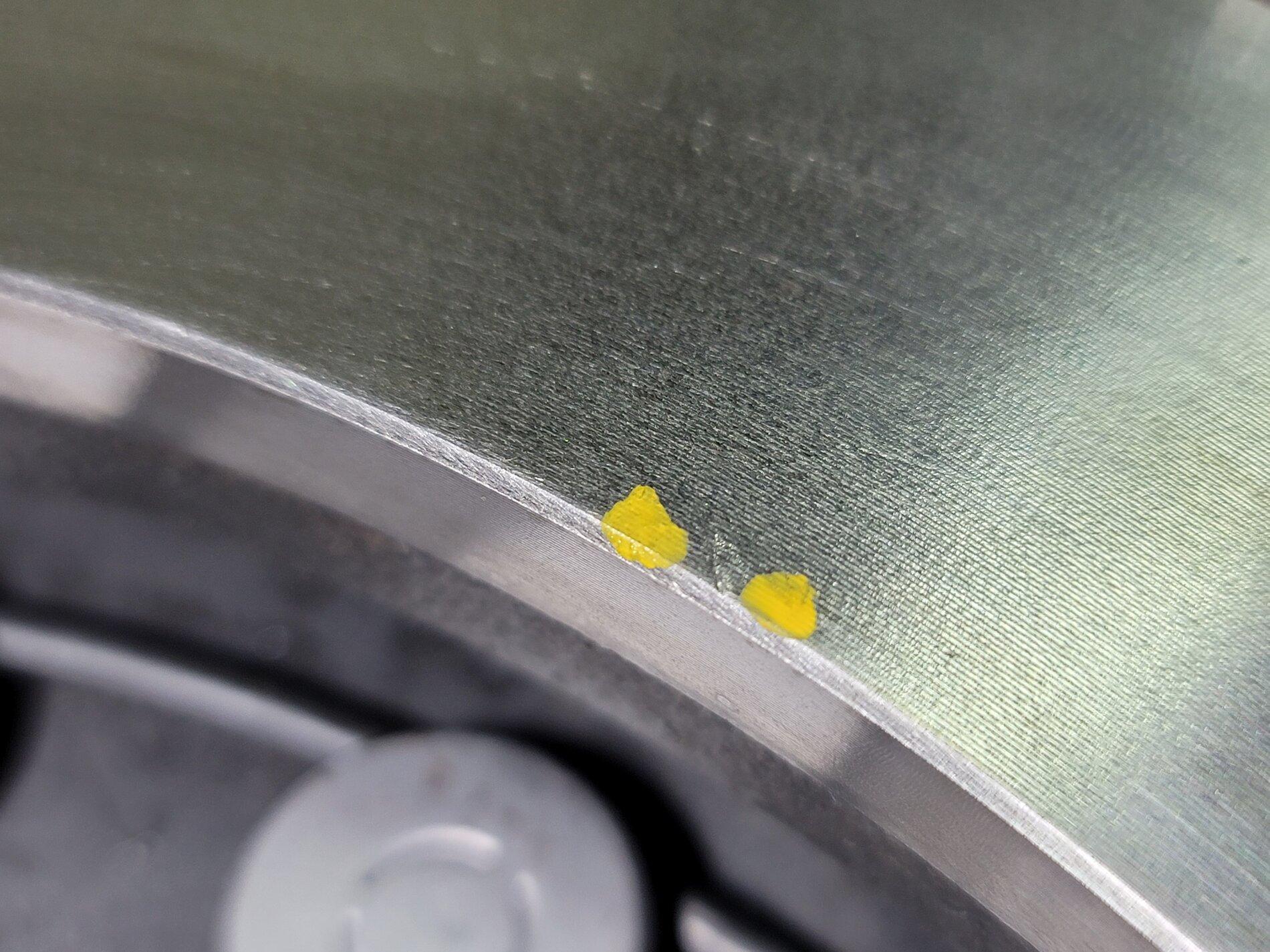

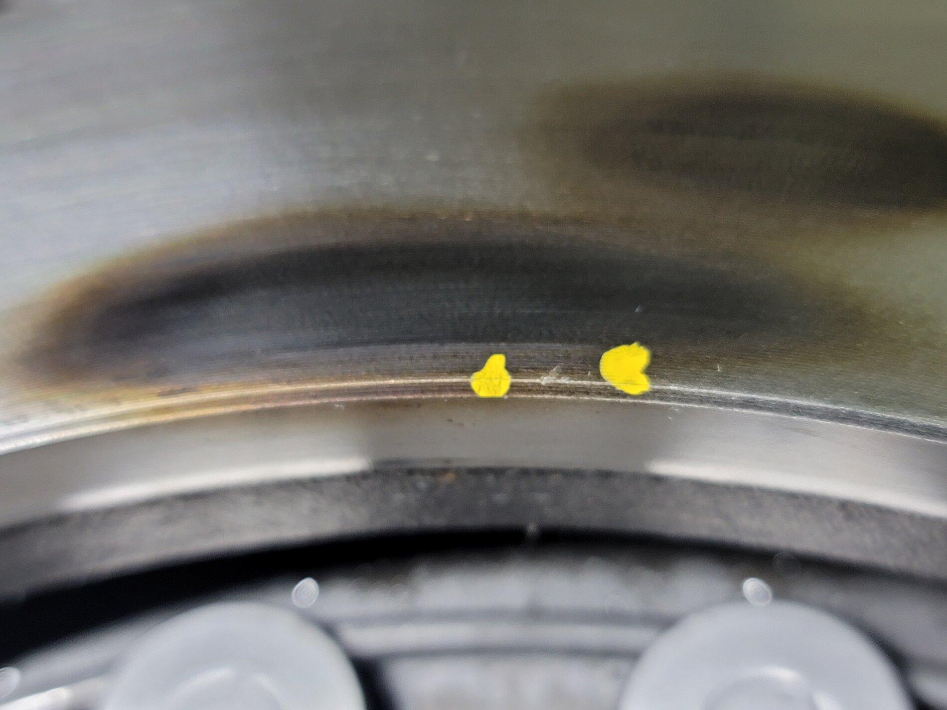

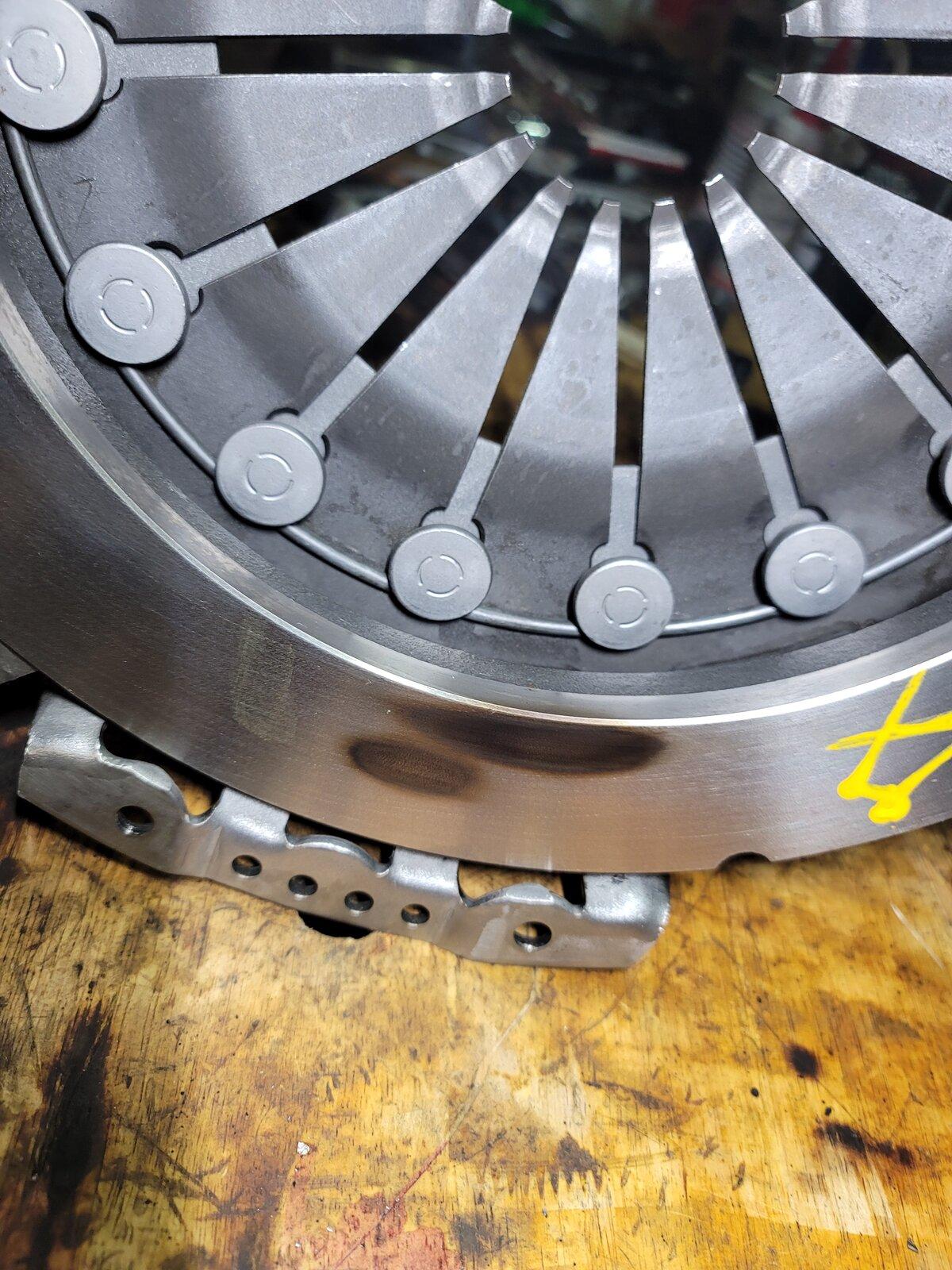

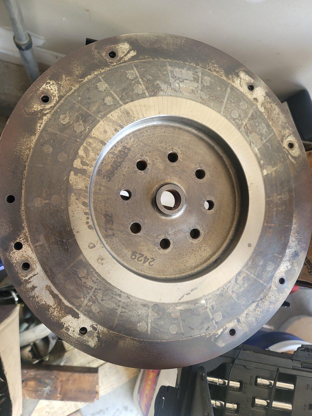

See the hot spot?
Last spot to leave the disc and first spot to make contact. Mirrors position on flywheel.
Causes chatter on clutch engagement.

See the hot spot?

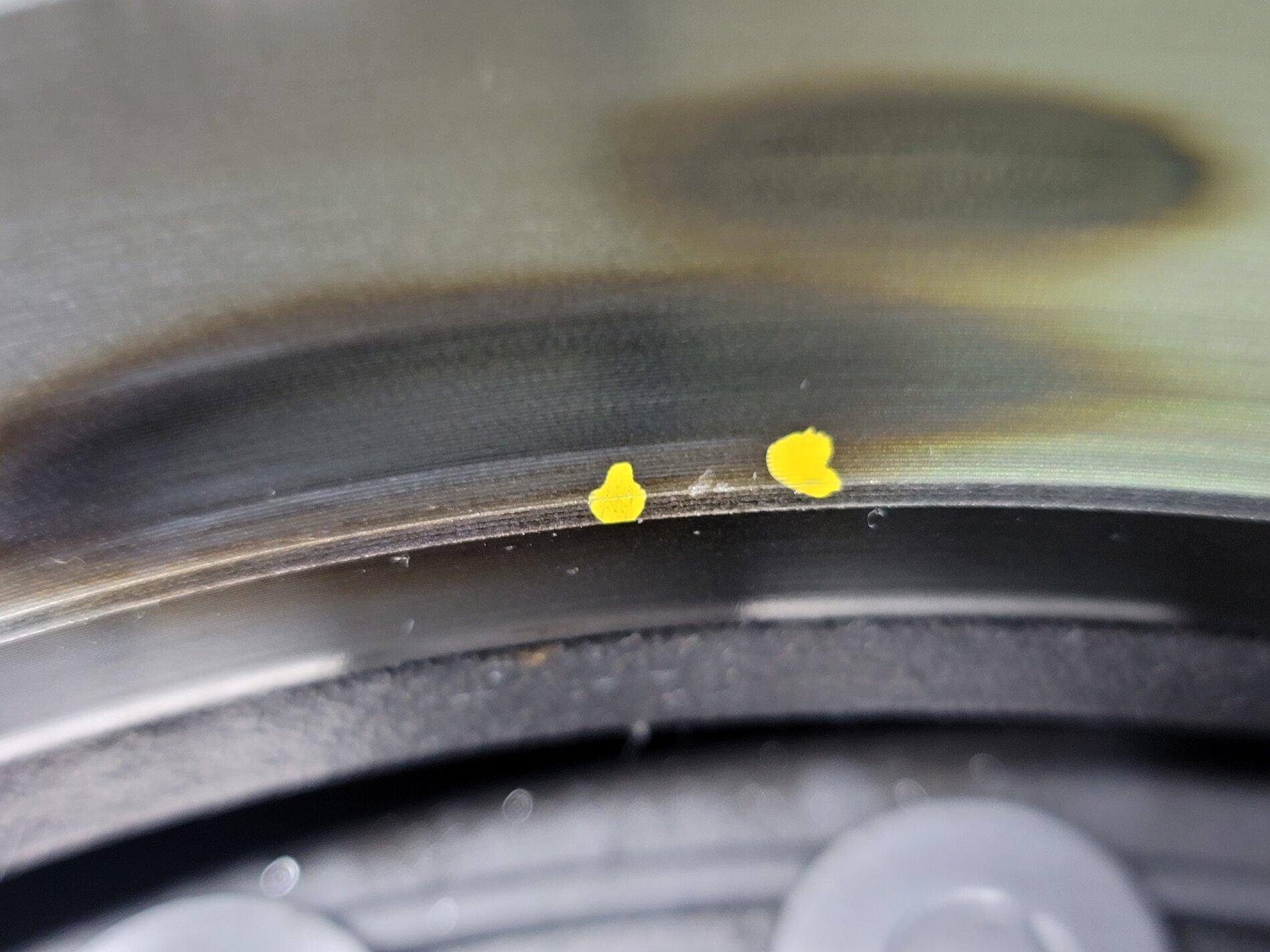

Oh I see the hot spots alright. I could feel the chatter to, letting it out.
I'll get pictures of the straps. Can the flywheel get resurfaced or does it need to be replaced?

Do you want to pull the trans after a resurfaced flywheel comes back to haunt you with those "cementite" hot spots? IMO it's ruined garbage. :eek: Just unreal that the hot spot is only in one area. (It's possible Kevlar just leaves a black mark without cementite temperatures, but, it's still a big problem. Good question to be asked.)
Cementite is iron carbide formed by excessive heat and will be thicker in the area. So the formation of cementite expands to becomes a high spot and the high spot gets hotter and forms more and deeper cementite. If the flywheel grinding misses any of it ... it comes back quick and is nothing but trouble. Note: Common for the undersized brake systems, due to CAFE, to get hot spots like this that turning doesn't fix. The "carbide" turning tool, yeah same material, bounces off cementite and leaves them alone as high spots thus why grinding is the only hope. Myself I simply toss brake rotors and flywheels because it's too much of an expense or PIA to mess with it again in 3000 miles when cementite comes back.
We had a casting engineer from Webb Wheel a sister company to us look at same but worse looking Cummins application flywheel and said it was Martensite and actually wrote a descriptive document of what causes it and it’s ugly deeper side. We later published a bulletin about it for training purposes.

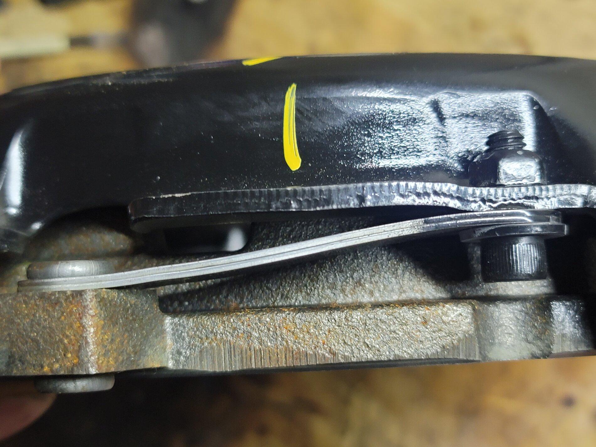

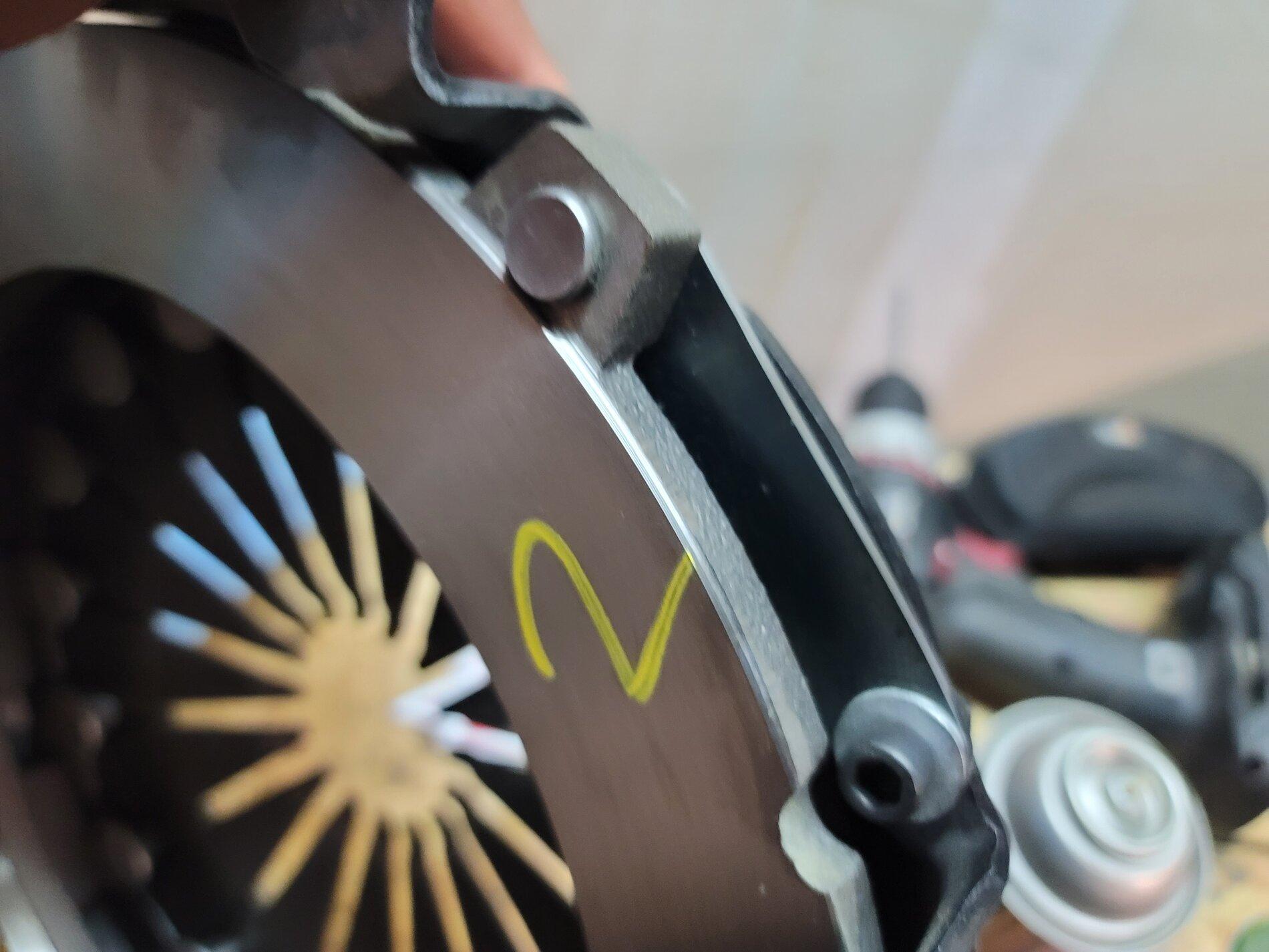

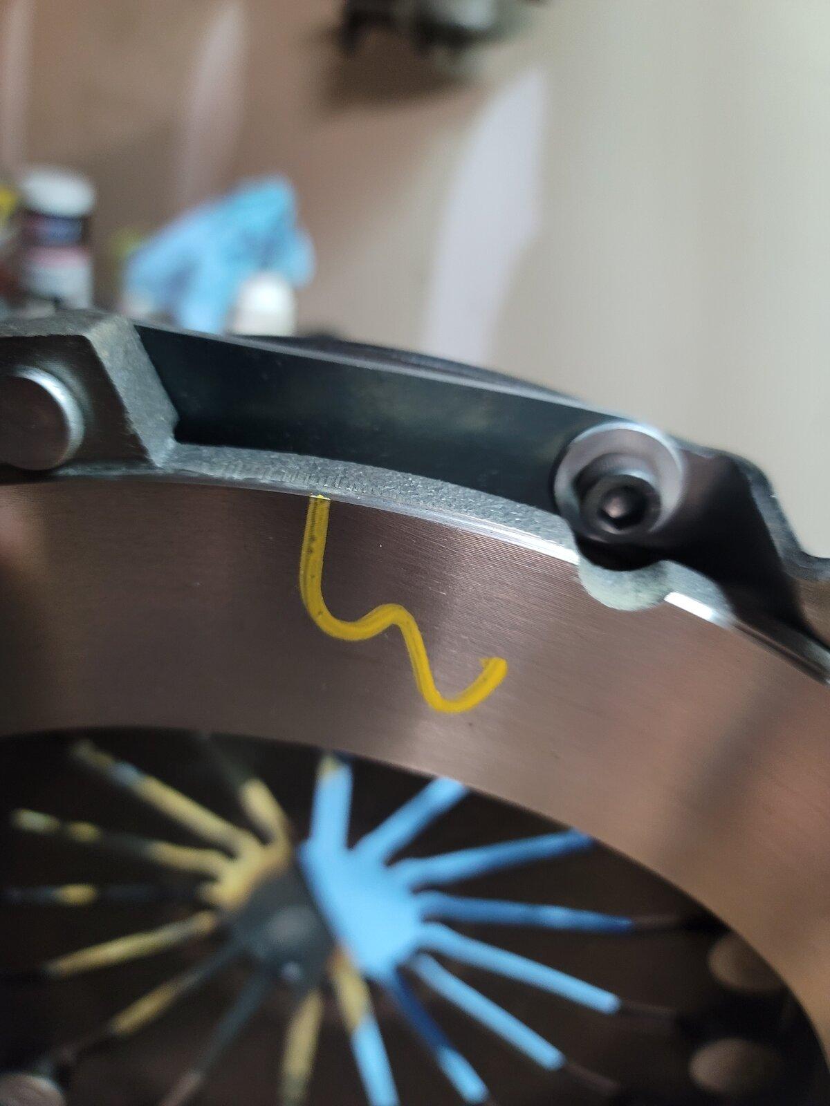

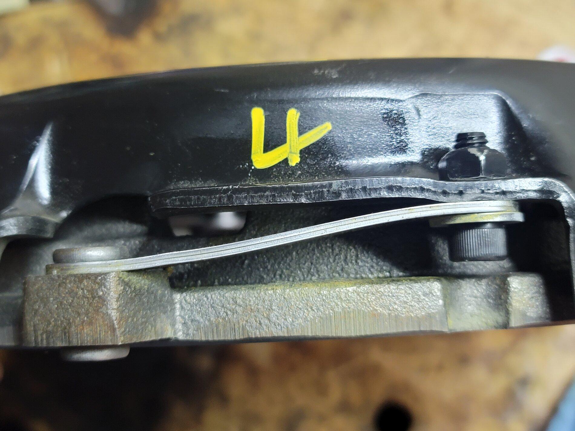

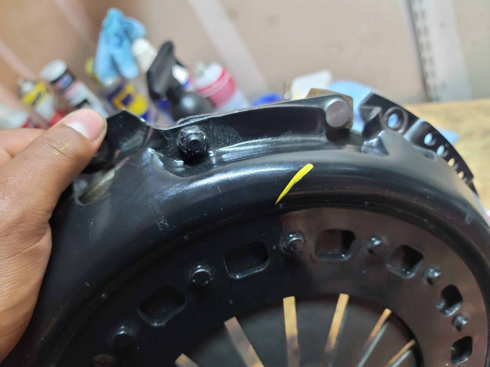

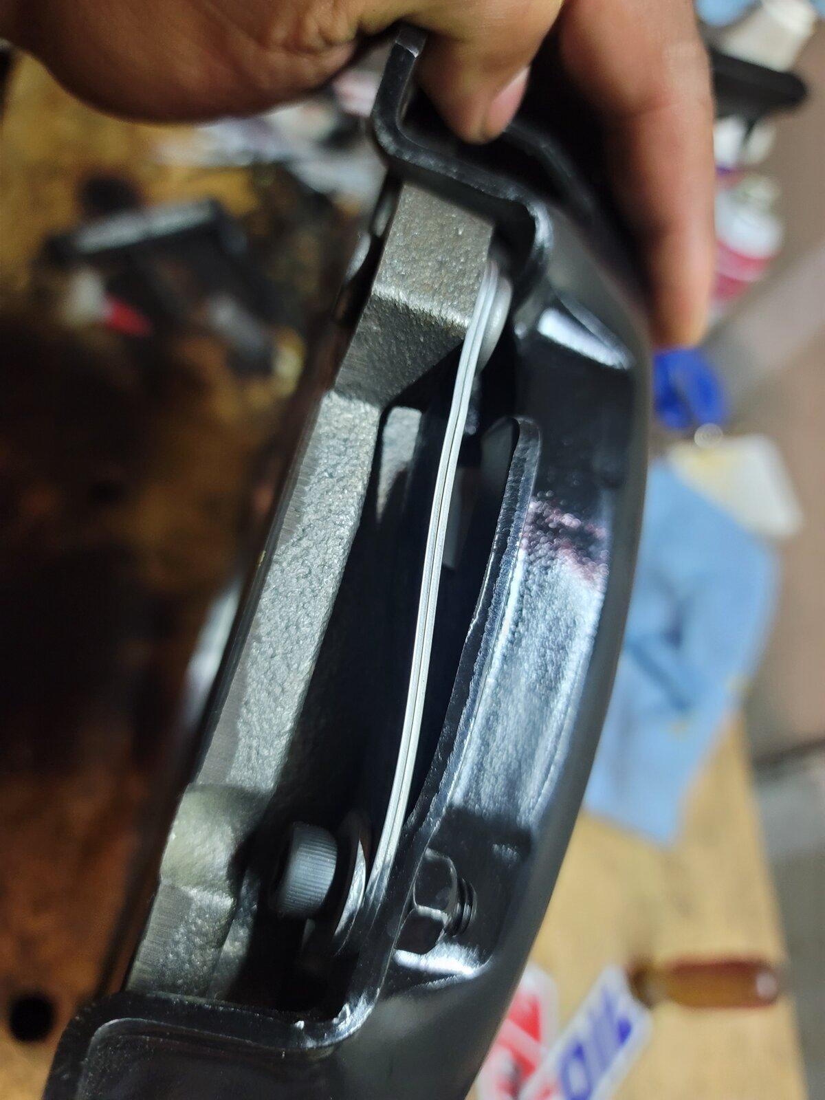

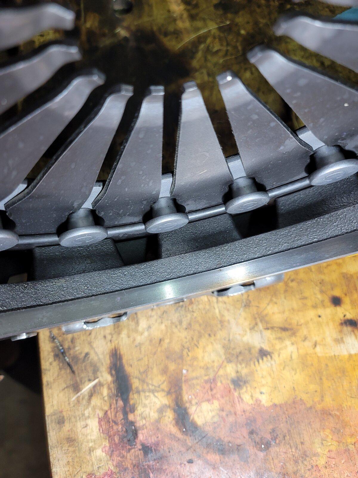

Can you inspect all 4 sets of drive straps and look for uniform profiles in all straps. Bends should be identical.

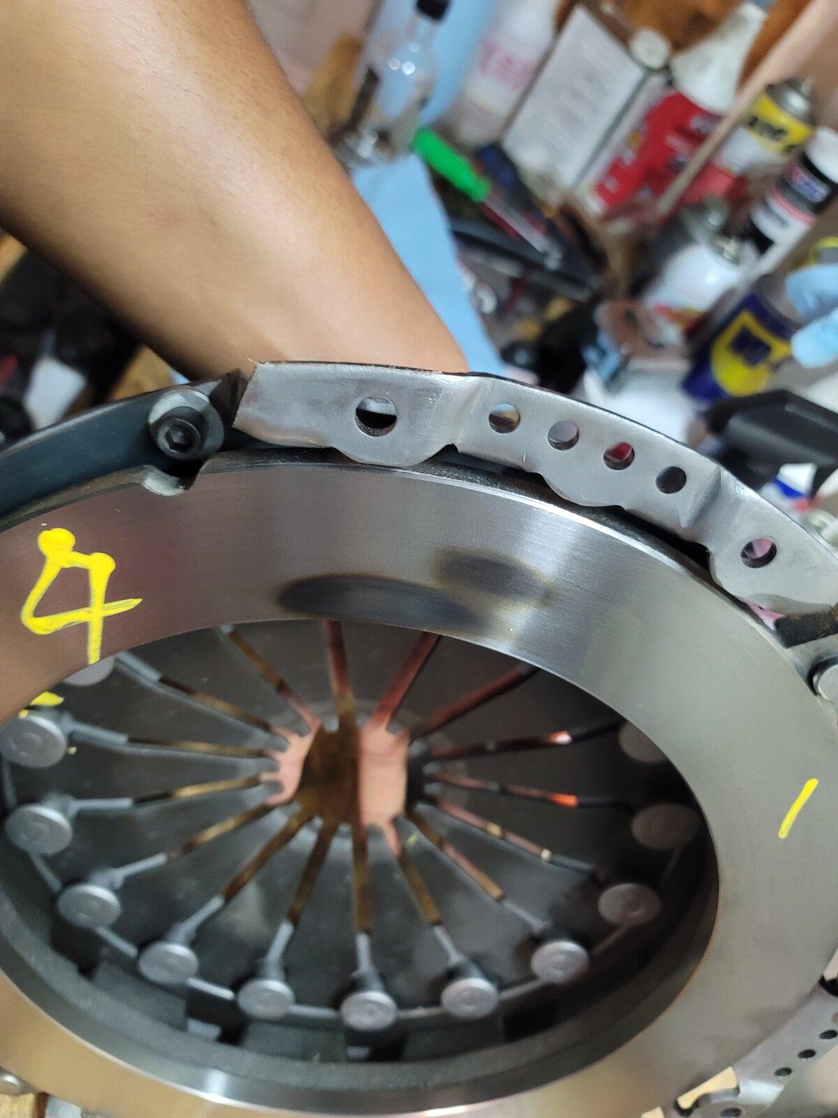

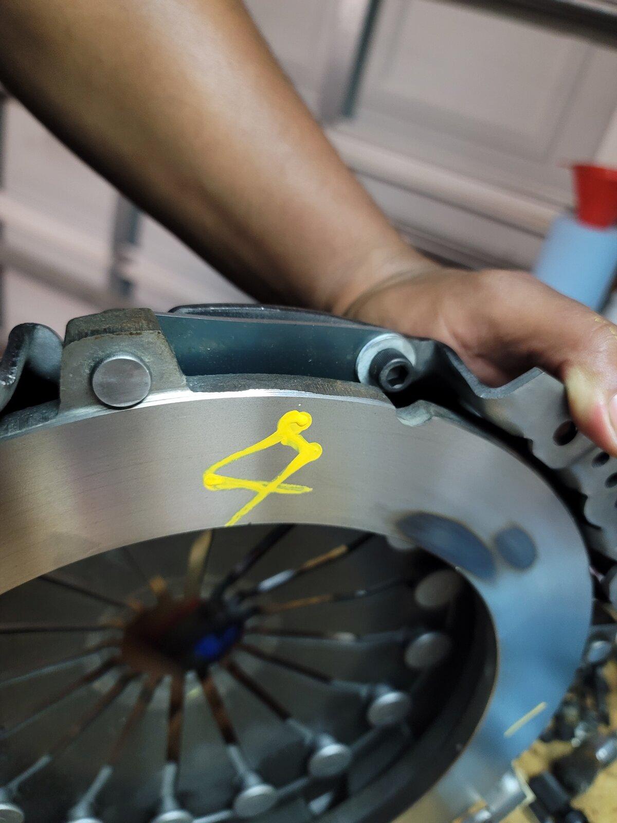

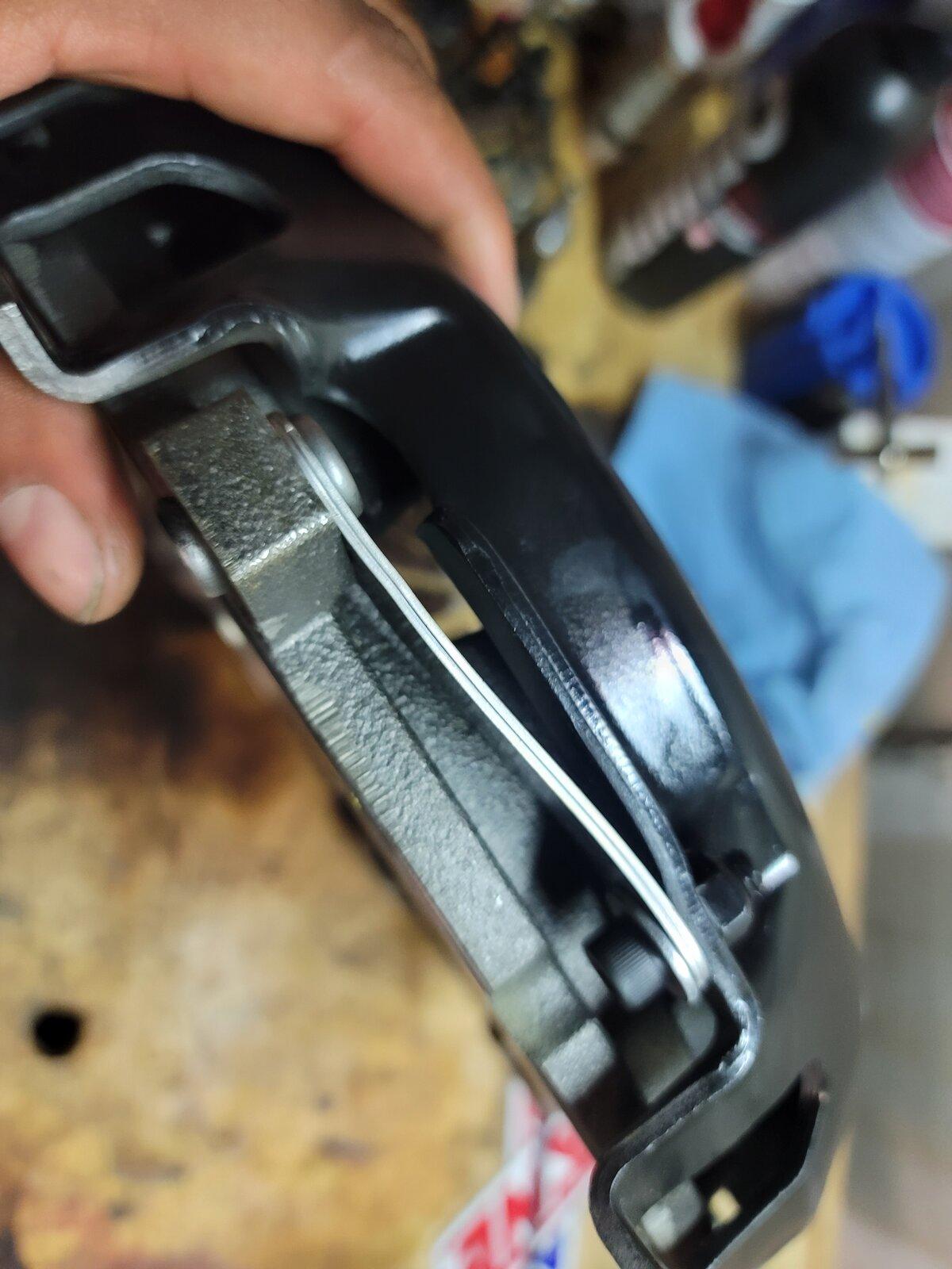

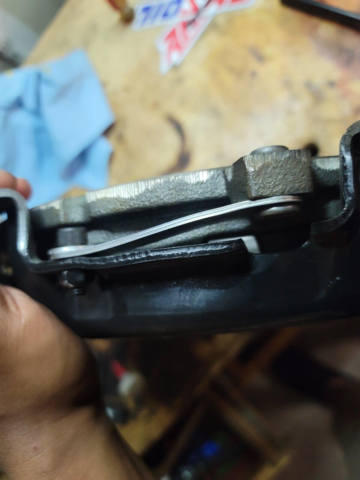

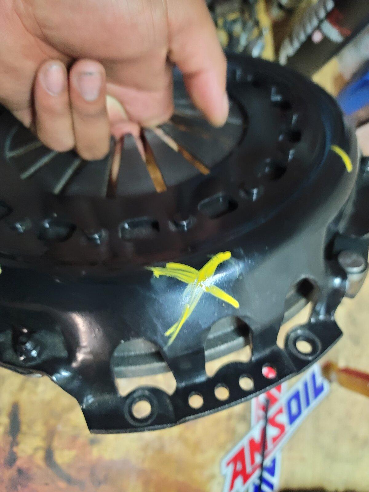

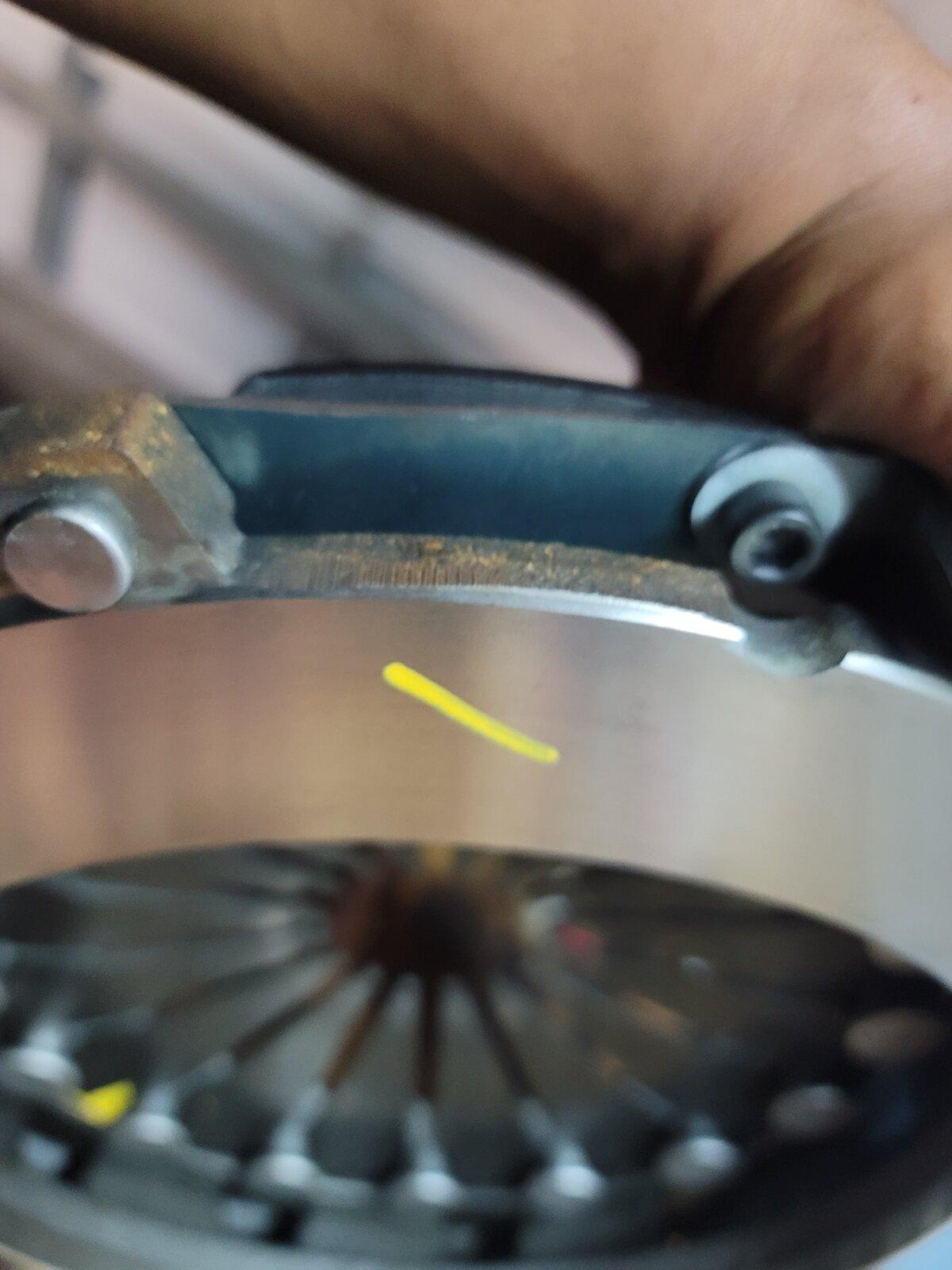

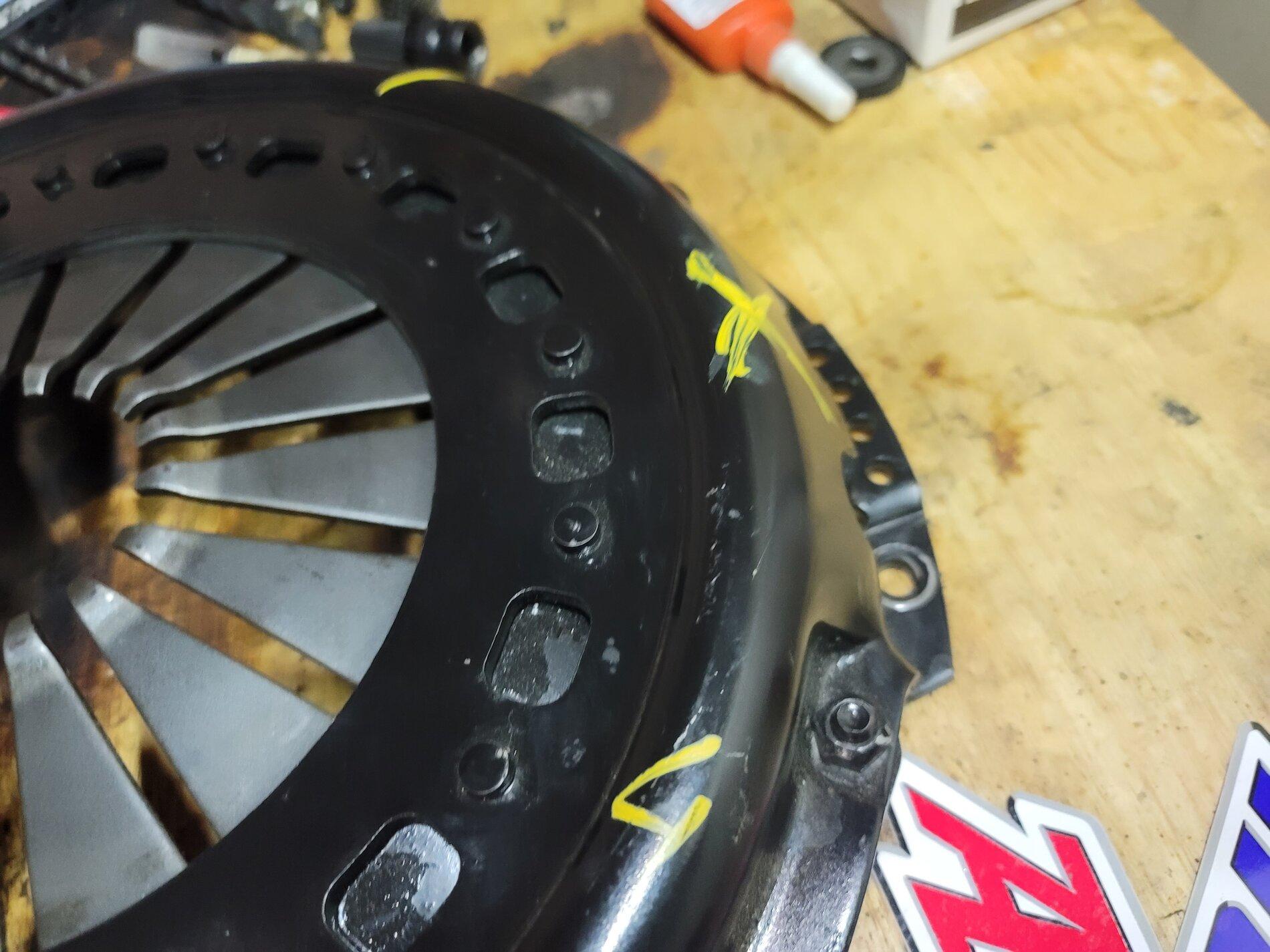

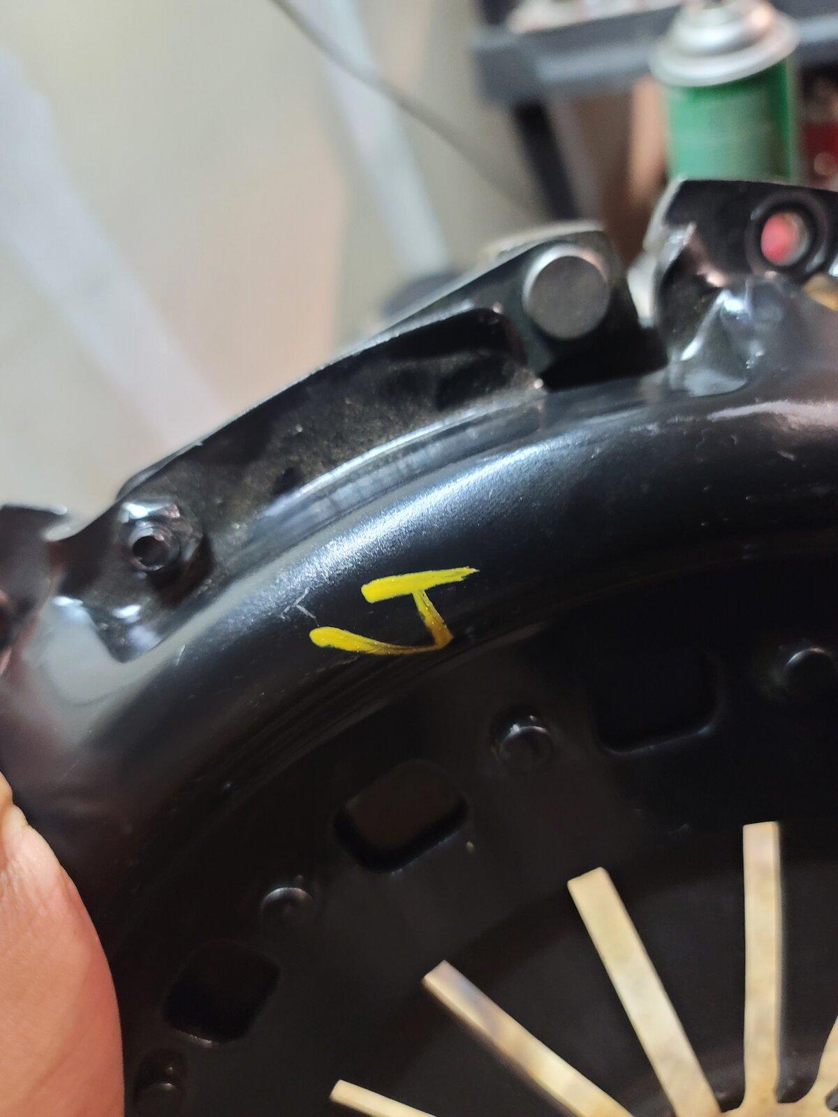

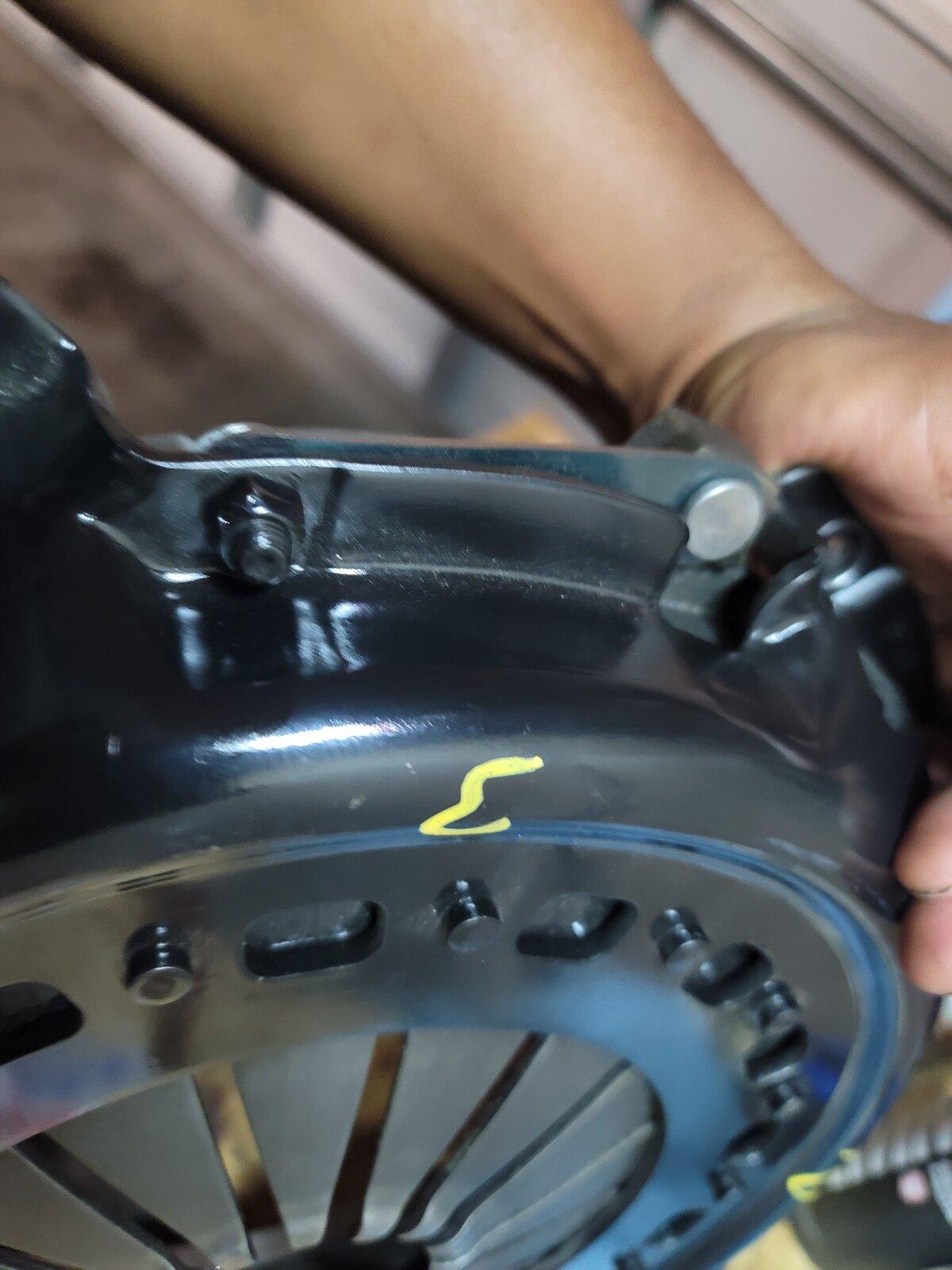

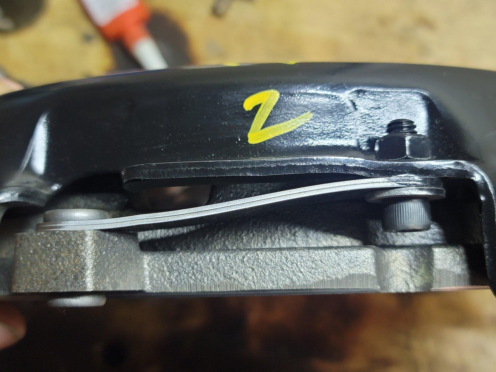

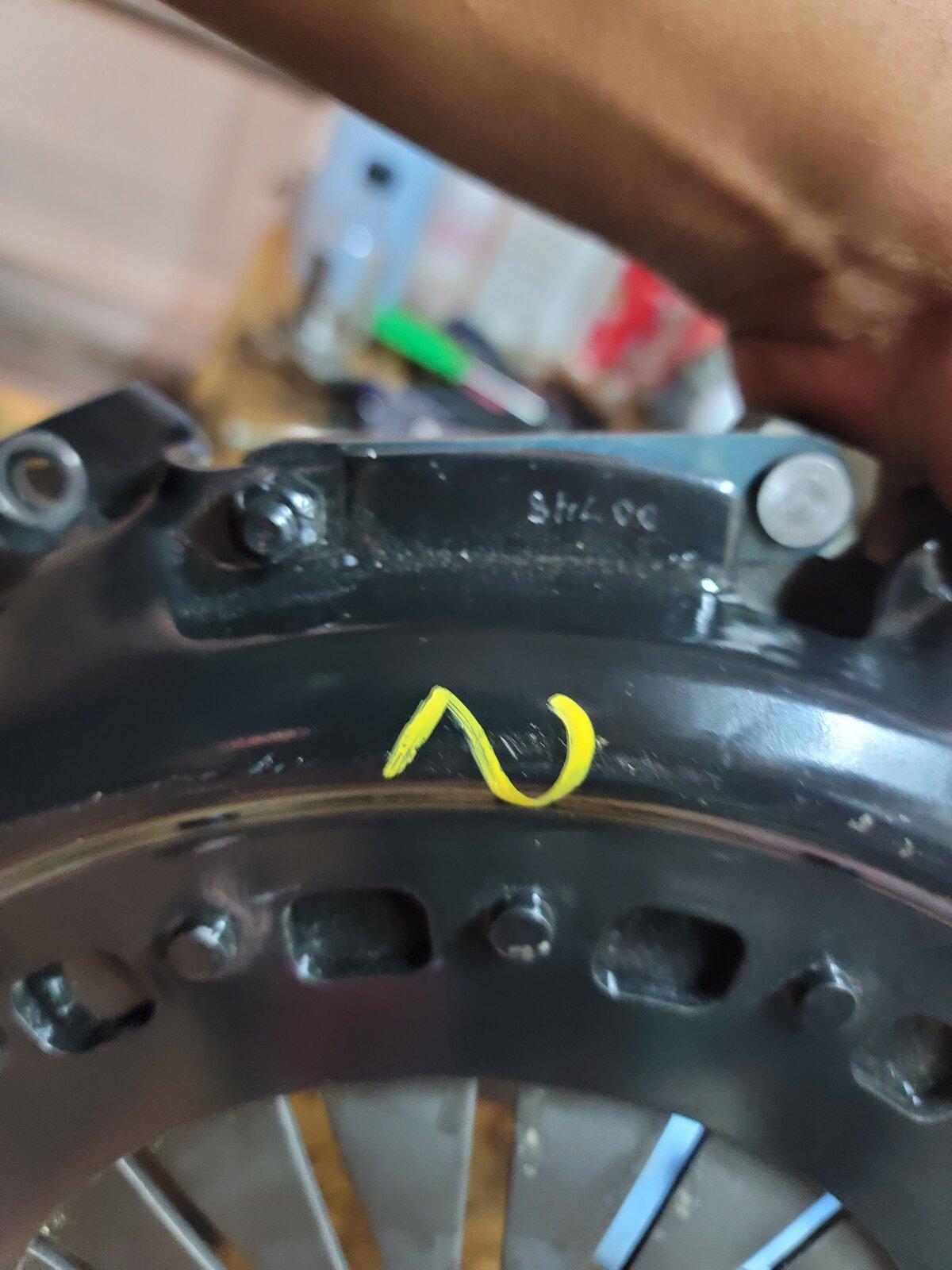

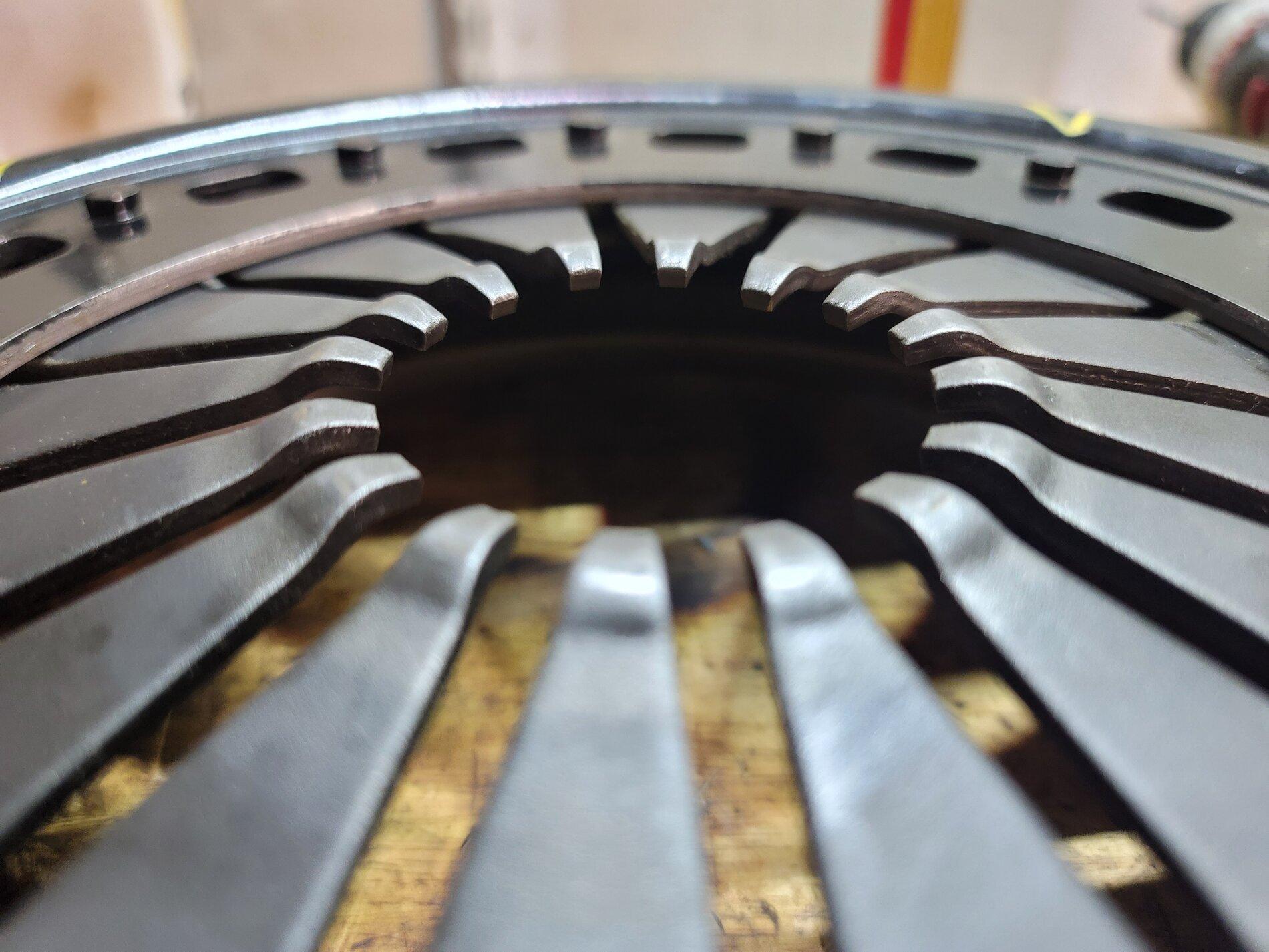

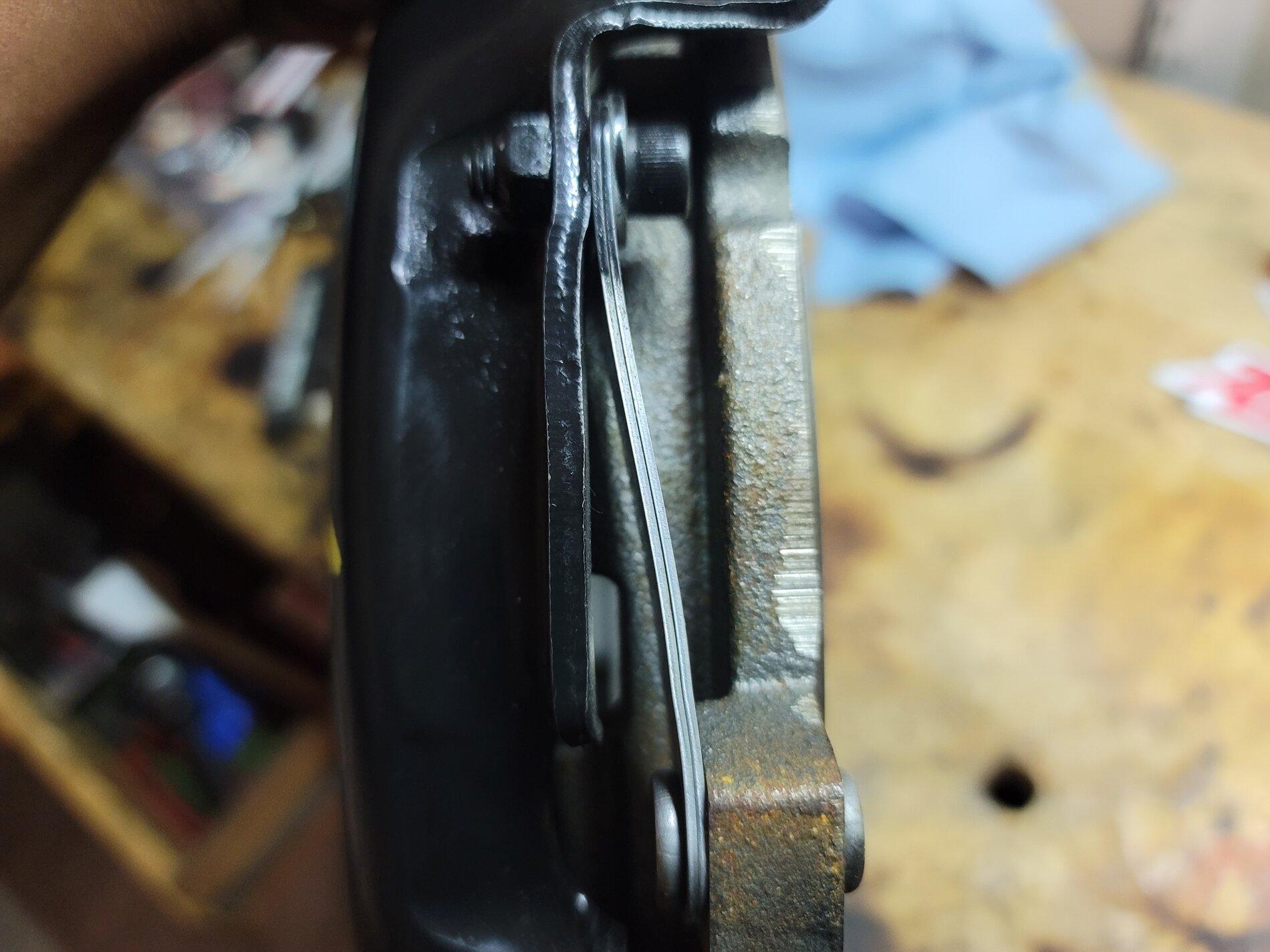

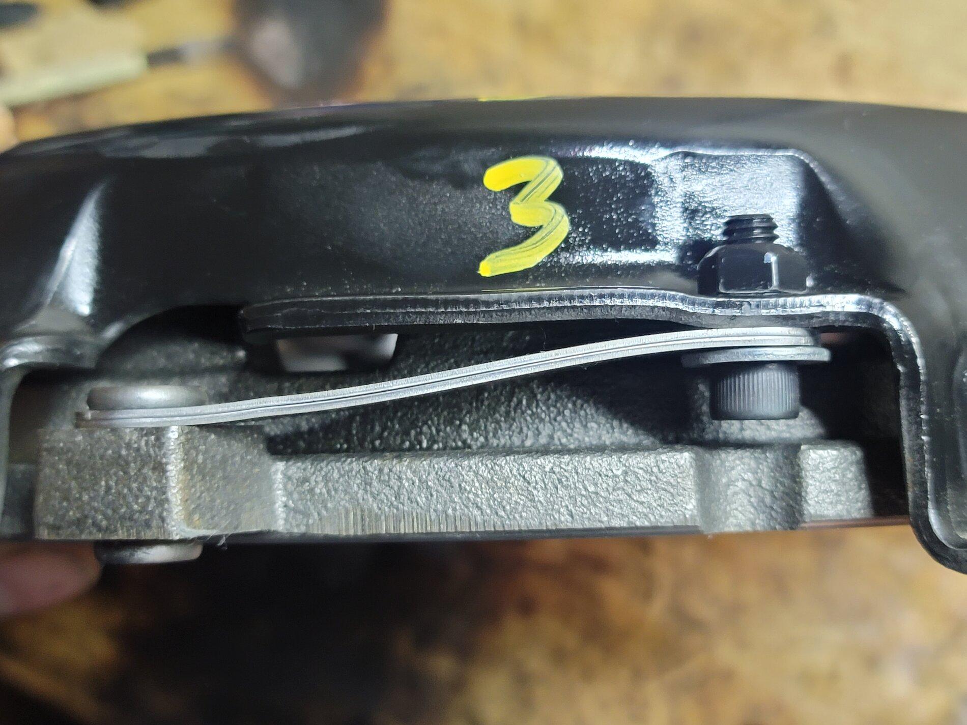

Here are the pictures of the drive straps and pressure plate.
DBM ,

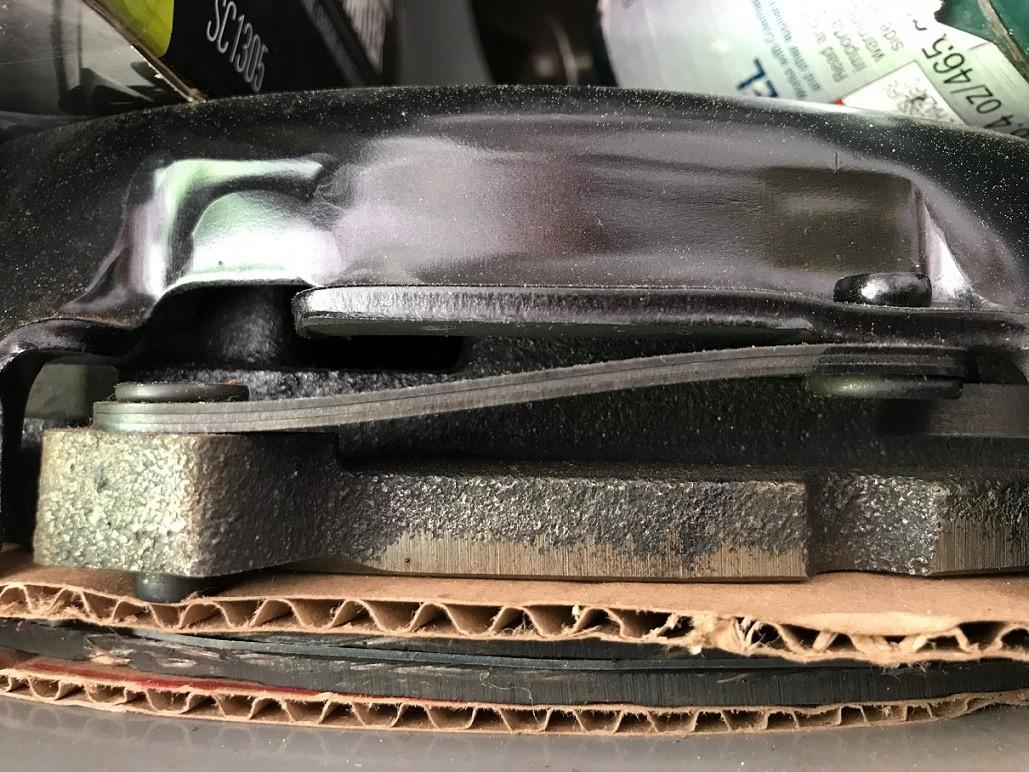

Sorry I can't review the pics of the straps as presented. They are all different orientations, angles etc. This is a pic of a spare I have, four pics on of each strap set with the same exact presentation and I might be able to see and comment on the straps. Mark each pic with position 1, 2, 3, 4 so you can see match to your clutch. The more consistent the image presentation the better.
The straps pull the casting in rotation from the cover that is bolted to the FW. All of the engines rotation power goes thru the straps.
The next function of these straps is to pull the casting AWAY from the FW and create a uniform gap allowing the disc to spin freely not touching the castings. This plate lift is only about .040" - .045" so uniformity of plate lift has a significant impact on release and smooth engagement.
Gary
DBM,
Much better. The first thing I looked for was if a set(s) didn't have the same profile as the others. Really didn't see it. Then I tried to look for anything that is not like the others. At the pressure plate casting to straps you see rivets, all uniform but at the strap to cover it's a bolt and nut, not riveted. That indicates a modification involving separating the casting from the cover. Moving on, now look at the OD of the washer between the bolt and strap. Are they all the same? By eye and you need to confirm this are they the same OD? If not then w/o testing the plate lift by measuring it exactly does the washer OD variation affect the point at which the strap is bending from for release? Or are the washers just in different positions and making it look shifted.
I can't tell, it's a long shot hunch. If you have calipers measure the OD of the washer w/o disassembling.
When these are made, the plate to strap rivet and strap to cover rivet are two different rivet sizes of course but the OD of the head of each part number is identical.
Another thing that can be observed but only when bolted to a FW with the disc is the height of each diaphragm spring tip and then the runout of them to each other. The more uniform the better. Some variation is almost inevitable but the flatter the better.

I'm throwing a BS flag on the field for this one. That concentrated dark blue is screaming that it bore the brunt of the engagement process rather than sharing the load thru 360 degrees of available casting. That visual "signature" is like a breeding ground from chatter.
Likely sources for this localized hot spot.
1. Uneven pressure plate lift. We tried to explore that visually in your pics, inconclusive.
2. Possible but unlikely actual high spot from machining the pressure plate casting or FW. FW plane can be measured on a surface plate using the crank shaft mounting flange as a base and recording readings at maybe 8 or more spots on OD ID and middle making circles. Or even spinning it and observing.
