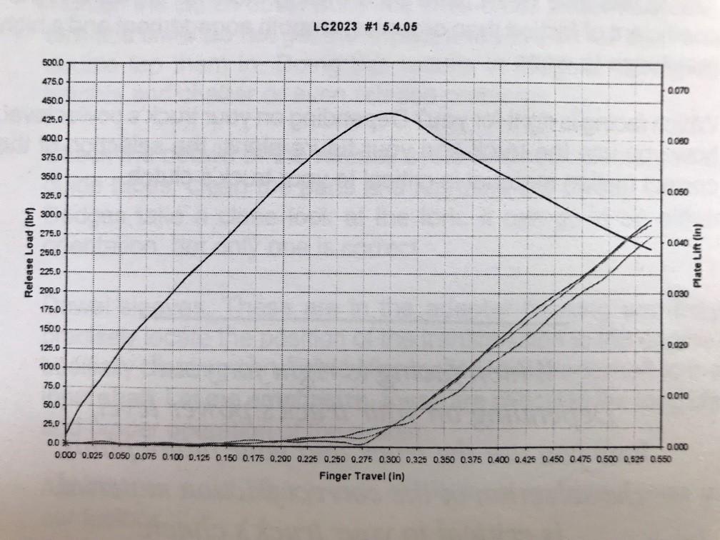

WHERE IS THE PLATE LIFT TEST DATA?
A while back I referenced a doc in the TDR library about an in 2009 article Bob P. asked me to prepare. This is a snap of the plate lift vs bearing (finger) travel vs force at the bearing plotting actual plate lift dimensions thru it's release stroke from that doc. In the article I wrote this plate lift was parallel within .005" just over the thickness of a sheet of copy paper. Pretty darn good.
Your pics and matching hot spot on the FW are screaming out that area of the hot spot was last to leave the disc and first to touch the disc to start the clutch engagement sandwich.
Even w/o a test machine that produces graphs the old standard was plate lift at XXX bearing travel. Where is that data? That's what the Shepard Thomason did.
