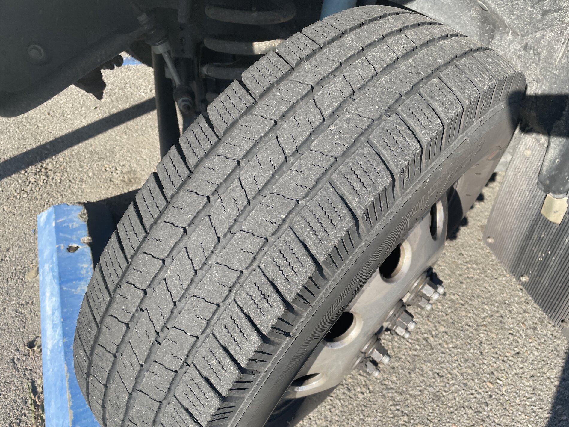

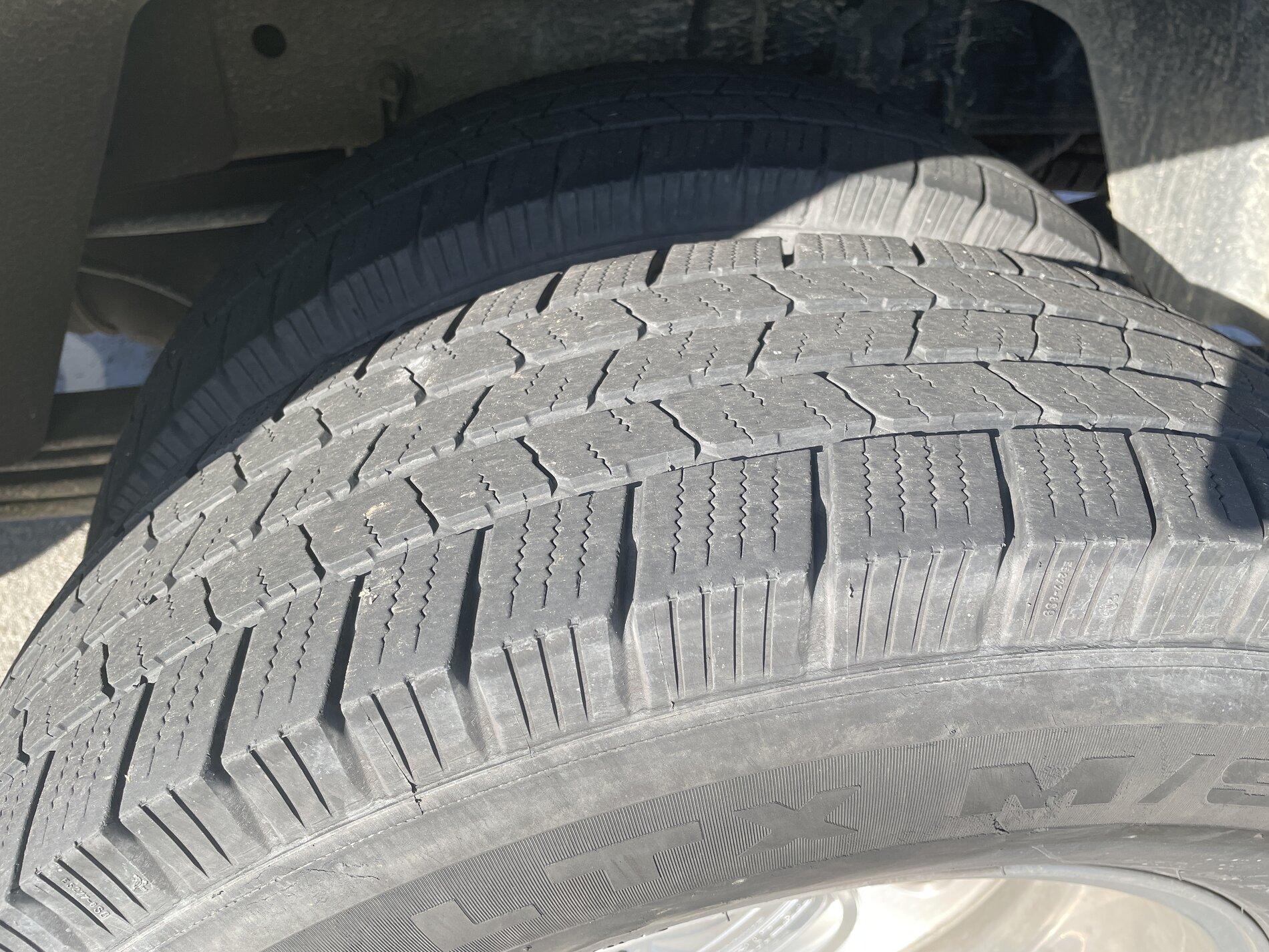

You changed tires to "new" and PROBLEM. Although I love the wear life of LT Michelin tires: they squirm more than other brands forever. Not just the Green Tire short mile range. I choose other brands FIRST because of this known known for Michelin tires. Others, like my Dad, like the softer ride of Michelin tires.
It's also possible you have a defective new tire.
If you can still use the ride guarantee: Get something else on the truck. Cooper AT3's etc.
Everything else you are doing after "New Tires = problem" is chasing your tail until you deal with different tires.
NOT only did he get new tires, he drove away with them way over inflated for the empty load and the load on them when he hooked up to his trailer. If I was him I would not panic until he does a tow with properly inflated tires.
NOT only did he get new tires, he drove away with them way over inflated for the empty load and the load on them when he hookup to his trailer. If I was him I would not panic until he does a tow with properly inflated tires.
Usually that makes the tire harder and rougher ride... And it's like only 60 days for a ride guarantee.

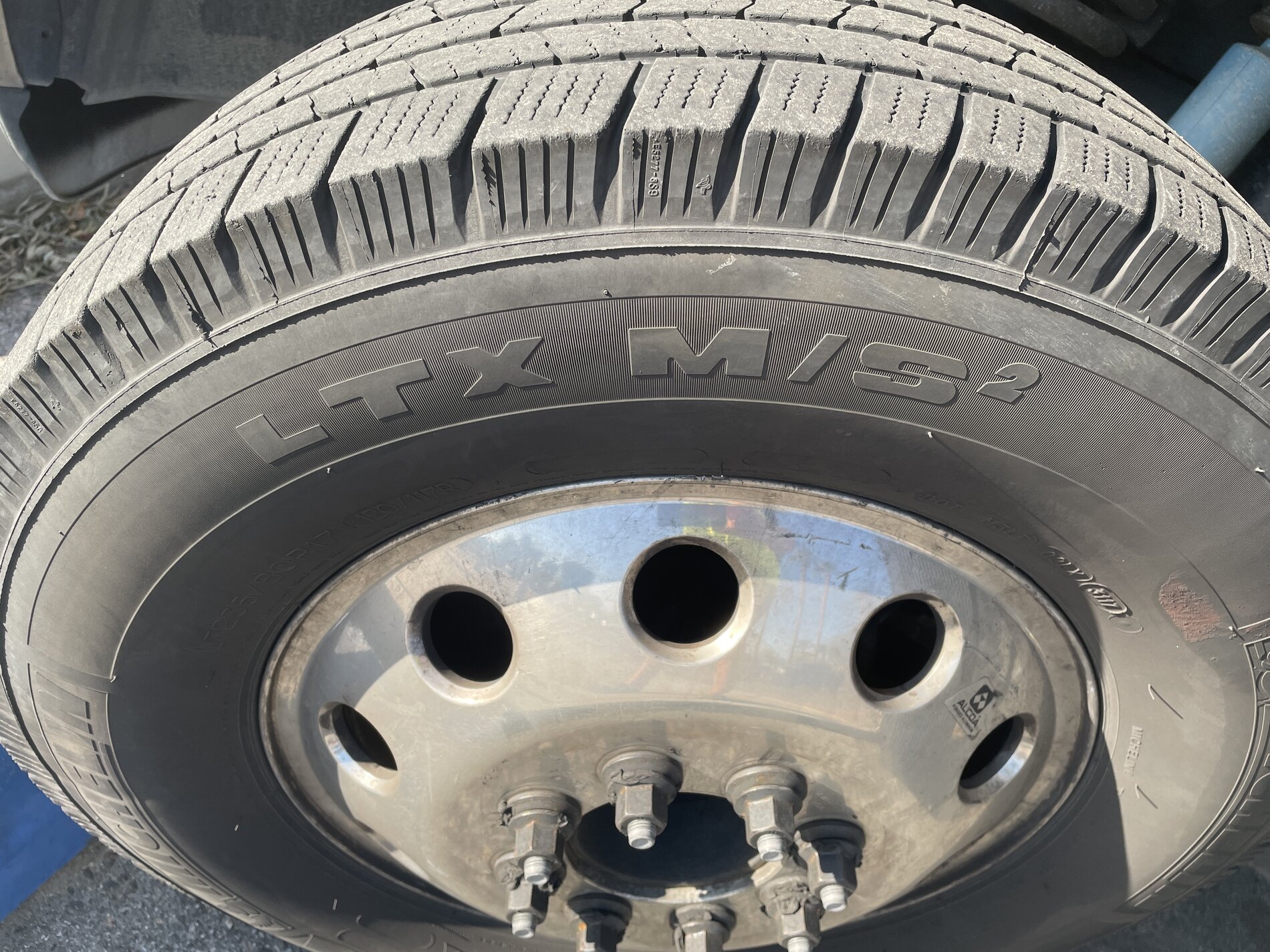

@ramduk Verify each tire is actually marked "LT" before the size. The above reminded me of a time I had one tire of four with excessive center wear. The tire shop had put one passenger car tire on, that got the excessive center wear, vs. four LT's. They doubled down on the mistake when fixing it and put two new passenger car tires on the rear. Talk about a drunken sailor feeling that made one block before going back. Yeah, training opportunity. Finally with four LT's on: it drove properly in a straight line.
