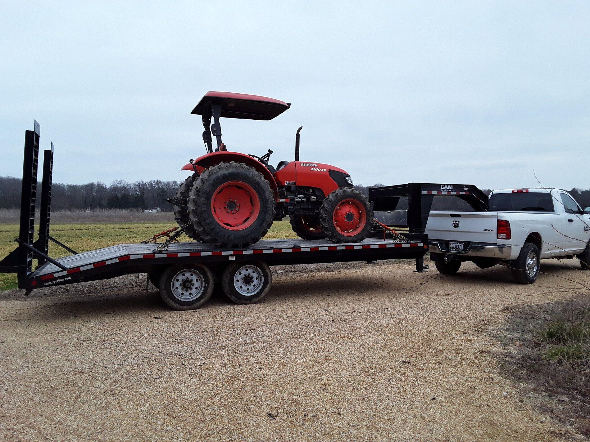

Well the truck just broke again - third time. Was evaluating it when it broke just like before. Going downhill with a loaded trailer. This time it was a lighter tractor but same issue.
I'm beginning to think the transmission may be a real problem rather then the txfr case. This truck has always shifted slowly with a lot more slippage than the loaner 2018 Ram 2500 6.7.
At any rate FCA has agreed to buy the truck back per the dealership. The selling dealer is looking for comparable unit. I was hoping to keep this truck because overall I like it and the two door configuration.
