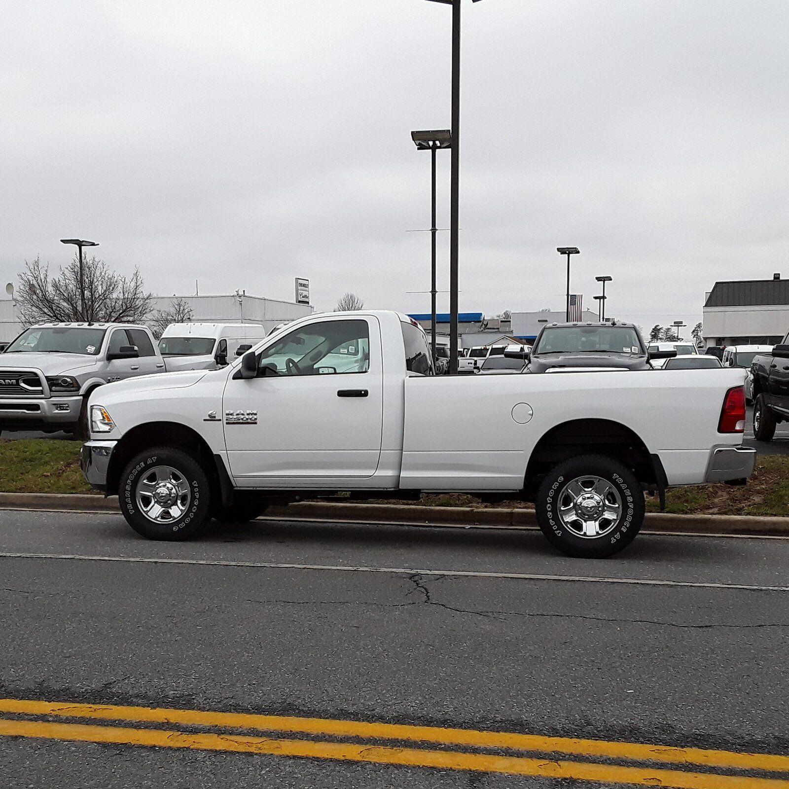

Well our truck is back with it's 4th transfer case. Hopefully this one will work. Found a local dealer who installed a brand new case under warranty. I'll double ck the linkage tomorrow just to confirm it is set correctly. Soon we'll load up our gooseneck and take it for a test drive.
