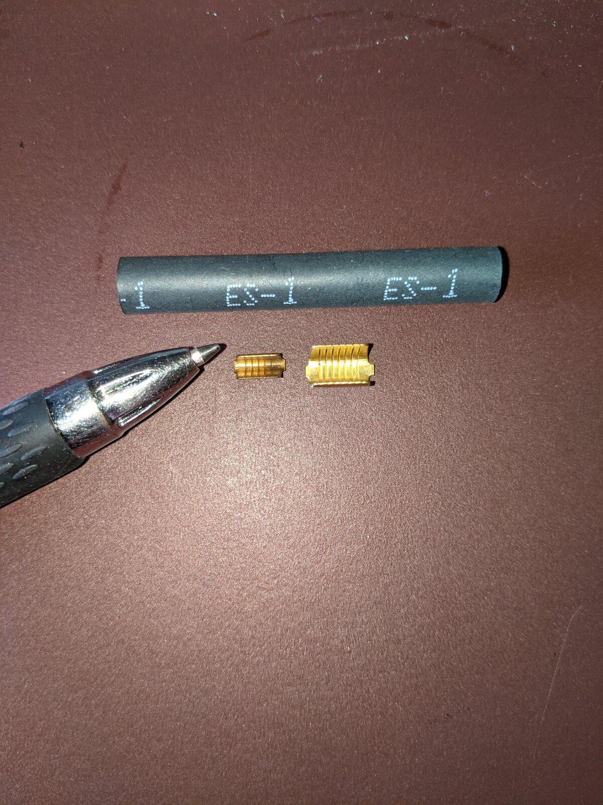

The approved method for FCA is to use brass crimps for a mechanical connection, then solder and shrink wrap. It is a little more difficult when you are in a tight spot, but offers a very reliable connection. I will take my chances any day on a soldered connection over a butt connector, especially in an auto environment.
The Mopar heat shrink in my photo is now over $1 per piece. I need to find another source of quality tube as this stuff is just getting too expensive. There used to be a recall package with about 15 pieces for under $4.00 but they got smart and require a VIN to order the parts package.
I've had good luck with products from this place, they sell some other varieties as well along with a lot of OEM connector sets. https://www.corsa-technic.com/item.php?item_id=291&category_id=63

Thanks for the link. I just ordered a selection of shrink wrap and the brass crimp splices. We will see how they compare to the Mopar stuff.
I'll be interested in your opinion on it since I've never seen the Mopar stuff. I've used a lot of it on motorcycle wiring projects and it has stood up well in that environment.
