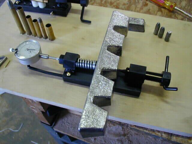

Lead hardness tester is a good thing to have when bullet casting. Knowing the hardness of the ingots at the get-go is a good first step. Start with parameters you know and mix accordingly. However, You will only use it with the ingots. Are you going to make large batches? Remember, lead alloys age harden. Especially those with antimony. So older alloys will not give you a true picture. If you order ingot lead, the supplier should be able to give you the hardness. A bullet hardness tool could be a better purchase? You could still measure the hardness of your ingot material. Just cut off a chunk and mould a bullet. "Saves" yer money and buy more powder, primers and brass.

I have found a man that is also my Dentist, that belongs to a group of like minded Sharps People. He and the Smith that owns that Hardness tester are going to help me out with the reloading of the Sharps when I join their group, with it I would like to go with the traditional PPB and use Black Powder to make it as authentic as I can, I have never messed with any sort of PPB so it would be a new experience for me. I try to get as many thoughts from as many different sources to formulate my answer.
I like the Garrett Loads for both the Marlin and the 44 mag they have a Brinnell hardness of 25, that's what I want for the use of those two rounds. But as we talked about the other day briefly the Sharps will be a different animal with the need for some expansion on game, I would also like to cast some 45 ACP and 9mm for both of our carry, Para Ordnance weapons. To cut down on my practice cost and get the wife to practice more than she does, I as a genral rule put a couple of hundred rounds thru my Para 45 every other day sometimes everyday, the wife if I can get her to squeeze off a hundred a week I would be happy.
I have obtained an almost never ending supply of PURE LEAD, there was an old telephone line that was above ground on poles at one time and then was taken down a buried and eventually abandoned. Last spring the state was digging a drainage ditch and hit the line, I got with them and got the entire length of all 3 of our property's in the family, close to a mile of lead with copper wire in it. The pure lead is no good for anything except my Round baller that throws a 54cal punkin. I also have a few 5 gal buckets of Linotype and as many wheel weights so I have the basics of the casting material, Just need to get some tin and read some more in Lyman's 4th edition casting book to figure out what mix I need to get what hardness desired.
Good thought on the bullet tester to save money, Saco makes one that is about the same price as the ingot tester so it would be a toss up in that case. I will more than likely make a batch of the several different types of hardness to save time, My question is how much harder will they get in say a few years of storage?

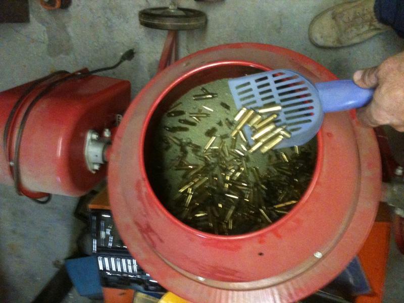

Let me throw a cog among the gears....
Concrete mixer. http://www.harborfreight.com/1-1-4-quarter-cubic-ft-compact-cement-mixer-91907.html
A little media of your choice, and you're set for several hundred rounds at a time...... Also, it works good for LARGE brass..... :D
Genius!!!!!!! I that never even crossed my mind! I seen one the other day at the Hardware store and was thinking about it FOR AN ENTIRELY DIFFERENT PURPOSE FOR THE WIFE.
THE CAT CRAP REMOVER IS A NICE TOUCH!!:D
Several hundred!?! Try a couple thousand.
Obviously you haven't seen BIG BRASS before!!! :-laf
It's good for about 100 rnds of 50BMG with about 5 pounds of media, depending on type.... I have dumped 1,000 rnds of 9mm in it, and it worked great. It only holds about 35-50 of 20mm, though.... And you can also throw in brass door hinges, SS receiver parts, small children, and the occasional brass ball set.... real handy when your wife give them back to you for the weekend and she's let them tarnish in her kitchen drawer!! :-laf
One down side is how loud it is.... there may be other ones that are quieter, but the electric drive on this thing is insanely loud!! And the large cartridges will ding a little when the heads come down on the sides.... Good news is it drowns out the sounds of my children trying to kill each other....
Cat scraper? Ohhh, so that's what that was... :eek: :D I found it in an old bucket of random stuff my wife left in the attic..... and since I don't throw away much of anything, I thought it looked handy... It keeps most of the media in the tub, and holds it while you drain the remaining media and sort your brass.....
When Holiday Shopping it seems that my wife deems it necessary to keep a tight GRIP on our Brass Ball set, but she would NEVER think of tossing them in a KITCHEN DRAWER!!! that would be SO IMPERSONAL!!! ours are kept in a place of honor ONE PER and IN HER PURSE, where she can give them a quick kick when one of the Female Santa's helpers come by wearing SKIN TIGHT SKI PANTS :D
HH found this poly drum mixer, would be less noise of case's against the metal drum. Did you remove the in-drum mixer paddles? or leave them. Thanks for the Great Idea!! Pard.
http://www.northerntool.com/shop/tools/product_200356931_200356931#
Gee, that's a big one, BIG!! Mine's a 1.5 cu/ft, and takes up a little less room.... Poly might be quite a bit quieter, but then again, most of the noise of mine comes from the drive system... But I got it on sale for $75, IIRC.
The paddles have to be in there, or the brass in the middle won't move much.... Initially, I left them out of mine to try it, but it wouldn't work properly.... The original paddles seemed too big to me, so I made smaller ones out of 1/2" angle iron, and that's worked pretty good..... The larger paddles wouldn't work very well with the .50BMG brass, as they fall too hard from the top when it rolls over. It works okay with the smaller brass, though. The smaller mixer blade looking things I made work much better, and don 't let the brass fall so far. The poly tub might make for less fall damage on the case mouths when they fall off the paddles and hit the tub. Also, the two small mixer blades allow you to stick the cat scraper in the middle and collect a load of brass to sort while it's running.....
