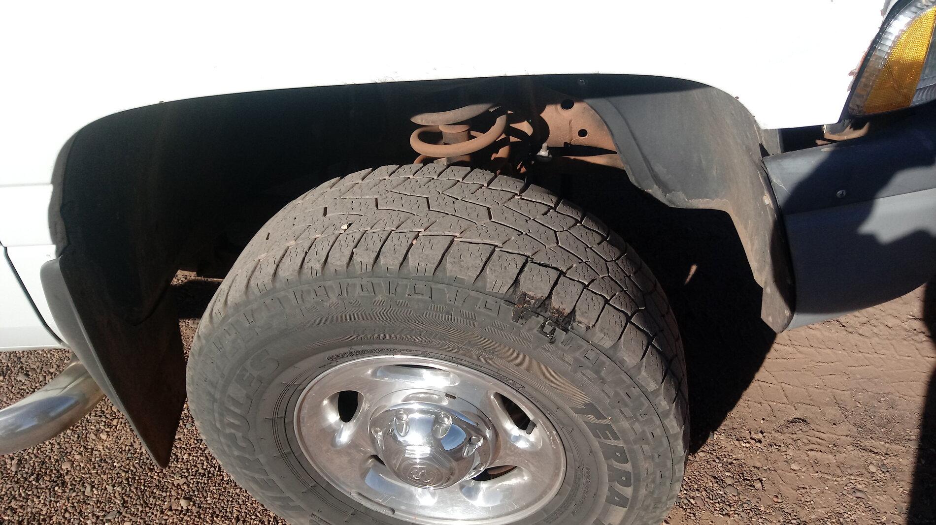

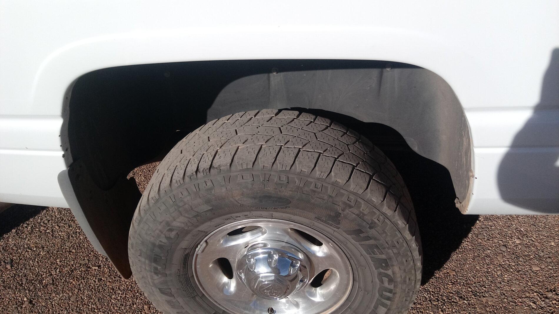

Replaced the junky Mastercraft tires today with Hercules Terra Trac AT II's in the same size, 285/75x16E. Only 22K miles on the old ones, rated for 50K. I did get some prorated tread wear out of them. They weren't quite to the wear bars but on the roads I travel, I didn't want to go any longer. Nothing I hate worse than a flat tire or dead battery.
View attachment 109692 View attachment 109691
Welp, two years later and I need new tires again, 28k miles on this batch, down to 4/32's. $1050 for a new set just like them or same price for a set of Cooper ATP's from Discount. I do buy the no fault warranty, that adds about $30 per tire.
Note the clean wear pattern on the front, oem ball joints and unit bearings, 352k miles.

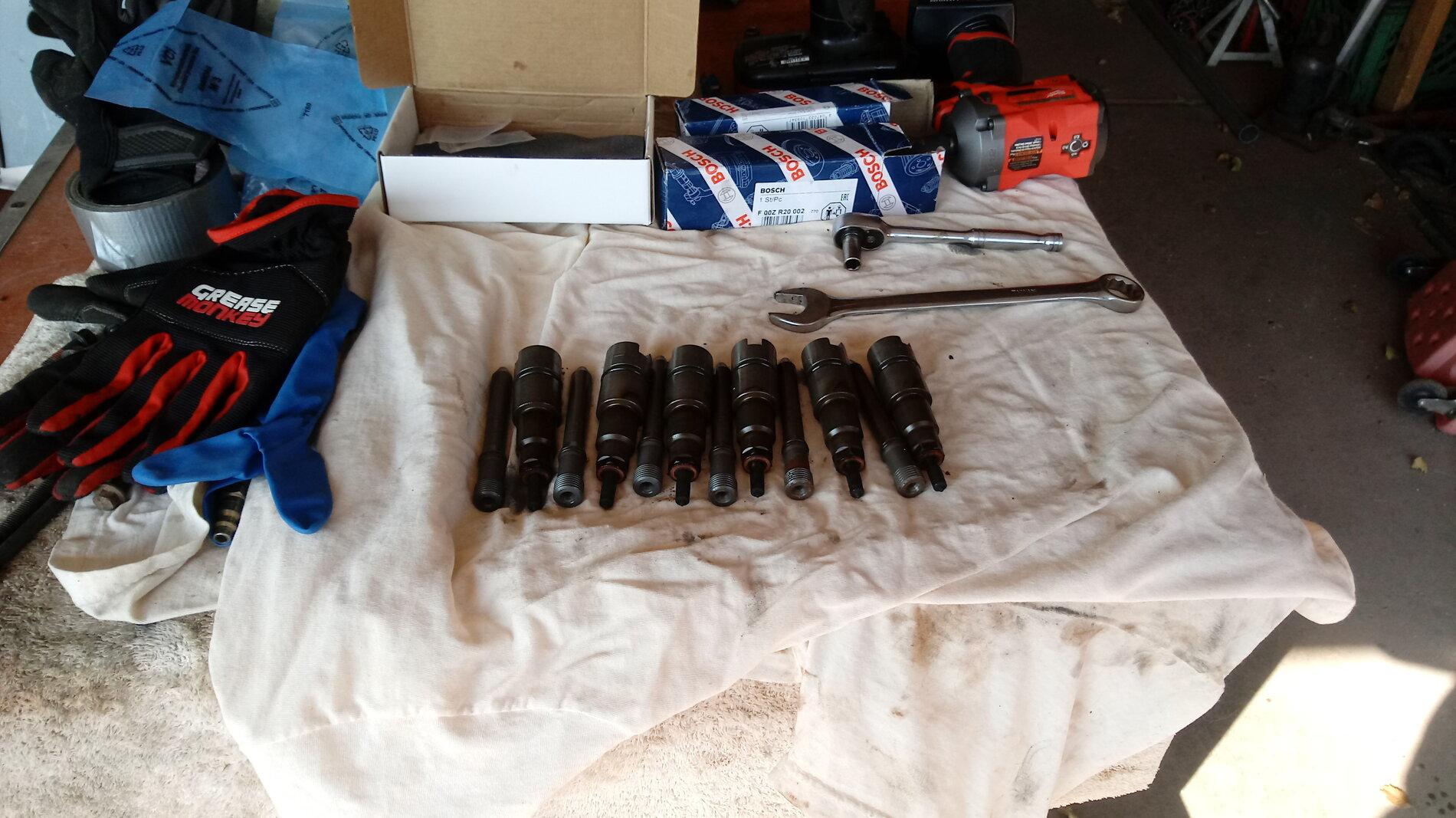

Installed the new injectors and tubes today. I haven't driven it yet, but it seems slightly quieter at idle. I did forget to plug the tps in, so now I have a check engine light, but I guess it will go off after a bit. Four hours for me to R&R. I didn't see anything unusual on the old pieces. I saved the tubes and mailed the injector cores back. 310k miles on them.
Hauled a load of manure yesterday. I noticed a quieter engine at cruise, less smoke at low boost with some throttle, more responsive launch at idle and no rpm rise when stopping.
I do still have a slightly longer overnight start with a half a tank of fuel. I am just going to run it until it gets worse, right now it is hit or miss. I will report back when I get some miles on it to see if the fuel mileage went up any.
EGT's went down (level 3) but so did power. I have a load of cinders to deliver today, going back to my favorite level (5) and see. The temps are a lot cooler now. I was running on level 2 and 3 all summer.
@NIsaacs I have 315k on my 2001, so do you think injectors were needing replaced on yours @310k? I have thought about it, but no real indication they need it, still running the original VP-44, in fact only real engine work was a head gasket/head job at 290k due to leaking head gasket.
Mine were starting and running fine, no real reason to change them other than I felt like they were due. It takes so long to put 315k miles on that you don't notice any performance decrease. I went back to the same new Bosch RV275's and new Bosch connector tubes. They were $528 delivered, so very reasonable and they are not hard to change, just kind of a pain working on the back two. I am also on my oem VP, 353k miles total.
I checked my fuel mileage with a small tank full and got 12.37, so not really an increase there. This is local delivery with my dump trailer, half the miles loaded and half empty. The dump is heavy, my tare weight is 15k+. I feel like it was time and money well spent.

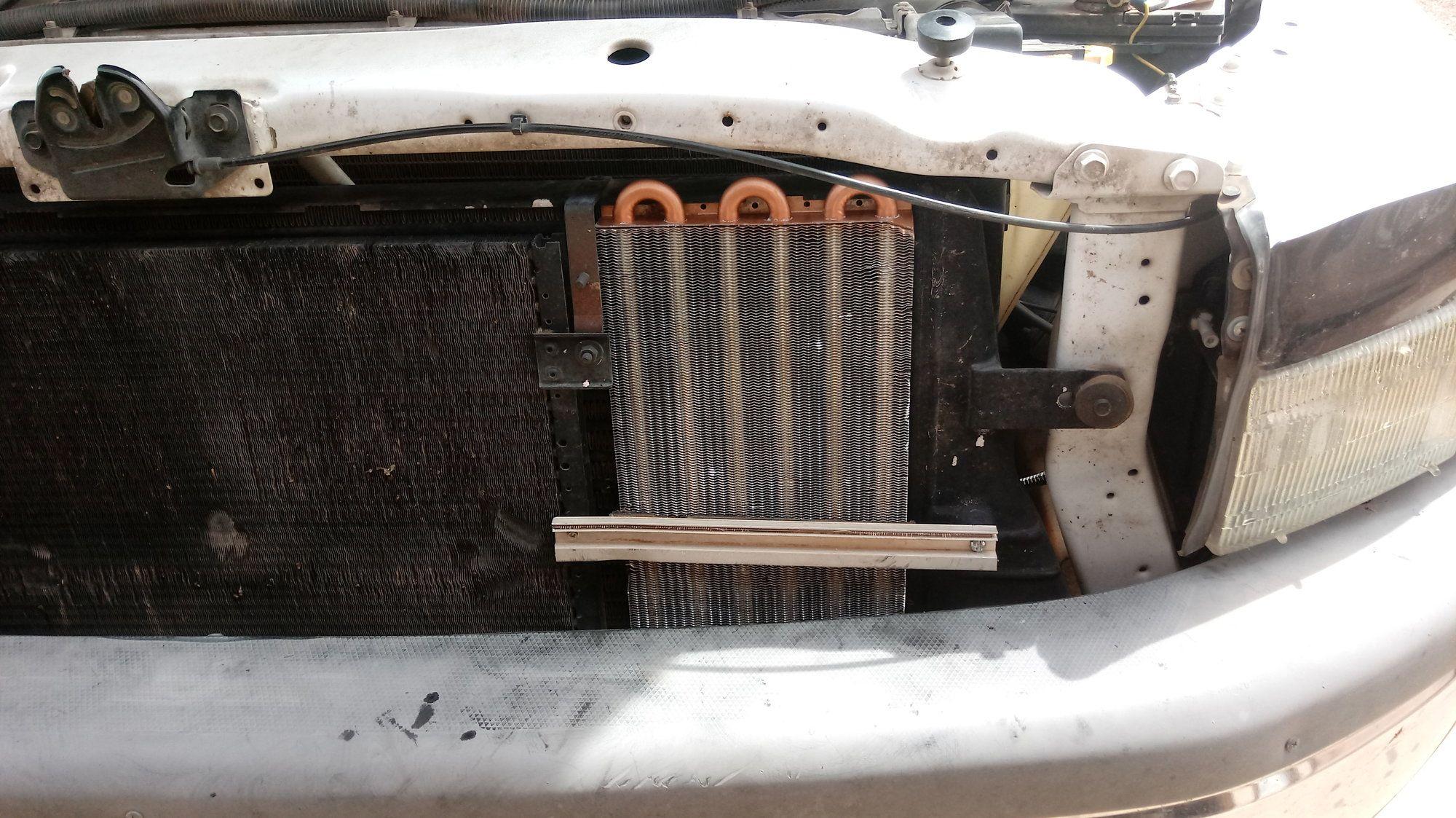

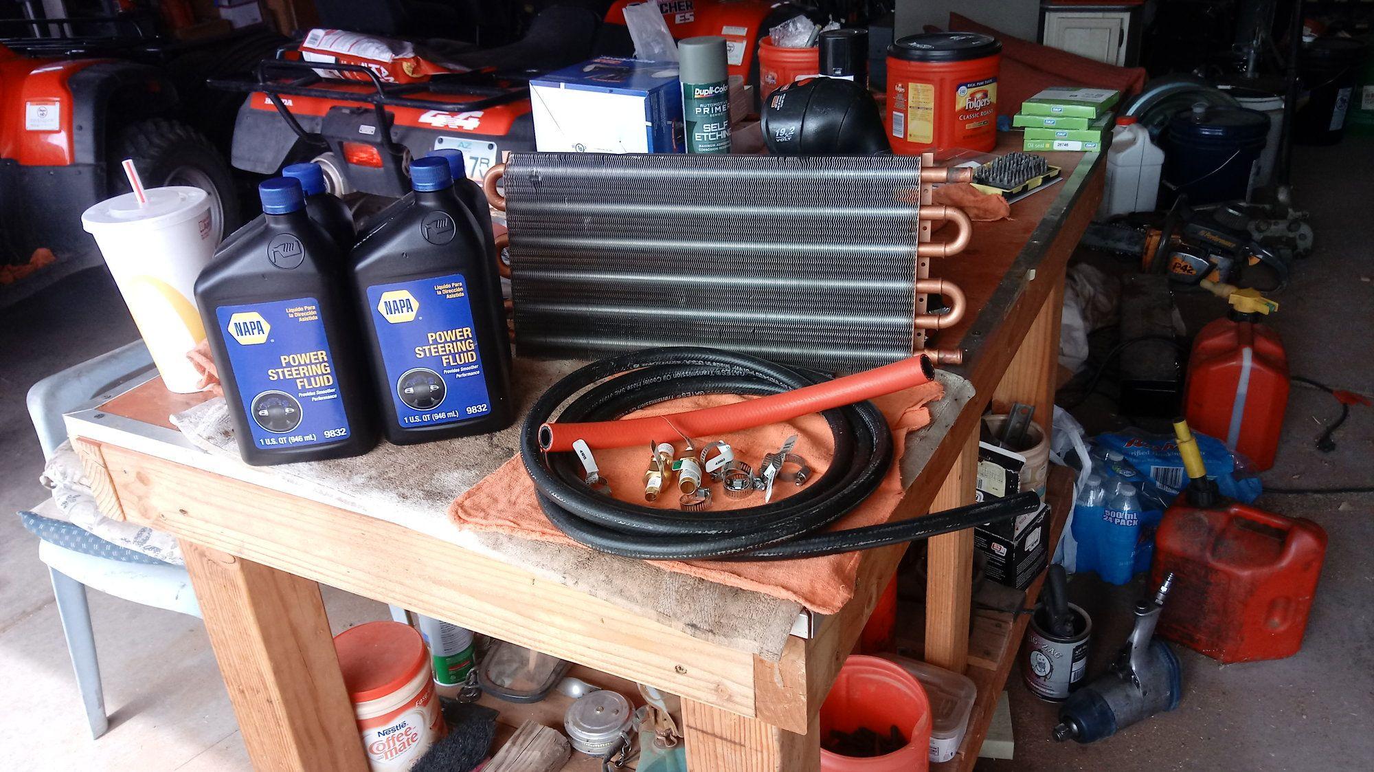

Just did an install of a power steering cooler, it is a little large but I had it new on the shelf. I bought it for my old Ford (auto transmission) and then bought a new Dodge instead, (1991) so it has been on the shelf a long time.
I also wanted to check return flow...on my truck, with the steering box return line pointed at my oil drain pan, I had my wife start the truck. The flow was massive and emptied the reservoir instantly. Granted, it only holds about a pint, but in about 2 seconds the fluid turned to foamy air. If I remember right, when I would change the fluid it only required a little less than a quart. The system now holds 1.250 quarts, a good thing. Here are a couple of pictures.
View attachment 108770 View attachment 108771
Nick: After you installed this cooler, did you have any problems with power steering fluid draining back into the system? Does fluid leak out the cap of the steering pump?
I ask this because in my stock-level truck, the cap of the power steering pump sits right at 36 inches from the ground. So I wonder if the valving inside the steering gear is sufficient to prevent gravity flow of fluid causing an overfill condition in the pump's reservoir.
