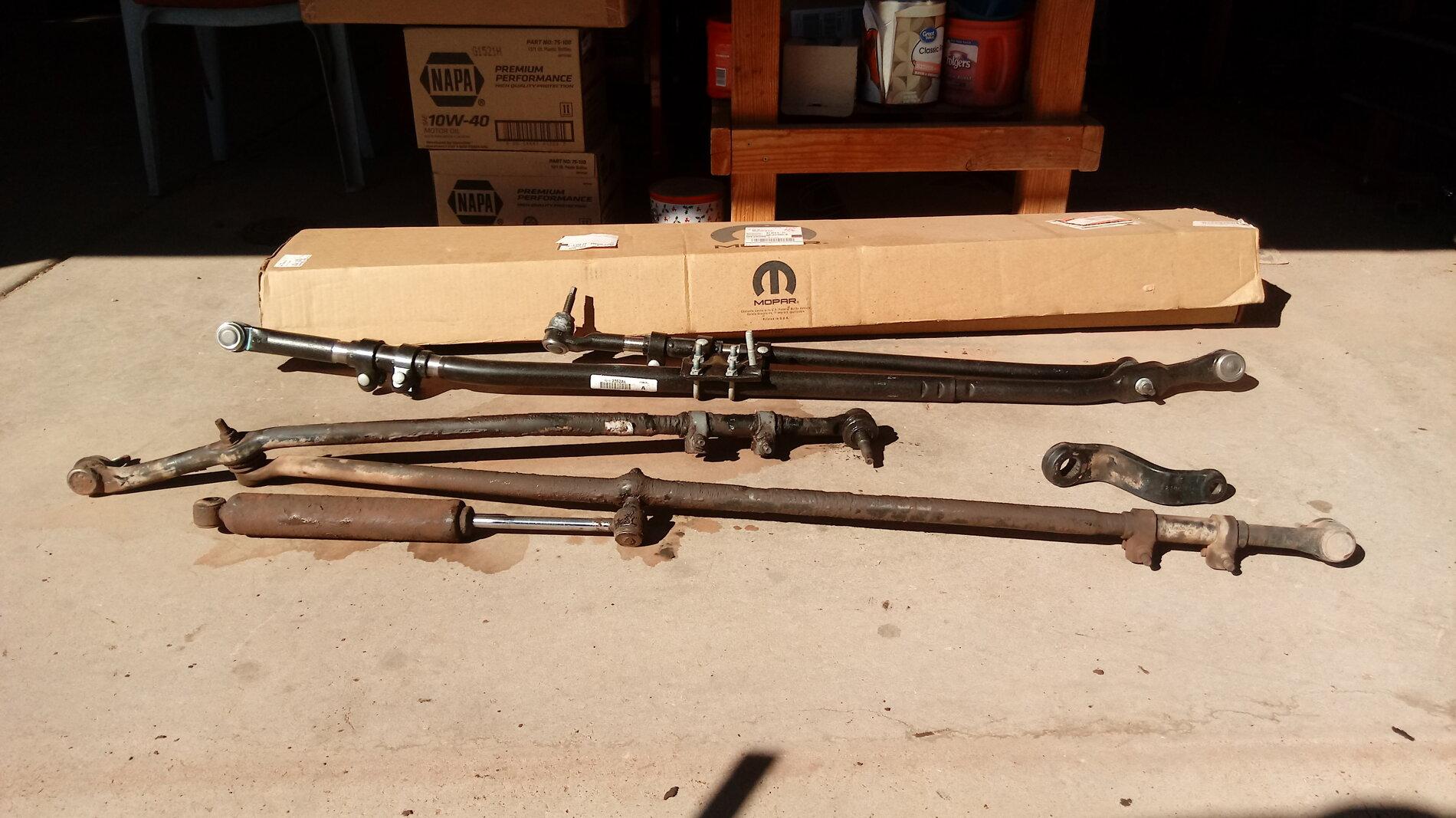

Installed the Mopar 52122362AL t-steering linkage kit on the '01. I have been reading about them for years and wasn't sure about the fit and drivability. I see articles both ways. After driving the new truck and getting into the old one, I couldn't keep it on the road:D I have always had to drive it, no sight seeing with it, but since the tires never wear, I hated to fix what wasn't broke.
It was a direct fit, no mods at all. I did have to get an '08-'12 steering stabilizer but it was a direct fit also. I do have a slightly cocked steering wheel but I am out of adjustment. I should have taken the tie rod off and ground a little off the threaded end, they touch each other at the clamp sleeve. If it bugs me, I can still do that.
After a quick drive to town to pickup the stabilizer, I should have done it sooner, nice!

The Dodge front steering components are confusing. I have read up on numerous articles on the subject and am still unsure.
The way I understand it, the '94-'97 (y style) are all the same (diesel). Some '98-'99 used the y style, same as the '94-'97, but some '98-'99 came with the HD t-style. Not sure if they will fit the '94-'97. The kit I used will not fit the '94-'99. There is a difference in the stud tapper on the knuckles. The kit should fit the '00-'02. Since mine is an '01 I didn't spend much time reading on the earlier trucks.
I am going to see if I can align the steering wheel by changing the steering shaft to gear box splined mount. I can't remember if it has a master spline. If it wasn't for the air bag, I would pull the steering wheel and align it there.
It is amazing but my tie rod joints are still tight, 365k miles.
Some info here, same kit as I used, fits '03-'12. It also fit my '01.

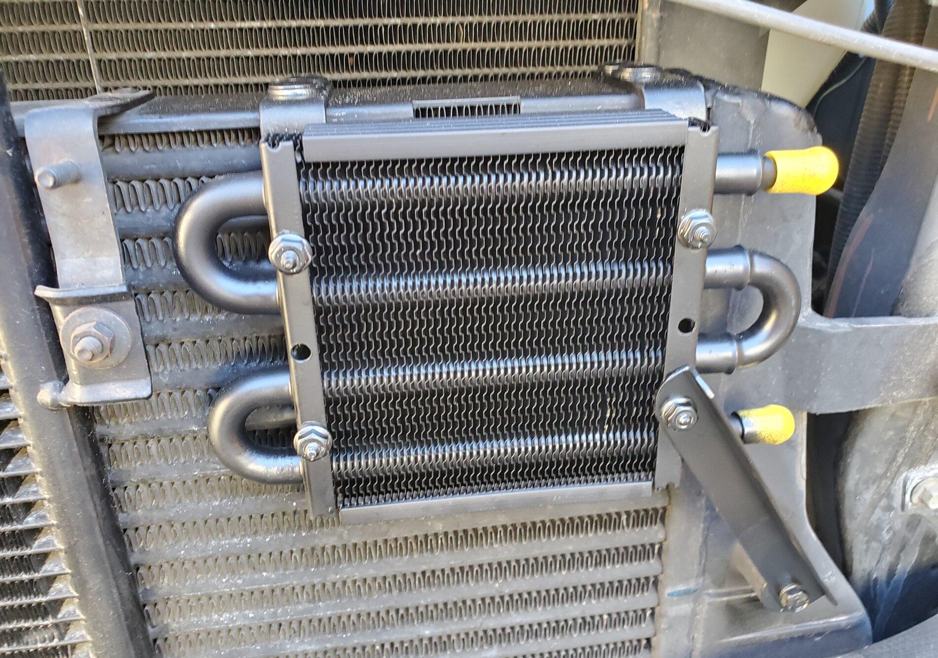

Just did an install of a power steering cooler, it is a little large but I had it new on the shelf. I bought it for my old Ford (auto transmission) and then bought a new Dodge instead, (1991) so it has been on the shelf a long time.
I also wanted to check return flow...on my truck, with the steering box return line pointed at my oil drain pan, I had my wife start the truck. The flow was massive and emptied the reservoir instantly. Granted, it only holds about a pint, but in about 2 seconds the fluid turned to foamy air. If I remember right, when I would change the fluid it only required a little less than a quart. The system now holds 1.250 quarts, a good thing. Here are a couple of pictures.
View attachment 108770 View attachment 108771
Well, I finally did the installation of a power steering cooler yesterday, 11/12/2021. I had asked you ("you" in this case being NIssacs) back in January of this year if the height of the cooler ever caused the fluid to overflow at the pump's reservoir. Encouraged with your reply that it didn't, I installed a much smaller Derale cooler that I had purchased 4 years ago as a replacement or add-on for our now-gone 2007 Town & Country minivan, but never installed. It's small but probably better than no cooler.
I will eventually do a complete writeup, but here's a picture of what it looks like in front before I ran the steel & rubber lines. Being smaller actually made it more difficult to install. So I ended up taking a cue from the way that the air conditioning condenser bracket is fitted to the intercooler. Short bits and rivets can be your friends.
In the 25 years since the truck emerged from the assembly line, I thought I had found all of the factory goofs and fixed them. I was wrong. The return line from the pump had been bent against the pump housing. It was simple to bend back out, but the OEM hose had burned and fully vulcanized to the exit tube. It took a wood chisel to remove all of the carbonized hose.
I also installed a filter. It looks like there's space between the intercooler and the frame, but there isn't. So I ended up placing it very near the intercooler-to-manifold pipe. With the extra circuits, the alarm stuff and the fuel filter relocation, that side of the engine bay is beginning to take on all the serviceability convenience of our PT Cruiser.
As expected, the pump lost its prime while I was refilling the system with Royal Purple steering fluid. I was using a steel Enfield funnel shoved into a rubber line, with the other end of the system into a slops pail. So it took a little more and some burping of the line to finish. There was a little overflow under the pump reservoir cap during the bleeding process, so we'll see what happens. The long road test is next.

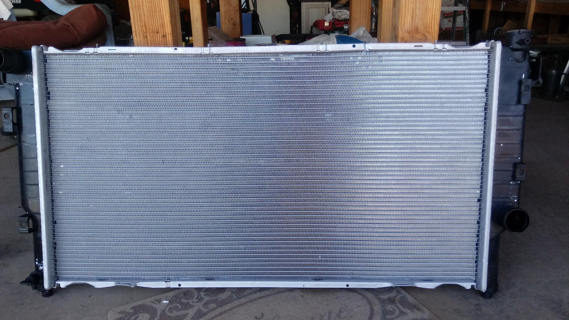

How has this new radiator worked out? what brand is it and where did you get it?
Thanks.
It has worked out well. As you know, I changed out several items in the cooling system, so I am not sure what did what. On a hot day with a load and a long hill it will still get hot, but it takes a while. I also have extra power over stock.
I bought mine from Autoplicity but I just checked and it is not in stock, Summit not in stock. I did find it at Rockauto, but the price has went up a bunch. #APDI 8011553.
https://www.rockauto.com/en/moreinfo.php?pk=2783196
The parts availability issue is a problem everywhere and for everything. A colleague in Wyoming needed to replace the radiator in her 2008. (Well, she wanted to replace it. I'm not certain it was really necessary.) She was completely unable to fine an all-aluminum radiator made by Mishimoto, or anyone else. I had to keep returning to the main issue: If the replacement radiator doesn't add fluid volume, it's not going to be much of an improvement if the old one ain't leakin'.
Eventually she found a vendor somewhere that specializes in Mercedes Benz performance parts that assured her that they had an AFE aluminum radiator in stock for her truck. The radiator is supposedly made in California. In theory, the part's in the mail. For a price, of course. In her phone call to me, where we worked out radiator options (including tossing a bucket of water on the radiator every 25 miles), she angrily said "Welcome to JB's America." You get to figure out the initials. :confused:
