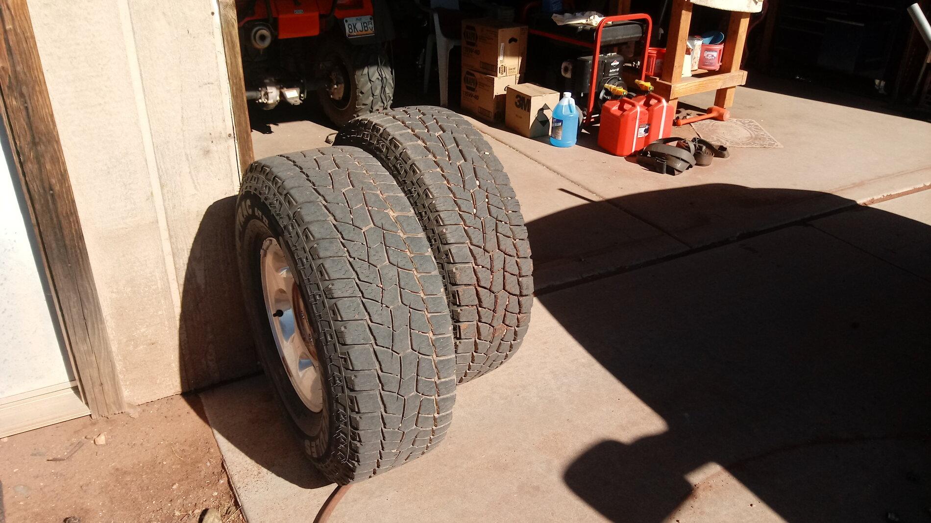

Rotated my new tires today, 9-weeks, 6469 miles and 4/32's tread gone already:( They look good tho for oem front end parts, 364K miles.

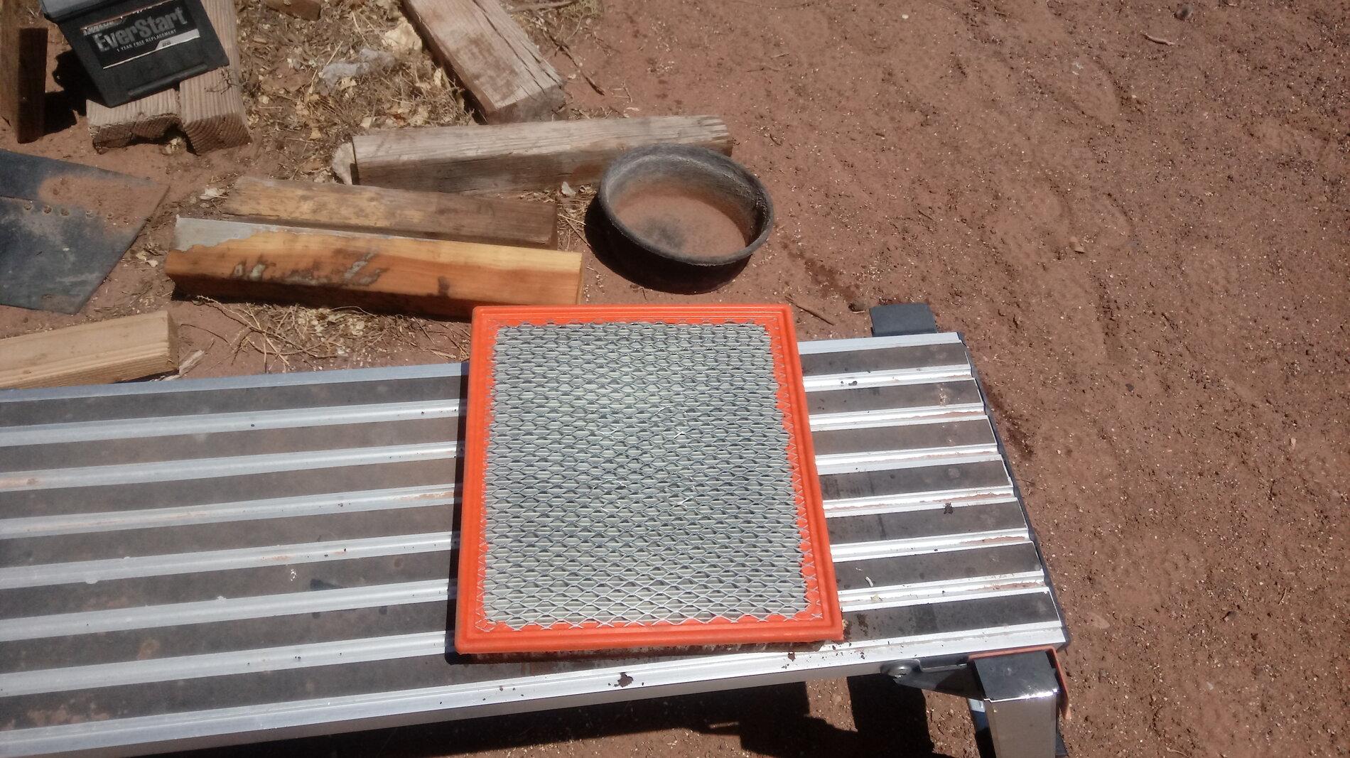

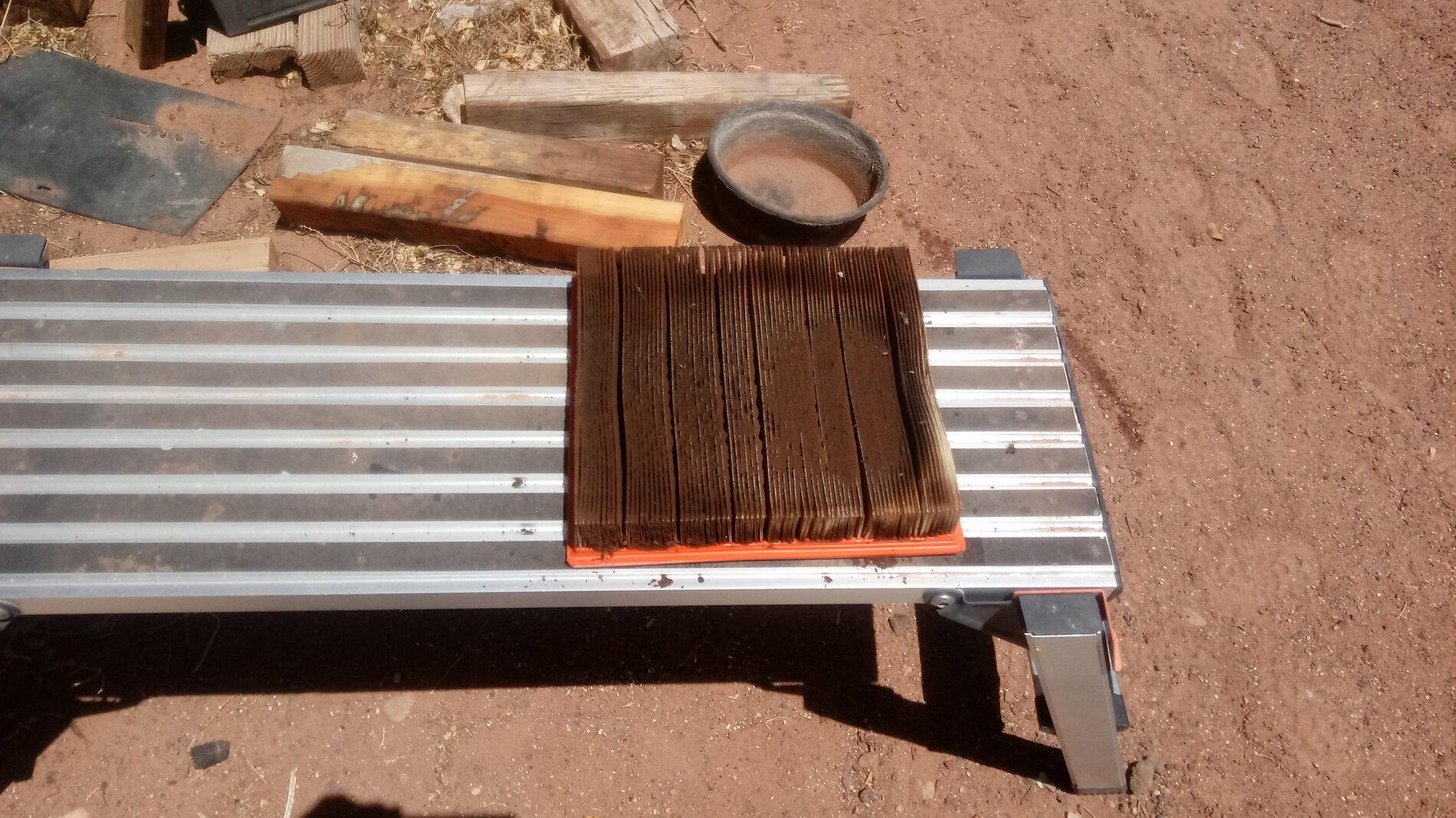

Installed my new filter today, fits good. It didn't help my turbo whine tho, same as before. This new turbo is quiet:( The exhaust brake rumble might be just a tad louder.
Looks like my oem was working good, compressor wheel is still shinny. It was due tho, 1 year and 24k miles of a lot of dirt roads.
  • Like
Reactions: JR
Dang, and here I was just feeling guilty about pushing my filter 3 years. From the looks of yours I could have run another 3 years :D
We don't get that kind of dust here, ever. It doesn't stop raining long enough o_O

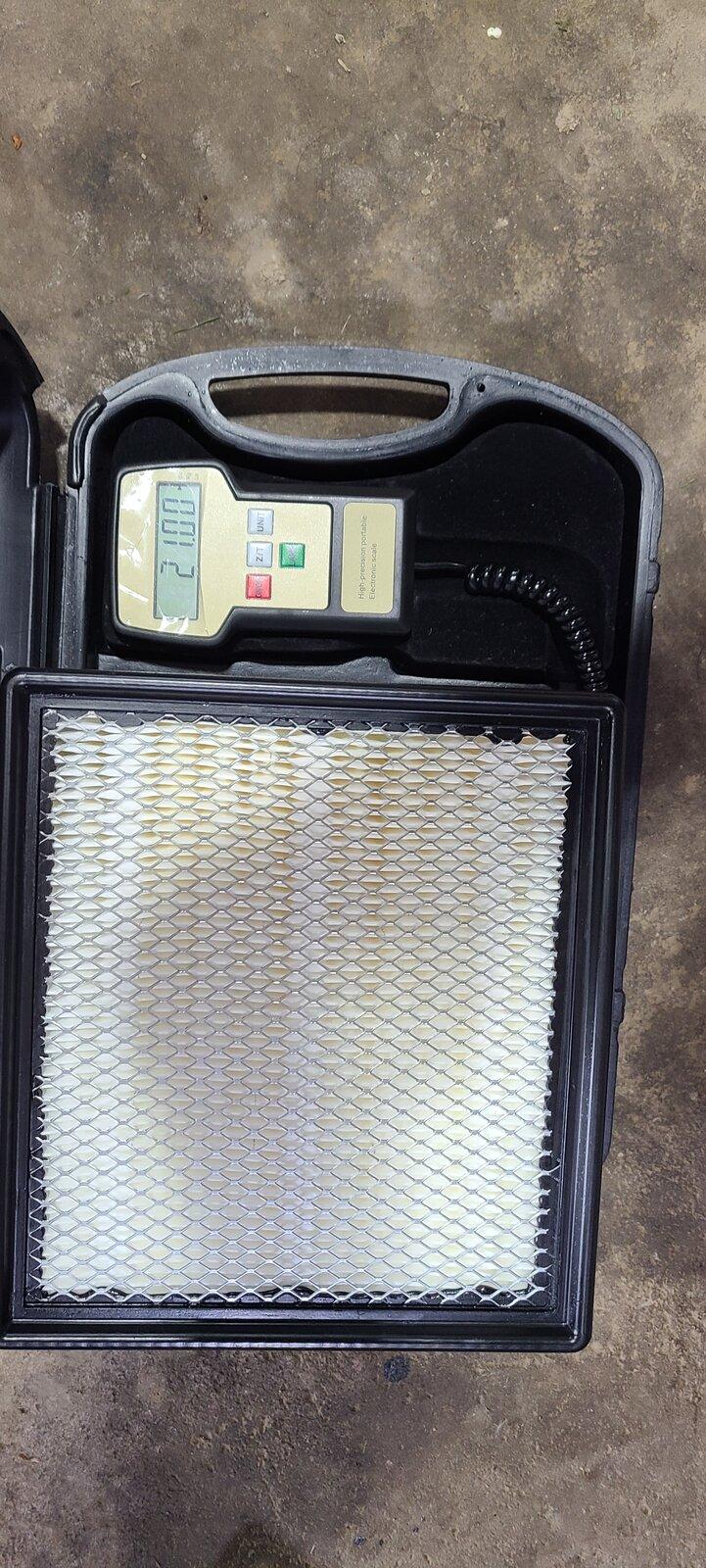

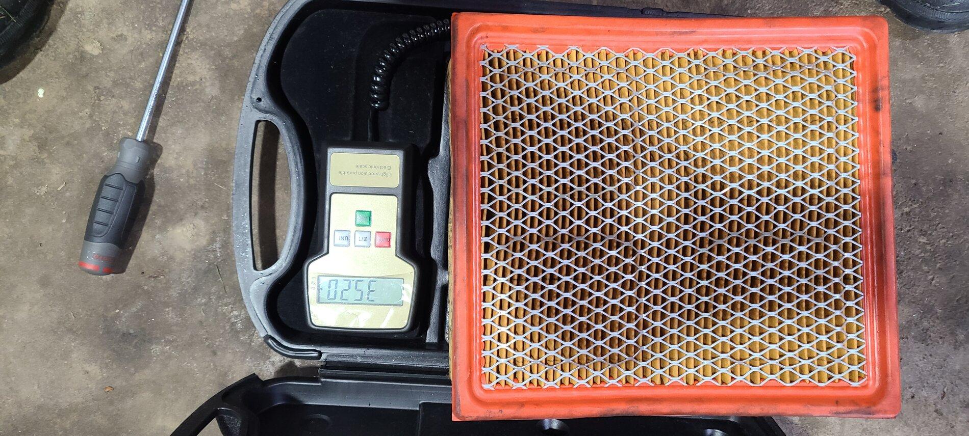

Notice the weight of each, in oz
Welp, that lasted quick. Down on boost and up on EGT's. What the heck? Bad filter? So, it went back in the box on the shelf for the dually and the '01 gets a new filter and old air box. I made sure the elbow was not restricted in any way, yet? Some times ya just gotta use oem:D
Who makes that filter? I never had those issues with my Donaldson.
Napa/Wix, I am at a loss. I have made that same haul with the same loads many times and never does the truck defuel. It is a tough pull from a stop but not to the point of defueling. I have it set for 1350 degrees, I was just getting a good start and the truck hit a brick wall, glanced over at my monitor and I was at 1350.
After that, I started watching my boost at max power and only 32psi, should be 36.
It would be interesting to see how much it pulls a filter minder down. I drilled a hole in the end of mine with a hole saw that was (I think) 1/8" smaller than the barb on the minder. The material on the end of the filter was almost spongy like and fit very snug.
I could never get that minder to move. It is odd that filter appears to be so restrictive. It looks like it has alot more surface area than the OEM.
On my 98 12V I tried an AMZ/OIL oval/conical dry filter. Power seemed down towing so I popped the hood and it was so restrictive it had caved in.
Probably filtered down to .005 microns but sure didn’t have any flow.
Going on the same haul with the same load today, I will watch my gauges real close and compare. Makes me mad when I spend good money on an upgrade and it is not:D

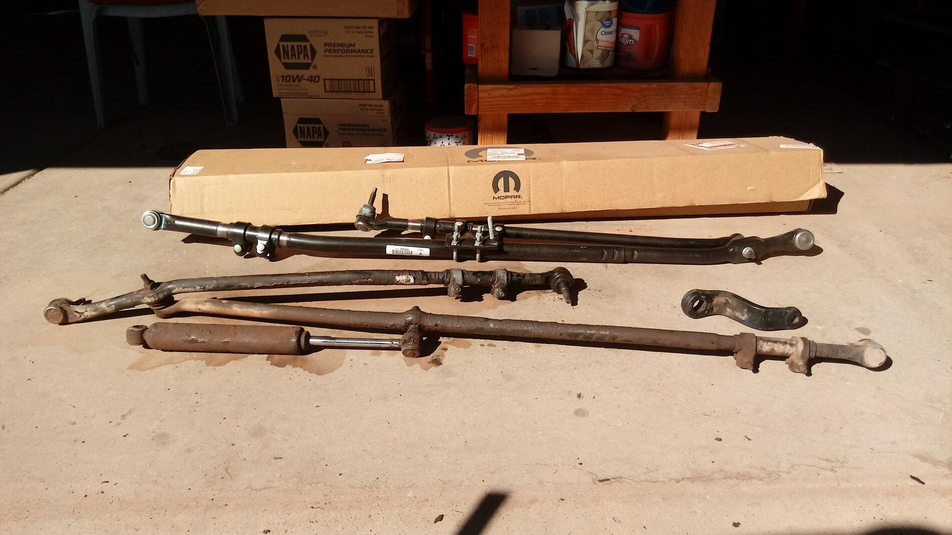

Installed the Mopar 52122362AL t-steering linkage kit on the '01. I have been reading about them for years and wasn't sure about the fit and drivability. I see articles both ways. After driving the new truck and getting into the old one, I couldn't keep it on the road:D I have always had to drive it, no sight seeing with it, but since the tires never wear, I hated to fix what wasn't broke.
It was a direct fit, no mods at all. I did have to get an '08-'12 steering stabilizer but it was a direct fit also. I do have a slightly cocked steering wheel but I am out of adjustment. I should have taken the tie rod off and ground a little off the threaded end, they touch each other at the clamp sleeve. If it bugs me, I can still do that.
After a quick drive to town to pickup the stabilizer, I should have done it sooner, nice!
