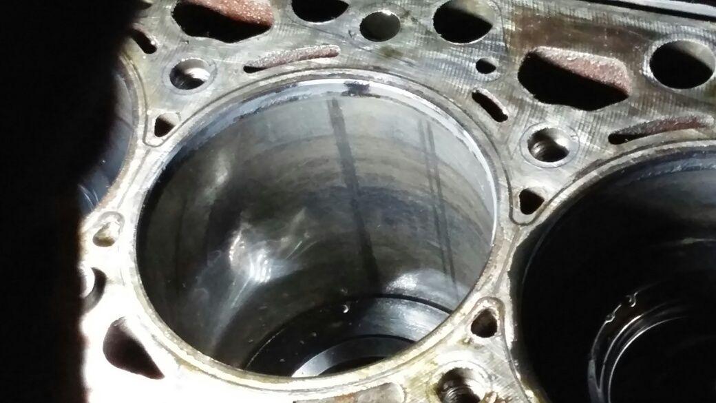

This is what I meant when saying that using remans is a crap shoot. This engine has less than 200k for all we know as it is a re-power when the original engine dies an untimely death from knocking a tip off an injector. #5 cylinder shown had an injector fail when we were just sorting out the truck after purchase. Failed bad enough it was hammering and chattering, took out the head gasket, etc. Both #5 and #4 showed bad on tests. Replaced #4 and #5 injector, #4 was stock injector, #5 was already a reman. The scoring was NOT there as of 6-7k ago when the HG and injectors were replaced. #6 went south during a 4k trip with a heavy load. #4 started drifting contribution percentage and was again replaced after about 4 months due to showing percentages in the 104-105% range on testing. #5, the second reman, is still showing solid contribution numbers BUT between #6 and #4 failing under load it took out the HG again even with ARP studs and a good Cummins MLS gasket. Head was checked and smoothed before first gasket.
BTW, this is a fully deleted 07 6.7. Common held belief is the 6.7 injectors are better but in reality that does not seem to be the case. Based on what I have seen with this engine, 4 injectors in less than 200k, 2 remans failing in a relatively short period of time, 1 reman in a 5k period, it is a fallacy the 6.7 injectors are much if any better than the 5.9 versions. Regardless, the results of a failed injector are the same in as much a broken rings are a high probability in either engine and a HG failure is almost a given in a 6.7 engine. Trend or random bad luck, your choice what the answer is.
Since the engine now MUST come out it will get new rings with gaps opened up to hopefully negate breakage, new bearings with a 1 piece thrust bearing, and a fire ringed head and special gasket. Since we do all our own work the cost will be mainly parts and machine work on the head, but, if one is hiring this done you can pretty much guess what the final bill will be for the same result we will achieve for about $2k. Balanced against the cost and the work we have done so far we likely could have replaced all injectors with a new set of .75 BBI's and been ahead of the game. Note this is a very high level comparison if, all things being equal, the factory HG held and there were no OTHER issues. Really hard to say because may other factors contribute. Needless to say, after this is fixed, the G56 is rebuilt because whomever did it did not pay real close attention to detail, and a HE451VE is swapped in place if the factory turbo, which we already fixed once for a weird failure, a set of BBI's will be front and center and done BEFORE any more towing trips.
