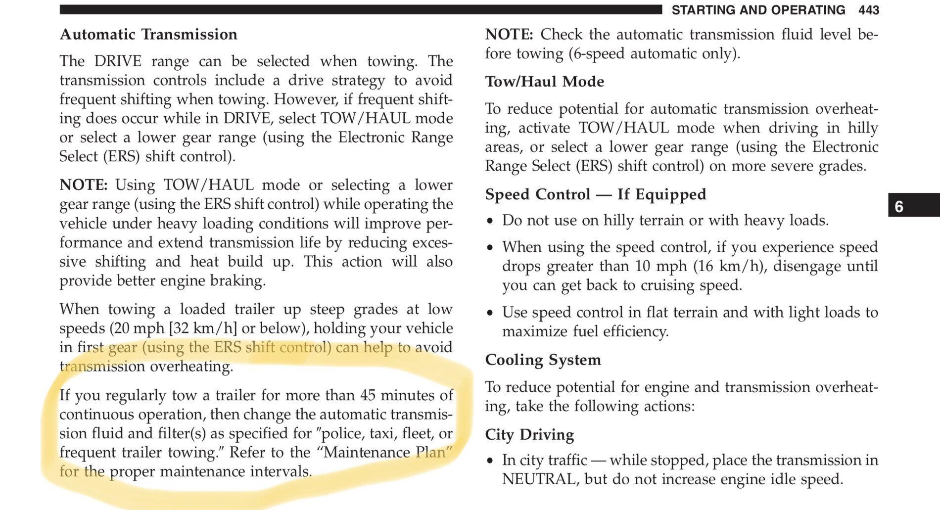

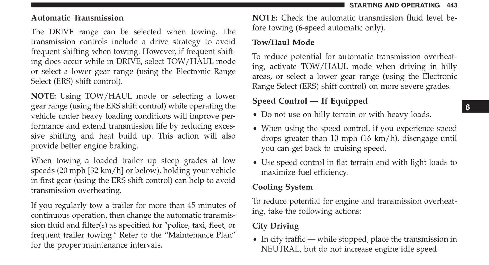

I also like the section under "COOLING". To reduce the potential for engine and transmission overheating, take the following actions:
In city traffic - while stopped, place the transmission in NEUTRAL. ???????? Really ???? I know there are aftermarket companies that make upgrades to the 68RFE (and others) to IMPROVE the cooling (saying its design has flaws that cause failure due to overheating) REMAX comes to mind with their Cooler Thermostatic Bypass Upgrade, Spin on filter steel screw (to replace the plastic one) and as a bunch have come up with deep (adding 3-4 qts ATF) machined pans with drain plugs and gaskets (what a concept). I know these guys are trying to sell products and their marketing is for us truck owners who care....to avoid a catastrophic (and expensive) failure of our transmission's. So the real question is this: Is it all really necessary?
They are saying neutral as opposed to leaving in Drive with your foot on the brake. When you leave it in gear with your foot on the brake, it keeps the torque converter 'slipping' which generates heat. Those aftermarket product will not change that.
Yeah...I understand what they are saying, not really concerned about the transmission overheating while sitting at a stop light. I just thought it was funny, FCA would put that in the manual. This whole thread has been about towing and transmission upgrades and maintenance.

Again, what happens when you come to a stop light with a manual trans, oh yea take it out of gear. I'll bet almost nobody puts their auto transmission in neutral at a traffic light unless sitting for several minutes, and then it's more about not having to hold the brake then anything. Heat is a result of fluid passing through the converter when in gear, take it out of gear and the fluid shearing (heat) stops. It's not a difficult concept, nor any reason to cry wolf o_O
