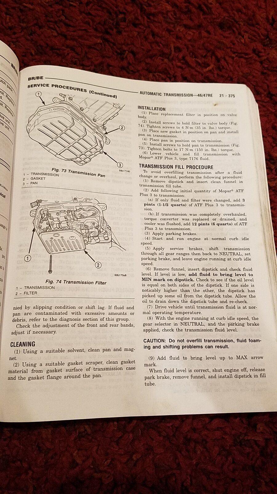

Still waiting on a black and white specifically saying just the pan.
It says change fluid. NOT part of it.
Here it is, from a 2000 FSM in the 46/47re section. Note this is an example where they are describing what transmission service is. They do not state "partial" or "all" the fluid, merely that this IS the recomended service.....and this service amounts to a partial fluid change.....the same for the very large majority of auto transmissions out there.

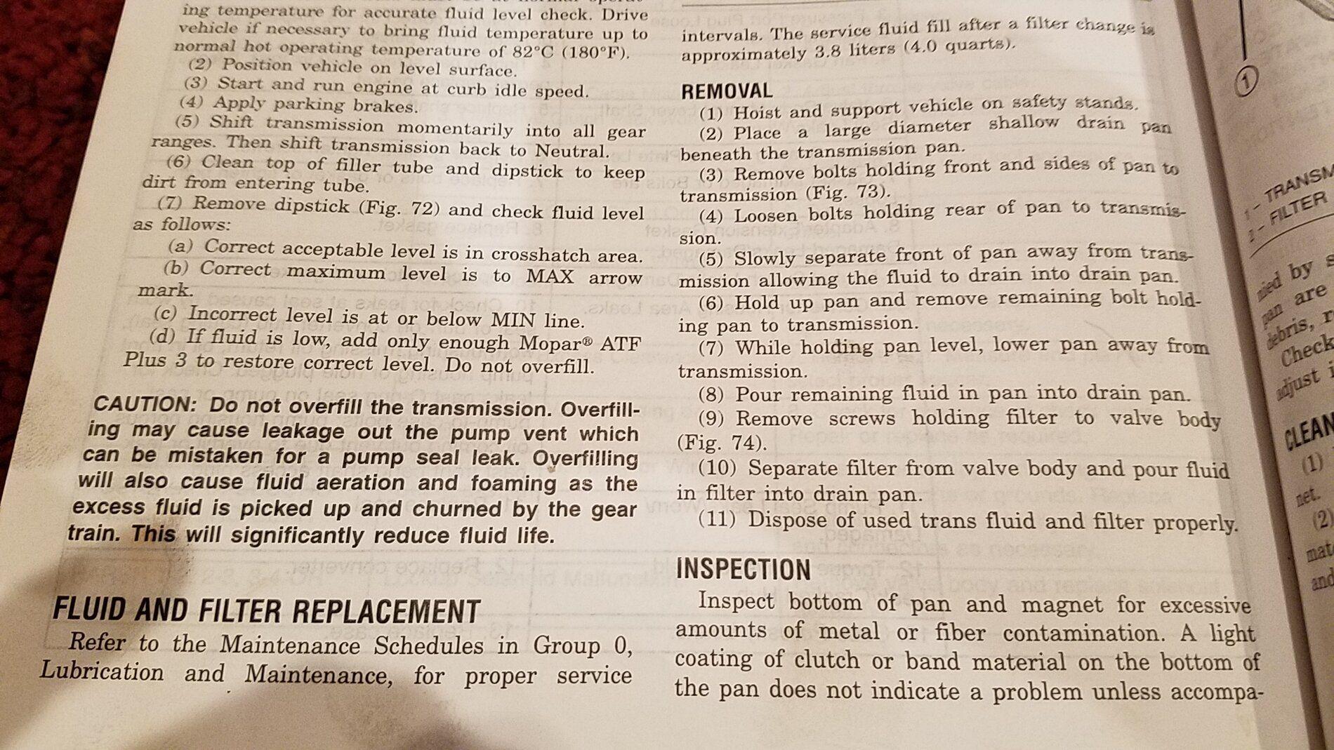

Note that this section is "Fluid and Filter Replacement" Also note the last sentence of the first paragraph....that this service usually amounts to 4qts of fluid being replaced (however my 2000 always ended up being around 7 qts.)
The process is:
-drop the pan/fluid
-remove and replace filter
-check/adjust bands
-reinstall pan
-add fluid
That's it. It's been this way for decades. If there is a transmission out there that is required to have ALL of its fluid replaced as part of normal service, it is the exception, not the rule. If you have reason to believe that it is any different for the 68rfe or the Aisin, the burden of proof is on you.
