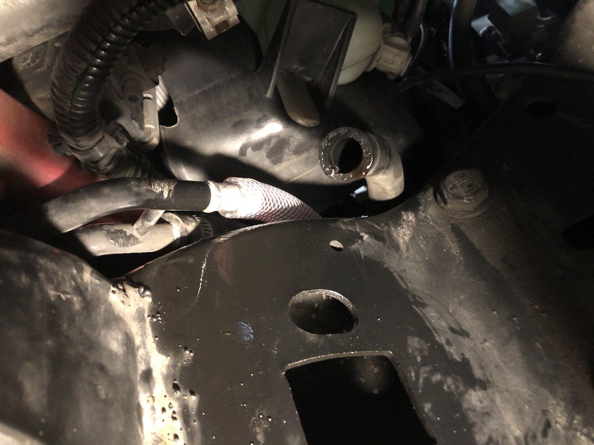

Just to make YOU "FEEL" better I did the exchange by my self this time. I dropped the pan, removed the filter and loosened the 9 valve body bolts. After a couple hours draining there was 10 quarts in the container.
Tightened valve body bolts to spec, adjusted inner band, installed the filter, installed the pan then added the 10 quarts of Signature series AMZ/OIL. Now the trans was FULL again.
Now I went to the front where the rubber lines attach to the trans cooler removed the hose from the filters outgoing side. Slipped on a 1/2" clear hose and placed it into empty container.
Started truck and when around 2qts had discharged I shut off truck. Measured the amount of fluid it was actually 3 quarts and added that much back, now "FULL" again. Started truck did the same and added another three quarts. The fluid coming out the hose was bright RED at that time. So 16 quarts and I have a 100% fresh fill trans with the OLD lube removed.
